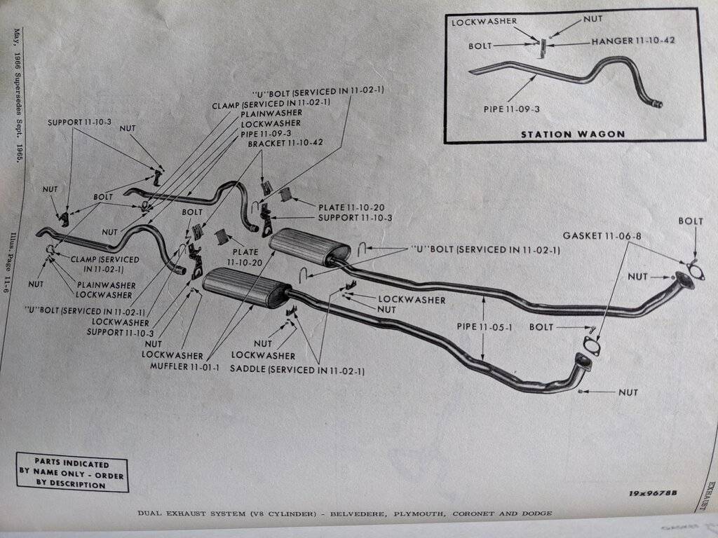

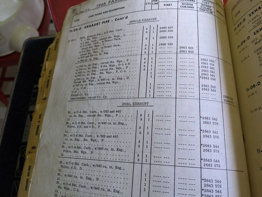

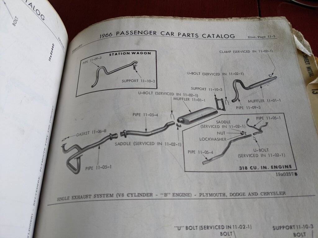

Forgot to include the parts book info.
I got mine a couple weeks ago and plan to install it tomorrow and probably Friday and Saturday too. I don't dare work in the peak of a heat wave day with temperatures at ~112F., so this job will go slow. All the pipe slips together well when checking it out, so I will see how well they bent it according to 1967 specs. I got the Parts catalog for that year as well as '66, and the system looks very close to what is in the book. I have some hangers and straps, again, obtained with conformity to 1966-67 in mind when I bought the stuff.

I didn’t mean to ignore your post here a couple days ago as I’ve been notified , it’s just that your 66 book shows dual exhaust seems to work for 440 cu and 383 cu in most cases but I’m still worried my 67 monaco 500 with 2 barrel carb and single exhaust will not be able accept that nice dual exhaust?? Any more ideas ok this I would appreciate
The parts book picture is "Representative" in nature, but very accurate in depicting what it does. The PARTS listings will DEFINE things for the particular Dodge (122"wb) sedans and wagons as the CHRYSLER non-SW numbers will define things for the Chrysler's 124" wb.
TTI might sell a general C-body system in their catalog and THEN customize it for your particular exhaust manifolds and then you might shorten the intermediate pipe for the various wheelbases (119" Plymouth, 122" Dodge and C-body wagons, 124" Chrysler) when the system is installed. Having not dealt with them yet, I suspect that's how it might work out.
Whereas the OEM parts book part numbers would be specific for the brand/particular C-body vehicle. As would the Walker Exhaust pipe listings. AND the parts book listings would be accurate for whatever exhaust manifolds came on that year's vehicle. Which is why, in a more generic listing as TTI and others might have, they need to know the exhaust manifold casting numbers so they can get the head pipe flanges the correct size and clocked the correct direction. BTAIM

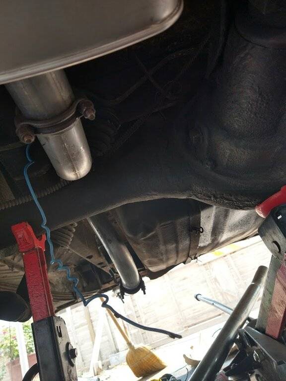

Job went mostly easy, but there is ONE problem pipe, which makes things a but ugly on the driver side. The worst thing about this job was crawling around under the car in 110 F heat and 3 years of dust in my driveway carpet. I have pics of the work 3/4s done for now.
The driver side pipe runs too close to the drive shaft for my liking. Note how nicely the passenger side pipe lays in the contours of the underside. I may have to cut an inch or 1.5" out of that kick on the driver side and use a coupler to hold things tight after.
Note how straight the pipe over the rear axle runs from the muffler to the tailpipe and rear bumper. That bit of extra length on the driver side screwed it up there. I WILL post pics of things again in a few days. I AM driving Mathilda right now, and OH HOW QUIET SHE IS NOW! I need a month before I crawl under that car again, and preferably several until the temperature drops. THEN I can attack any remaining aesthetic problem in the bends on the driver side. Having NEVER done exhaust work aside from patching a leak in the old Y pipe and securely hanging the rest of that decades old rusty stuff, I'm happy with the fact that no CO is escaping under the car and poisoning my family.
The factory's design, at least as interpreted by Maremont when they made all these pipes, also comes real close to the driveshaft on the one side but I've never had it hit.
