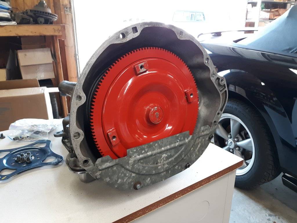

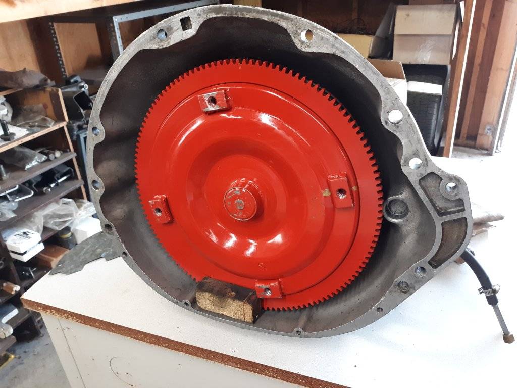

Big block bell housing looks circular. You need a big block trans for that 383 V8 Newport
Small block looks flat on passenger side. Also torque converter cover bolts location and starter location are different on small and big block bell housings

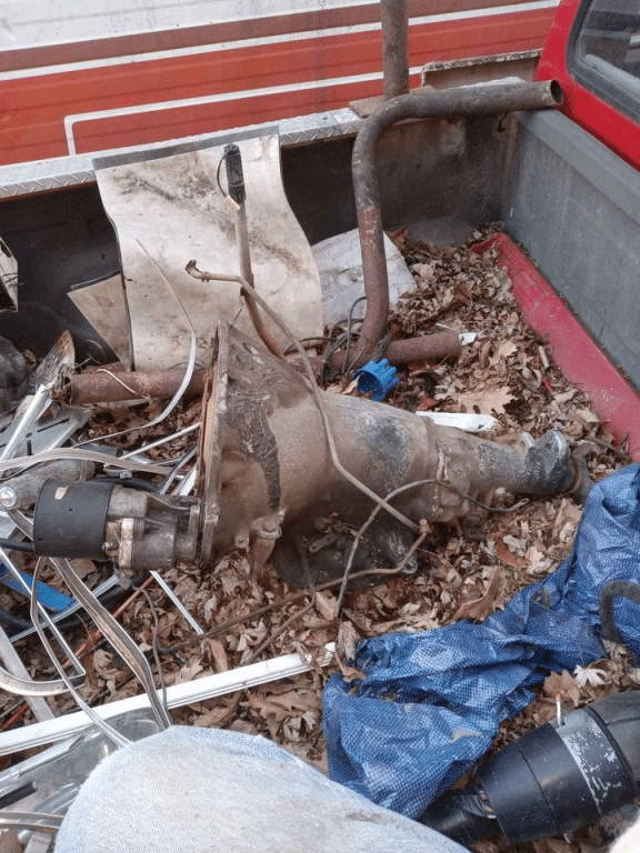

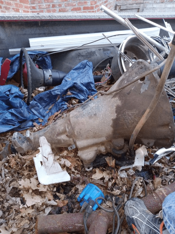

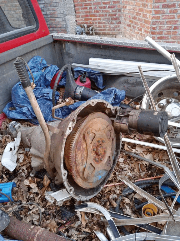

I suggest that you take pictures of the RV trans - front, rear, and sides - and post them to this thread.
We can help you with whether it needs mods. Ben
Not seeing any pics I can only guess.
Small black and big block have different bellhousing bolt patterns.
The majority of RV 727 that I had seen had short talistocks with 2 pice drive shafts and hanger bearing and cable shifted .
Which requires significant parts swapping to fit in a C body which may not be feasible.
