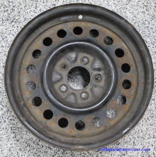

Dec 14, 2014 #1 Mr onetwo Well-Known Member FCBO Gold Member Joined Jan 8, 2014 Messages 946 Reaction score 875 Location Belfast,ME I have searched and find no references to these wheels.....16X7, 5 LUG, 4-1/2", 96-97, DODGE, CHRYSLER, LHS, CONCORD, INTREPID, NEW YORKER, STEEL 18 HOLE.....Could these work on my 68 Newport vert?

Dec 14, 2014 #2 Big_John Illegitimi non carborundum FCBO Gold Member Joined May 21, 2013 Messages 20,655 Reaction score 30,584 Location Marcellus, NY No. Offset is for a front drive and then there's the metric bolt circle.
Dec 14, 2014 #3 300rag It's Not Going to Shift Itself Joined Dec 4, 2010 Messages 14,197 Reaction score 24,233 Location Calgary, Alberta, Canada They may bolt on, but the offset is incorrect. They are FWD wheels. Edit - *You beat me, Big_John*
Dec 14, 2014 #4 Mr onetwo Well-Known Member FCBO Gold Member Joined Jan 8, 2014 Messages 946 Reaction score 875 Location Belfast,ME Thanks guys!!!!!
Dec 14, 2014 #5 patrick66 Old Man with a Hat Joined Jul 4, 2012 Messages 6,699 Reaction score 5,350 Location Central Oklahoma They do NOT "bolt on" as they have the 115mm bolt pattern. Your Newport is a 4-1/2" (114.3mm) BP. NOT THE SAME.
