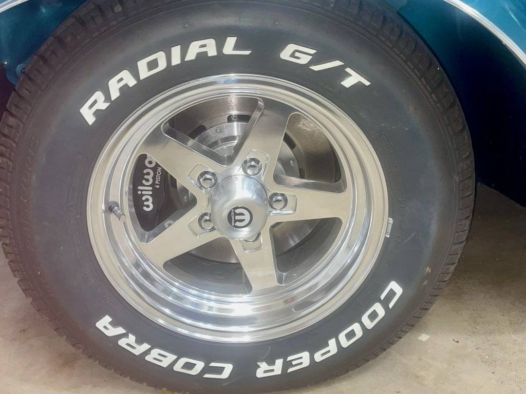

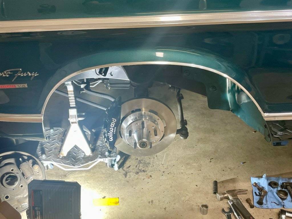

I put them all the way around and they work out amazing. I installed a leed brakes booster/master cylinder/proportioning valve setup for that portion(before anyone gives me crap, its working out amazing and has been on for 2 yrs now). I've installed multiple wilwood kits on my cars and have zero complaints about any of them. The front kit is a very straight forward and easy install but you will have to bend, flare, and route some of your own brake lines PM me if you get the kit and I will go over what I did and send pics. If you decide to go all 4 definitely PM me because the rear is much more tricky and mechanically complicated but I can give tips that will save headaches I went through. Definitely better quality than the other cheaper disc conversion kits but at a slightly higher cost.

Thank you! That’s the kind of info I needed! That looks like a beautiful fury by the way. Would love to see a pic of the whole thing!
