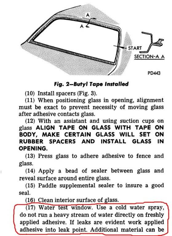

First read the factory service manual for your car line in the glass replacement section. There are also instructions for new type car windshields which are similar.
Basically it is remove all trim pieces (and clips if you want too) spray with water from a hose and identify your leaks, then use 3M™ Fast Cure Auto Glass Urethane is a one-part, moisture-curing, auto glass urethane that produces an extremely fast-cure.
Similar product picture from Year One:
As per instructions via 3M & the FSM the "moisture-curing" is the key component here as you lightly spray a fine mist around the channel to find leaks. If any are found use a popsicle stick to move the sealer around until you have no leaks. The moisture-curing part of the 3M product involves this fine mist spraying of water for the final leak test and starts the curing of the sealer.
If that doesn't solve your area leak, R & R the whole windshield and do it right as on many old cars they most likely have had the windshield replaced by some sloppy shortcutting flat rate glass jockey.

Here is why doing it the FSM way with the Butyl tape is important, to get the glass to sit correctly and the trim to fit in correctly and be able to have enough space in the channel for water to drain and dry out. Adhesive applied to thick (I know they got different size tips) will make the trim hard to snap in. Plus to much adhesive/sealant clogging up the channel may trap water and not allowing it to drain properly and may lead to rusting issues. The Butyl tape (get the correct size/thickness) is just to set the glass at the proper height so the glass sits just right for trim fitting, the water curing sealer is to be just applied along the edge of the glass and Butyl tape not fill the channel. Here more is not good, apply just what you need to seal leaks via the water test.

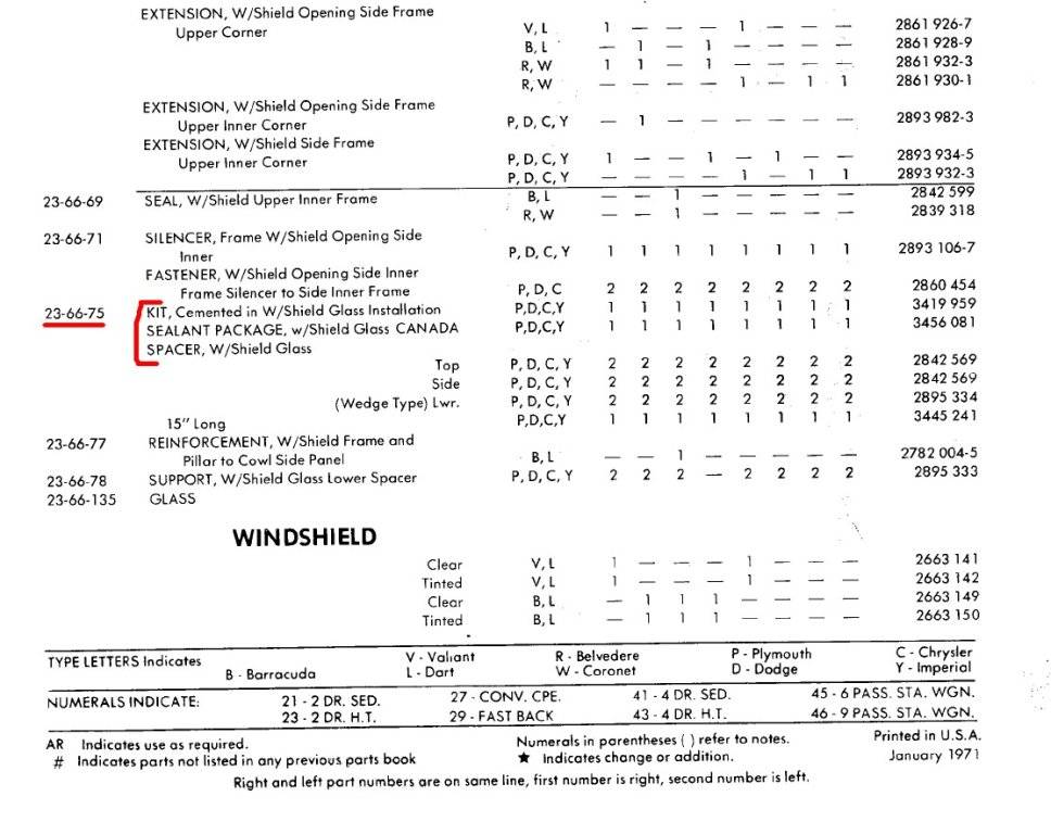

"use only the recommended adhesive sealer kit or its equivalent"
Since I really doubt that you will find this kit part number at the Mopar dealers today, but who knows you may want to call around and give them a try. I see your in the Netherlands, oh boy rots'a ruck on the NAPA parts supplier.

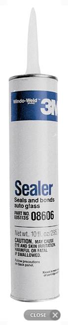

See if you can find that 3M Window Weld sealer at your local chemical suppliers or body shop suppliers. If all else fail you can order from Year One I'm sure they ship worldwide.
Don't let anyone else steer you too anything else (latest wonder goo) I'm sure today there are many that will.

The product I posted up does not need any special cleaning or surface prep...just clean out any old loose, cracking sealant then squeeze in the new sealant...done! Use a damp finger to clean up the excess and flow into nooks and crannies.
I drive my truck year round in the cold north and this stuff has worked great with no failures for my backyard re-seal jobs.
