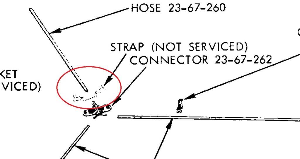

Anyone have a good pic of the strap?? The parts book shows it, but also says "not serviced". I'll bet I can 3D print one but I'd like to see an original.
A pic of hose routing up to the hood would be great too.
The parts book illustration:

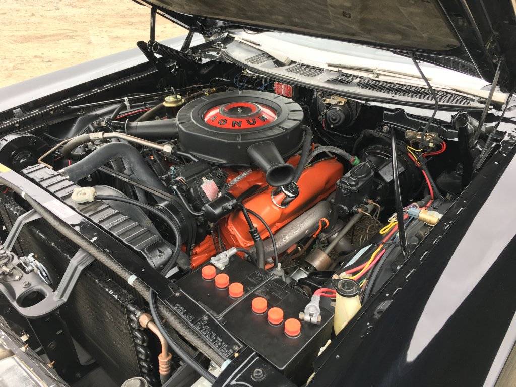

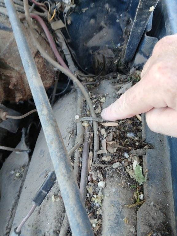

I could never find a source showing the "proper" routing, I think it might go behind the starter relay but not sure why I didn't, there is also that notch in the cowl panel a few inches over that may have been put there for it as well, again don't recall if I explored either of those, I'd say keep it short not long.

I looked at a few online and a lot looked like they could easily catch in the hinge. This looks much better.

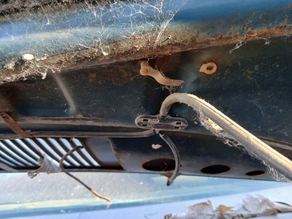

OK, I thought I had one of those wire harness straps kicking around, but I couldn't find it. I decided to fish a zip-tie through the holes just to get it done. You can't really see it, so it may stay.
I also looked at the notch behind the starter relay and decided it was a perfect place to run the line.

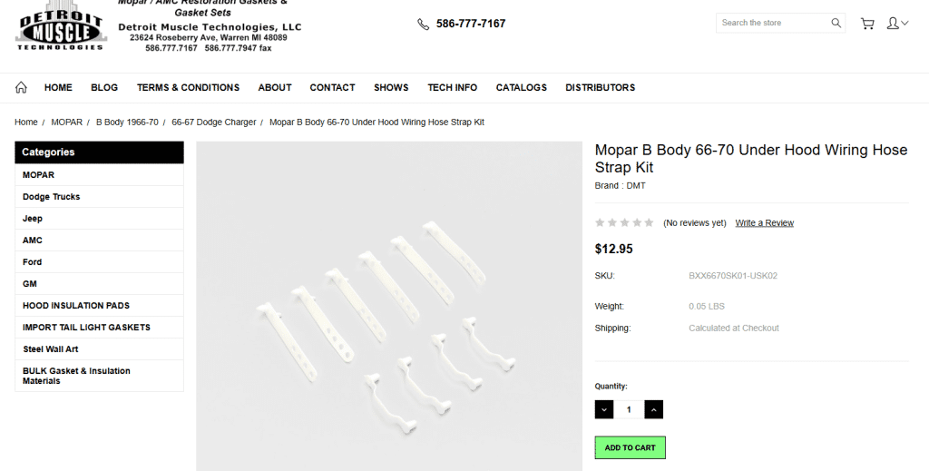

Hey Big_John Bill Rolick has that clip listed in group 8 page 4 of his catalog part # 2356 if I remember correctly five bucks, it's not listed for C body but it's the same.

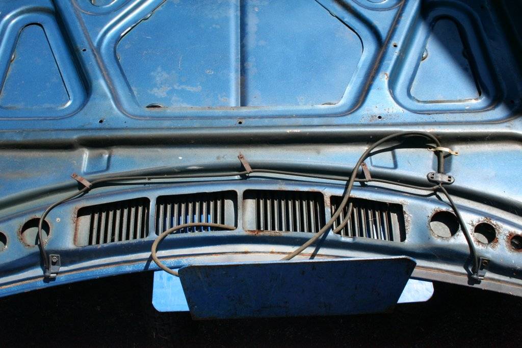

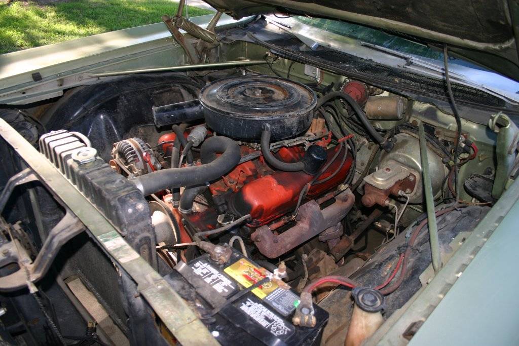

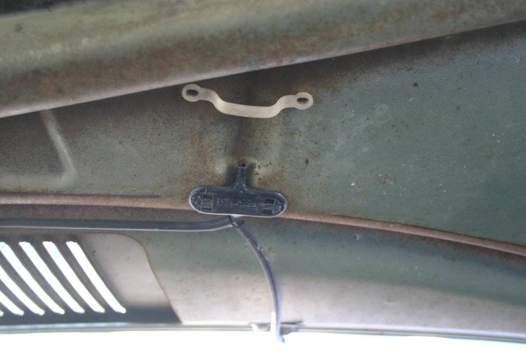

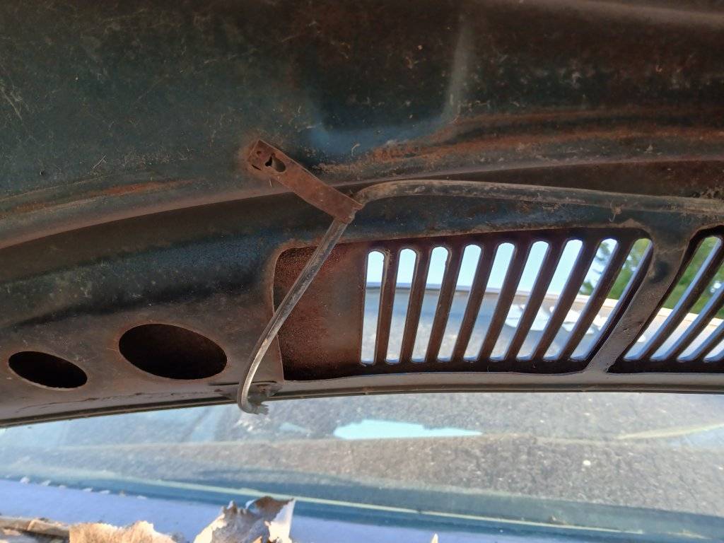

Howdy I just looked at my former car 70 300. This one ran the hose along the inner fender than to the hood with a plastic guide on the drivers side, then three metal guides over to the passenger side. Here are some pics.
That's funny black plastic on inner fender white on hood. I can't access my 70 Newport Vert to check as it is serving as a work bench for my Charger.

You could have at least used a clear colored zip tie to look closer to the "oem" part.... haha. :poke:
