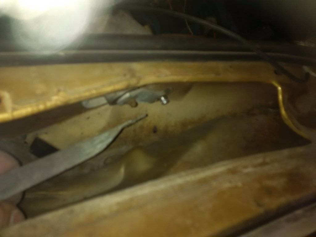

Anyone know the best source/part#/actual name for the small, nylon wiper motor bushing used in 1976? (pic below). I found them on Autozone, but a lot of Dorman parts are low-grade... thought maybe there was a better repop.

I think I recall the Dorman ones I used years ago as subpar compared to the "feel" of OEM. I'm also trying to make sure I get the motor bushing, not the smaller wiper linkage.
However, you're probably right about one manufacturer.
