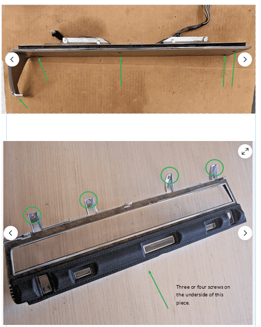

That depends on what you are calling the dash. You need to remove the upper part with the warning lights in it and instrument cluster bezel.
Do i need tp remove the top of the "dash" that is above the warning lightscluster? I have tried to remove that but i cant seem to find where screws or clips is
