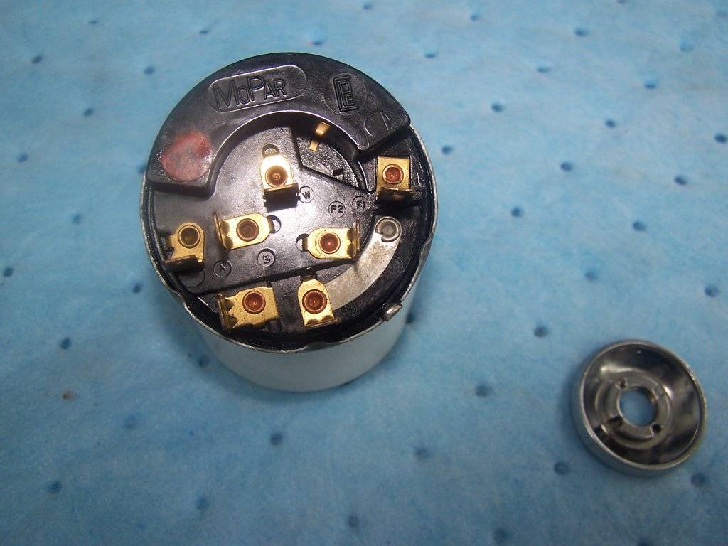

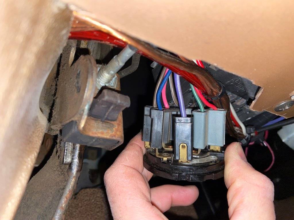

I have a 1966 Chrysler Town and Country and I need help finding a wiper switch. I have seen that they offer a single speed and multi speed switch. How can I tell what I have?

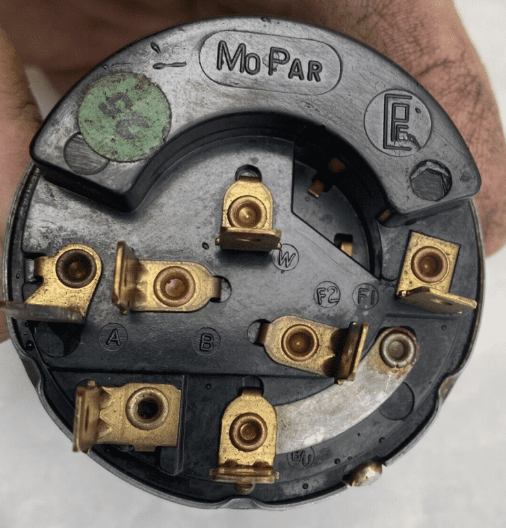

I have attached a picture of the back of the switch if that helps to identify.

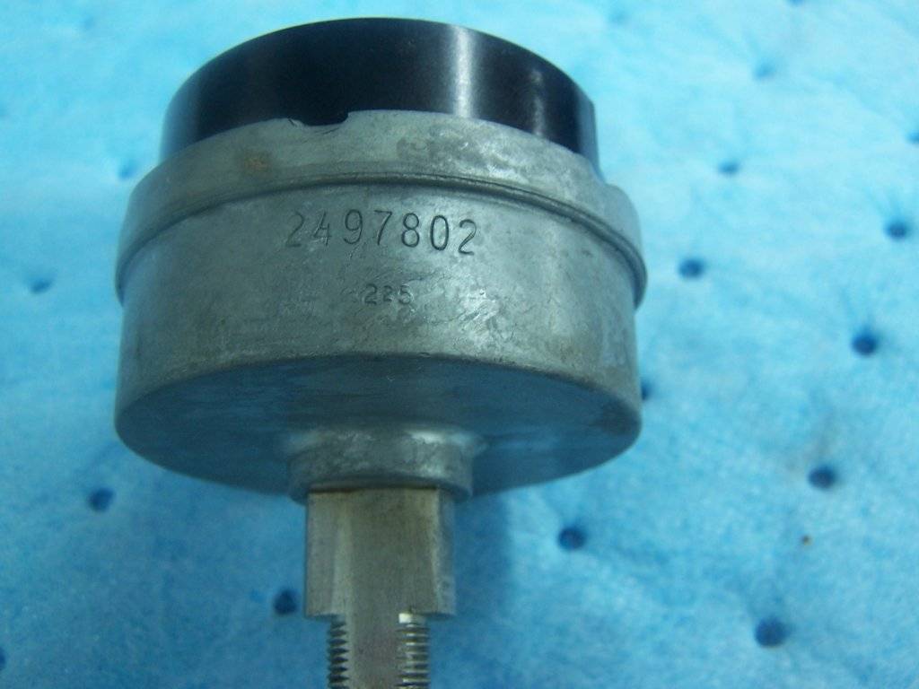

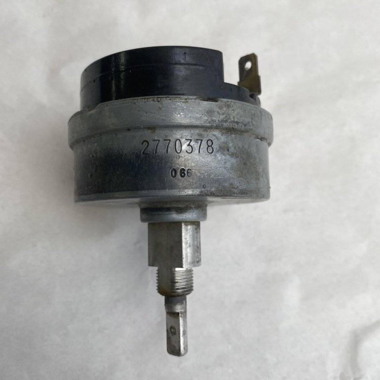

It should have a part number on it. Appears to be a variable speed though by the looks of it. I have a variable speed switch from a 66 Newport but the housing looks different than yours. Mine is PN: 2497802
It would appear to in fact be the variable speed switch. 2770380 was the only switch for C in 1966.
I can rebuild yours, or the one from @Sixpactogo above will work
Thanks everyone for the help! I will need to purchase a NOS or used one. A while back mine decided to break in half and I cannot remember where I put all the parts that fell out.
