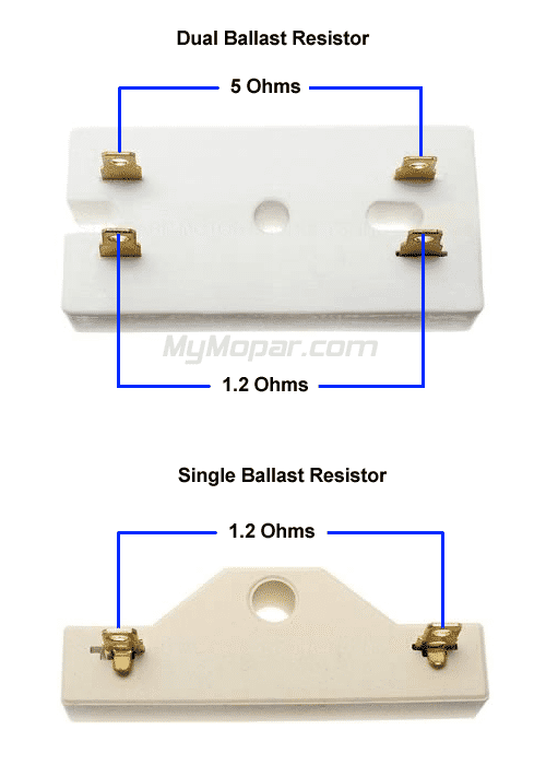

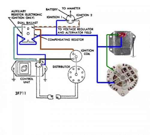

I've been having trouble getting my Chrysler to stay in the "run position" it starts just fine but when I release the key from "start" to "run" it stalls; I've figured out it defiantly has something to do with the blue wire in on the ballast resistor, but I've already replaced and soldered the lose prong, but it still won't stay running. Any suggestions are greatly appreciated.
