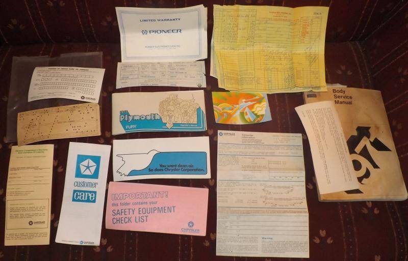

Okay a b it of an update, I had a look in the glove box and found a pile of interesting items, check the pics to see. Also, I took a pic of the fendertag too. I also found the original broadcast sheet in the back of the seat, as yet to be removed. I want to find a plastic slip for it first.
I also had a chat to the former owner today too and he said that he will dig through and find nay other paperwork on th car and send it to me, :) He also informed me that the engine has already had the heads done and has a new oil pump fitted, I also found a gasket kit in the back too. More good stuff!

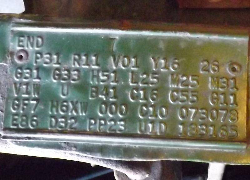

Fendertag decode, best I could do,
P31 69-71 Power Windows
R11 69-71 AM Radio (2 Watts)
V01 69-71 Mono Tone Paint Treatment
Y16 69-71 Sales Bank
G31 69-71 OS RH Manual Standard Mirror
G33 69 OS LH Remote Standard Mirror
H51 69-71 Air Conditioning
L25 69-71 Trunk Lamp
M25 69-71 Wide sill moldings
M31 71 only Belt and Hood Moldings
V1W 69-71 Full Vinyl Top White
U
B41 69-71 Front Disc Brakes w/Standard 10" RR Drum
C16 69-71 Console w/Woodgrain Panel
C55 69-71 Bucket Seats
G11 69-71 Tinted Glass (all)
GF7
H6XW
sem saddle soap will clean them door panels right up then l would hit them up with sem vynal dye.....keep them pics comeing...good score on the paperwork
26..... 26 inch radiator
I didn't take a pic, but I found the harmonic balance has a counterweight to it, this thing has six pack rods in it.
71 gts have all the makeings includeing rods....your U
correction.....
U: USA Specifications
H6XW : Trim - High, Vinyl Bucket Seats, Black/White
GF7: Exterior Color

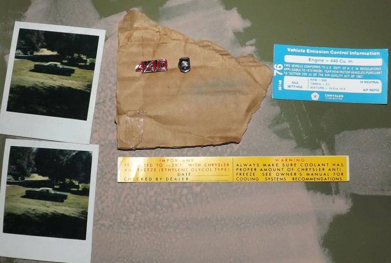

Okay a bit of an update, I found a small paper bag sealed in the center console, I originally thought it was empty since it had no weight in it, imagine my surprise in finding these things. GT badge and 440 badge and radiator cowl decals.

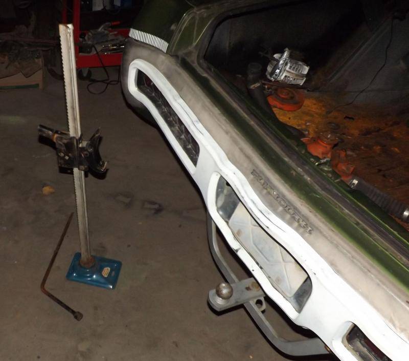

Plus the second pic shows the Jack, two different colors but appears to be correct?

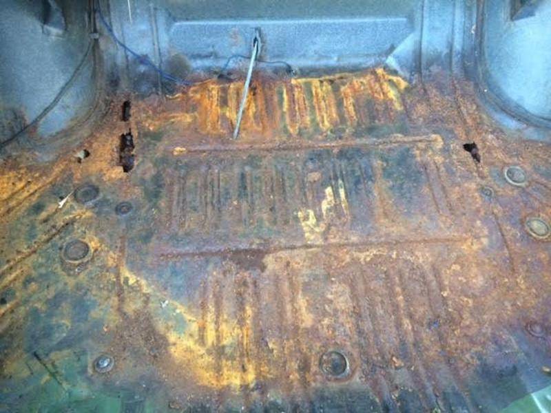

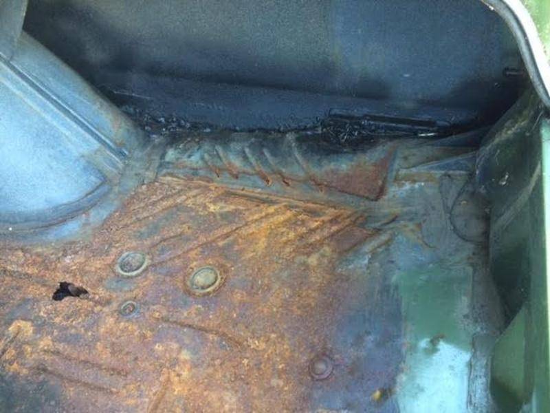

Lastly the rust, while there are some holes they wont take much to repair but upon inspection I can now see that the rails are rusted out because of nests inside, lots of nut shells in there. Rats?17.jpgjack.jpgunnamed (1).jpgunnamed (2).jpgunnamed (3).jpgunnamed.jpg

I talked to the guy a few times and I beleive that there was no rust in the car at all except for the front chassis originally, once that started to rust he put it in his garage to work on it but time got away from him. Then rats or mice made nests in the rear rails and that started the rot there. Those rear rails are full of nut shells and other nasty stuff.
