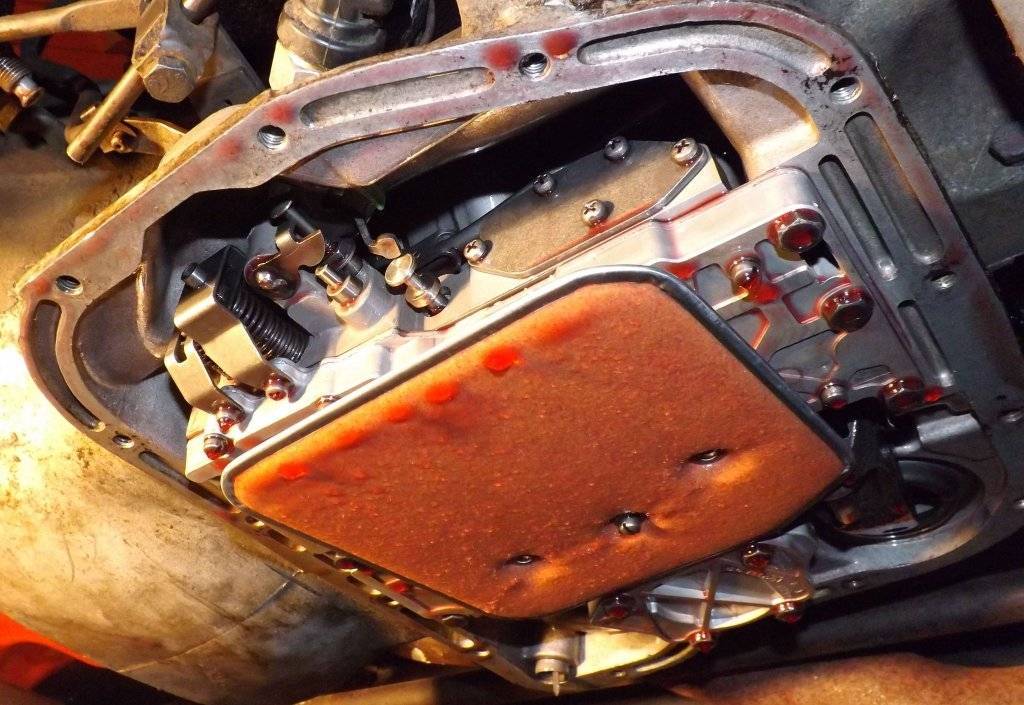

After I finished with the interior today I decided it was time to start work on the transmission, I decided before I pulled it to check the oil pump I would check the valve body. So after draining the fluid I dropped the pan and voila! There it is, I wont say straight away whats wrong, I want to see if anyone can pick it. And no it has nothing to do with the filter, that was me working towards removing it when I spotted the problem.
Ah the manual lever needs to be in the slot in the manual valve. I think it would work better that way.
