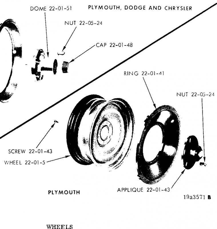

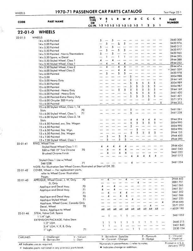

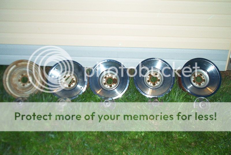

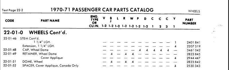

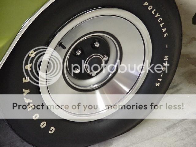

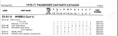

then yours will be correct..wrong cap AND base though...as far as l understand the 6in was all there was for the GTs...thats why l knew something was amiss with the set l bought...basicly bought before l knew the diffrence...buddy was spoutin they were oem roadwheels...guess trick here was they were oem for something else...
that being said if lugs match up and caps and rings can be applied this type of rim would be good standin for the smaller 6 in rim on the rear
looking like lm gona have to send a pair to idaho and Paul and see where were at re fittment...if they work am throwin 7 in rims on rear and oem 6in on front...
