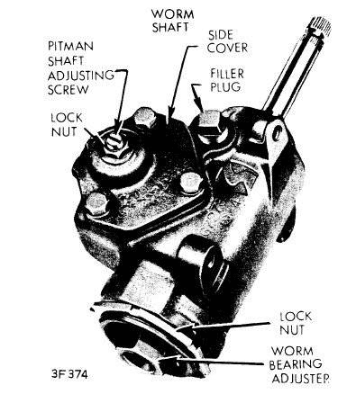

You replaced the steering gearbox? Where did the replacement box come from? Is the front end ride height adjusted to OEM specs? Is the rocker panel parallel to the road surface? Check that the input side of the steering box does not let the steering input shaft move in and out when the wheel is turned off-center, either way. That translates into "slack" although the rest of the linkage is "tight". There is an adjustment for that in THAT part of the box (not the other adjustment that everybody normally adjusts).

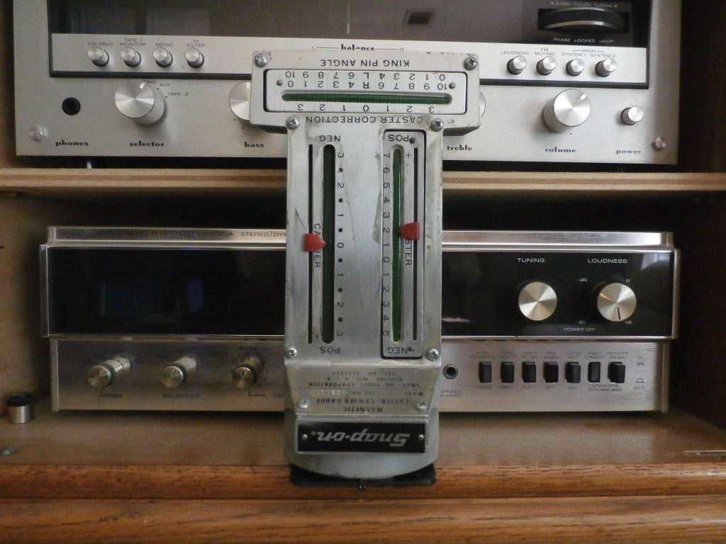

Start with these. They do wonders for the wanders.
The Snap-On of course does caster, camper and checks king pin damage. Takes about 2 minutes.
The fish scale gets wrapped across the front of the tires with small chains hooked in the wheel slots for a reading. Then push car "forward/no brakes" 1/2 revolution and read at the back of the tires to find the "absolute" zero tow. Takes about 5 minutes.
Both are dead nuts accurate and can't be argued with.

Question @ all ....is there / could there be play on a new steering gearbox ?
Yes. There is a special procedure to adjust the steering box. You don’t want to overtighten it because it will cause damage. Get the service manual and look for the procedure on how to do it.
