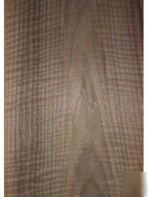

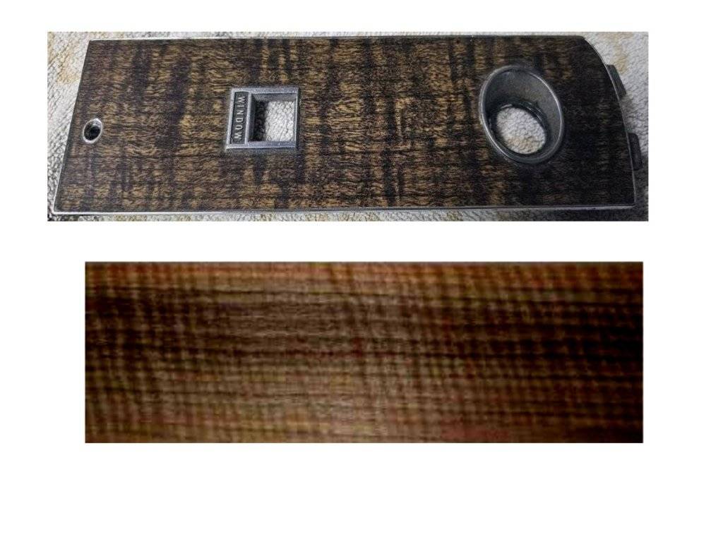

The pattern is probably based on a "Figured American Walnut" or possibly a "Figured Black Walnut".
[/URL]
If I mess with the contrast and brightness to simulate a darker stain, it gets pretty close.

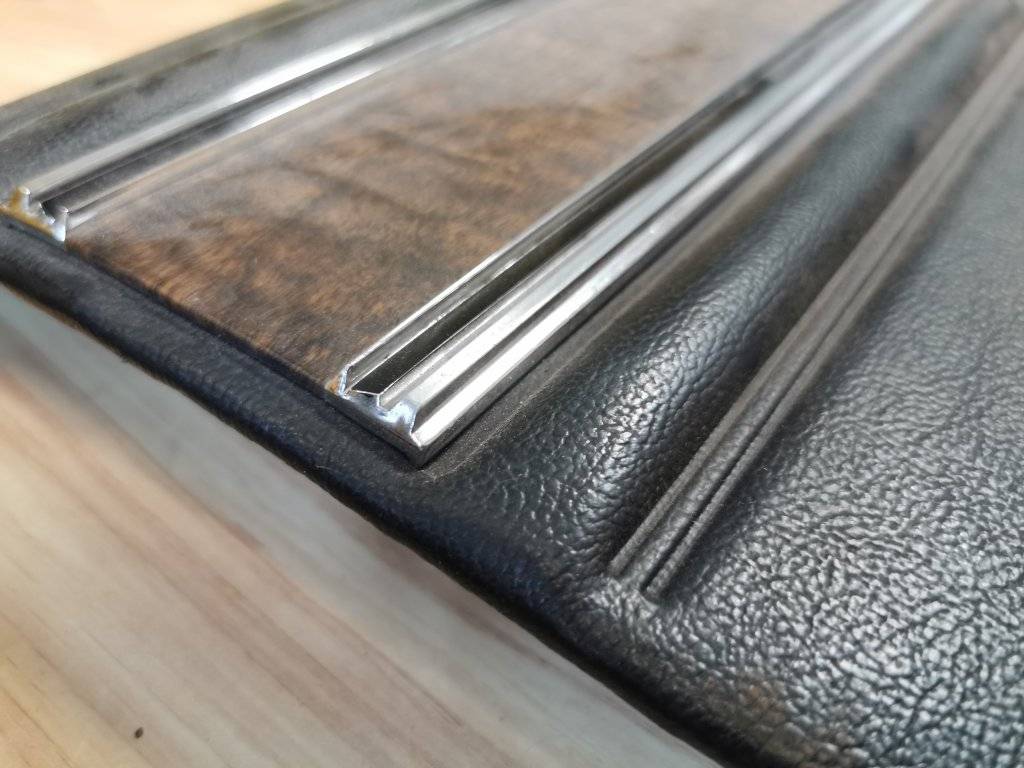

I have thought about using real wood veneer myself, but abandoned that idea because the interior pieces in the 69 are not made for that. A lot of shape corners and bends. The cars in the earlier years which had real wood veneer from the factory were designed with that in mind so the parts were designed to accommodate that.
Maybe its possible to bend the real veneer that much, but it's a gamble if it holds up correctly and I feel like introducing a big possible problem into the interior I have to deal with later.
The 3M DI-NOC film was there from the factory and it fits the car. So, thanks for the offer, but I'm going to stick with the Di-NOC film!

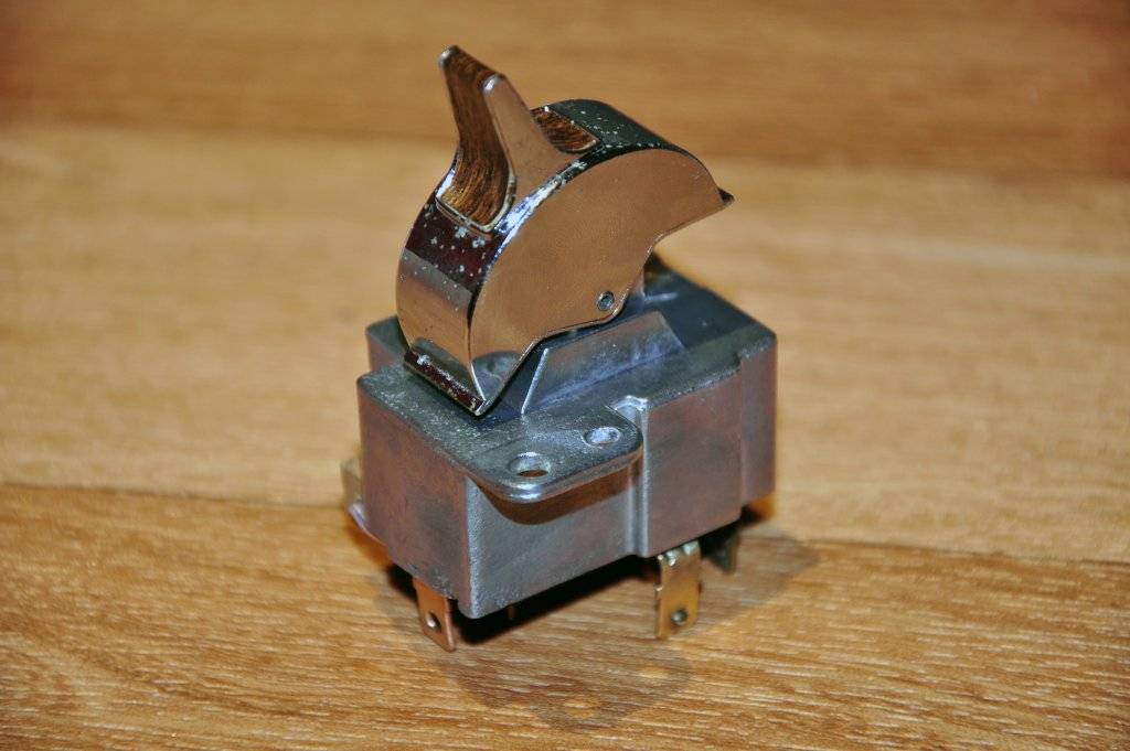

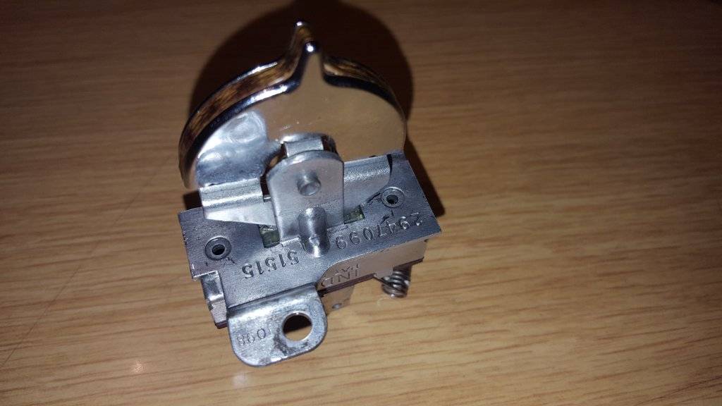

Here are a few parts that show the tight corners and bends I mean.

Yes, I have good vendor for real "flame" walnut veneer, but like Julian said it's almost impossible to bend to tight corners. Flat surface is easy , just glued over thin aluminium and cut with CNC , water jet cutter or laser and then lacquered, but tight corners you need to glued veneer in place and then finished and lacquered. Not impossible..but.. lots work to do over there;), just let me know Julian If I can help you..
Regards,
Mika
Thanks Mika, I'll look into it but probably go with the 3M stuff. It's textures, like the original film and actually looks nice.

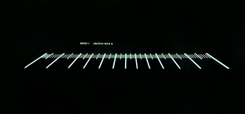

I've already made a perfect digital version of the Speedometer scale so I can either cut it out of vinyl or cut a stencil from vinyl to paint it onto the new wood grain. I will have to try what works best.
In this process I added some km/h marks because the German Tüv requires these.
I tried it on the 5 wood patterns I like the most so far:
As usual, you've got every aspect of the project well accounted for.
Very impressive work so far. I look forward to seeing the completed cluster.
