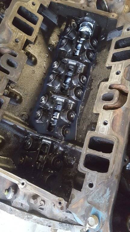

Here's another pic, not much carbon buildup noticeable.View attachment 223974
Looked nice for MY 400, which is from a 77 RV to start with, but I might want a little more pop from that motor. I have a million or so things to do before I get there anyway.

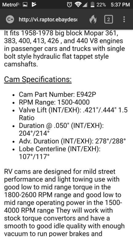

Here's a bit of information I've found while researching...here's the "RV performance" cam

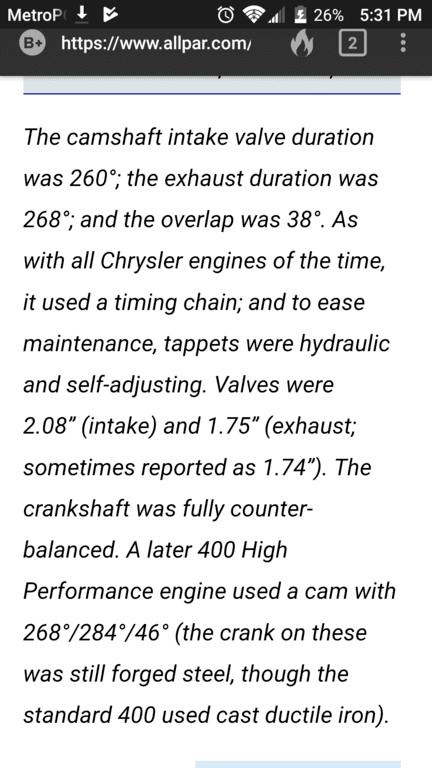

And this is information found regarding specs on the stock cam
Not trying to second guess anyone here, as I admittedly know very little about camshafts. Just trying to make my second attempt at this an educated decision. Thanks for the suggestions so far.

Use the @.050 duration numbers to compare cams. Advertised is just that advertising or lying like a lawyer they can just pick the point to measure from. The @.050 duration is measured @.050 of lifter movement to .050 before it sits back down on the base circle, making it a apples to apples comparison. For the stock cam specs with no @.050 lift, it is usually okay to multiply Chrysler's advertised number by .85 will give you a number kind of like the at .050 duration. Don't take that calculated number as gospel though, just a reference.
Hope this helps. Keeping your intake duration in the 220-230 range is good for a heavy stock type car. Using exhaust manifoldss extra exhaust duration doesn't hurt.

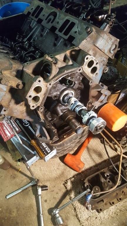

New cam going in.

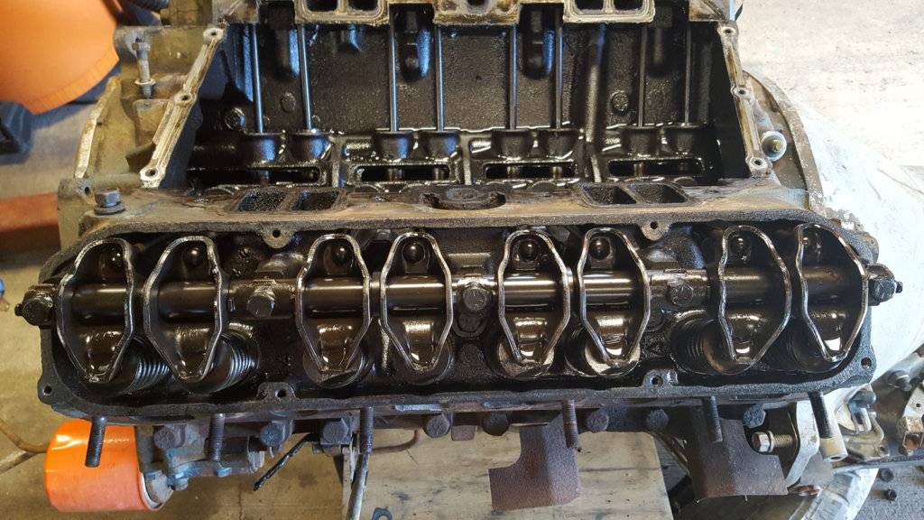

New lifters installed.

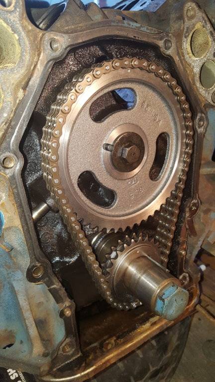

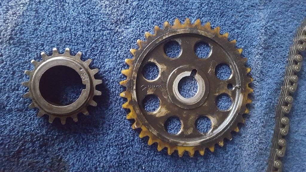

New double roller timing chain.
Uh oh...according to the FSM there should be an oil slinger of sorts here...wasn't one here upon dissasembly.
Who knows why it's missing. Some one at the factory was having a sneezing fit as the engine went past his station.... Find one and install it. It takes a bit of the load off the front seal, unless you want to rust proof your car one quart at a time.
It is called a slinger because it slings oil...all over the timing chain...as in lubricating it so that it lasts a long time.
Damn.

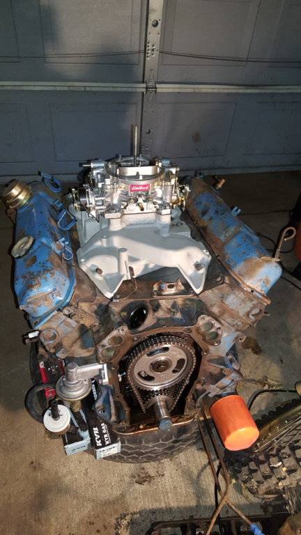

Reassembled as much as I could, am waiting on the oil slinger. And now it's too cold to paint, will have to wait till next year.
