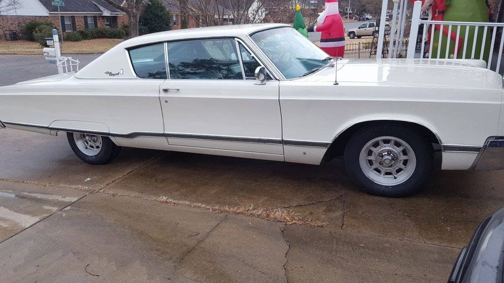

On my 66 Newport (provided I can even get them)?

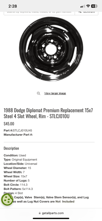

Yes, they will. I have a 67 Newport Custom, 2dr fastback. Original wheels were 14". After a blow out and damaged steel wheel, I installed my 80 Dodge Diplomat "Mirada" wheels, yes, 15 inch but they were factory wheels from my first 80 Diplomat. I bought another Diplomat just a few years ago and it came with factory steel wheels. I put the Mirada wheels on the Diplomat and put the steel wheels with spoked hub caps (I call them 5th Ave Hub caps) on my Newport. Perfect fit. and just for size, I run 205 x 70 series tires. Feels great on the road. Save some money.. see if you can find wheels from Fifth Ave.

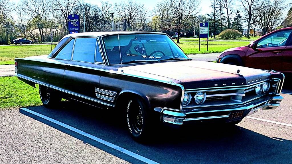

15x7 police wheels off of marketplace.
They used to be cheap and plentiful.
I have about $75 in these with the sandblasting as they were pretty rusty.
There's some pitting but I painted them with bedliner.
I should put caps on cause I keep getting in trouble with my nuts showing.

I missed out on a set of police wheels for $350 last summer . . . really regretting it now.
