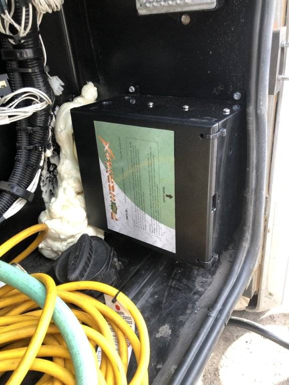

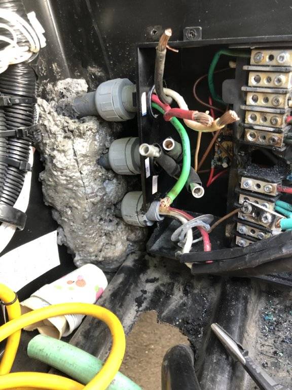

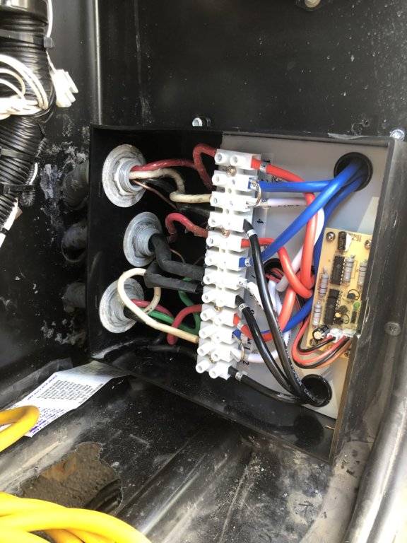

Swapped out the transfer switch in the RV today. Things went well. Original transfer switch crapped out for 1 or both of these reasons: 1) the original device was of a poor design. Manufacturer had a massive recall, which drove them out of business.
2) a loose terminal strip screw got loose and almost caused a fire, and frapping the solid state relays (I believe that they are hexfets) to croak.
I had spliced in a ‘bypass’, which tied a 50 amp receptacle directly into the output of the transfer switch (I used a 25’ 50 amp extension cord).
I had to swap the top n bottom flex conduit as they were not aligned with the new transfer switch. Other than that, a relatively easy task.
In process of installing new unit
Installed, less cover
Done

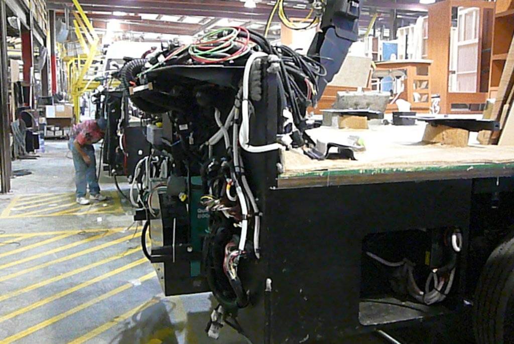

You guys are either rich, brave , or both lol. I always wanted a RV, till I worked on a few . My rep as a decent mechanic got around to a few RV guys. I guess a good RV shop is usually backed up crazy, and the ones that get you in do horrible work. I started to get alot of calls, but started to turn them down, damn things are just too big, and systems are buried! Found out most coach builders connect all lights to the aux trailer circuit, and that makes fixing turn signals fun. Bravo to you guys!

Doing that in your career, you think RV design would drive you nuts lol... I found out a few drinking buddies of mine became electrical engineers at a coach builder, that blew my mind..
I've worked on fire trucks also, some of the engineering is really cave man like on some of those. No real thought, just slap diodes everywhere...

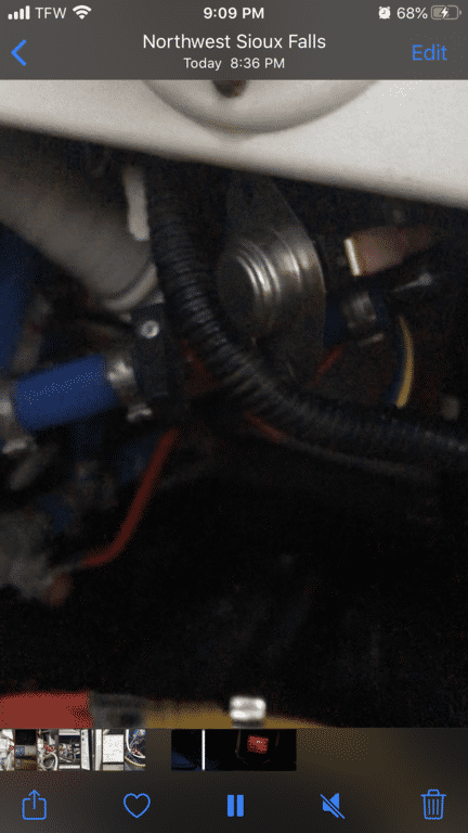

I have just insured that we won’t have freezing temperatures the rest of the spring and summer, because I just fixed cargo bay heater in Bruno. Sensor was bad.
