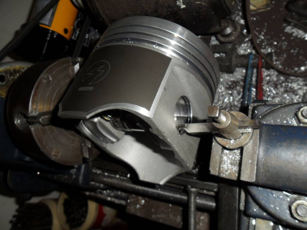

Here's what I recently was working on. Modern replacement 440 six pack forged piston with shorter and lighter aftermarket pins. Cutting for Tru-Arc pin locks to allow floating pins.
