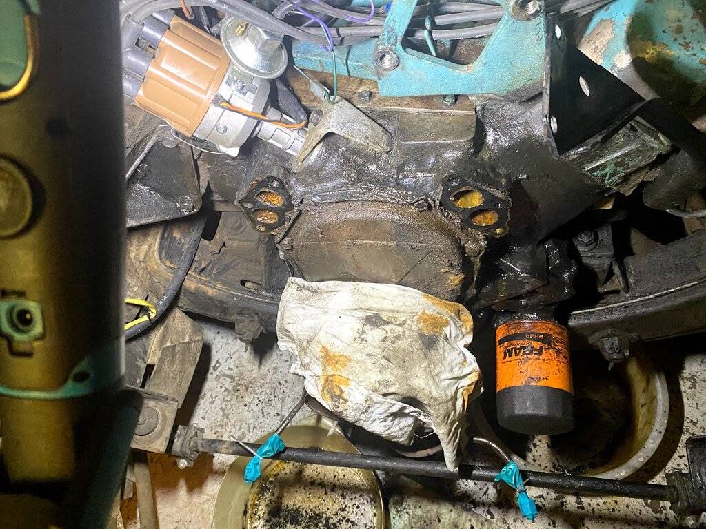

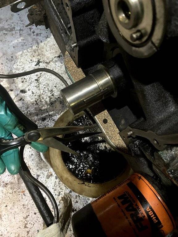

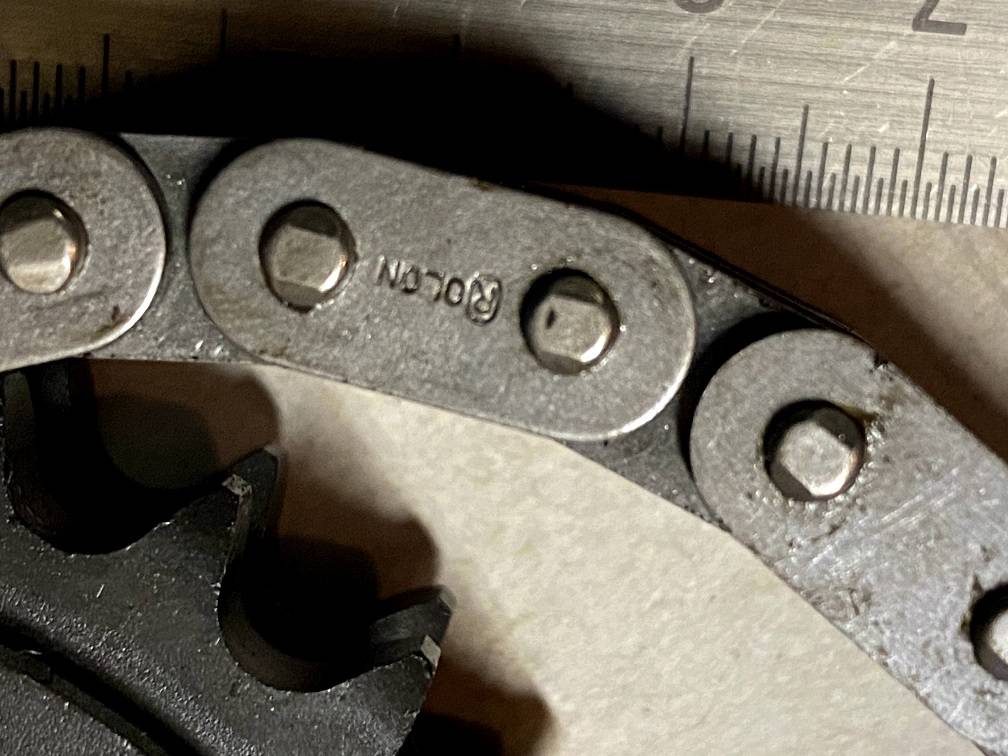

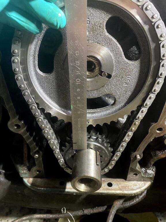

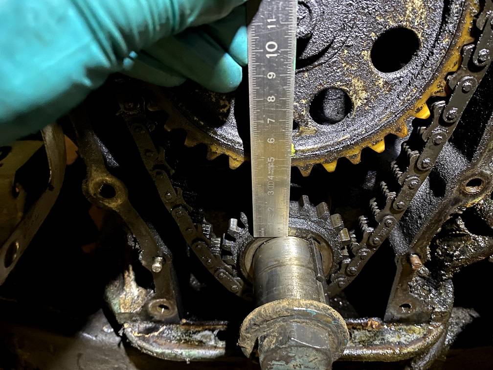

Reached the chain this evening. There is some slack in it, but the nylon tooths are all intact.
I am suprised how dry the lower gear was.
Have the new chain soaking in engine oil now.
The Sunsong 8401027 was correct. I might make a separate thread for the PS pump, when I find out if the new seals leak or not.

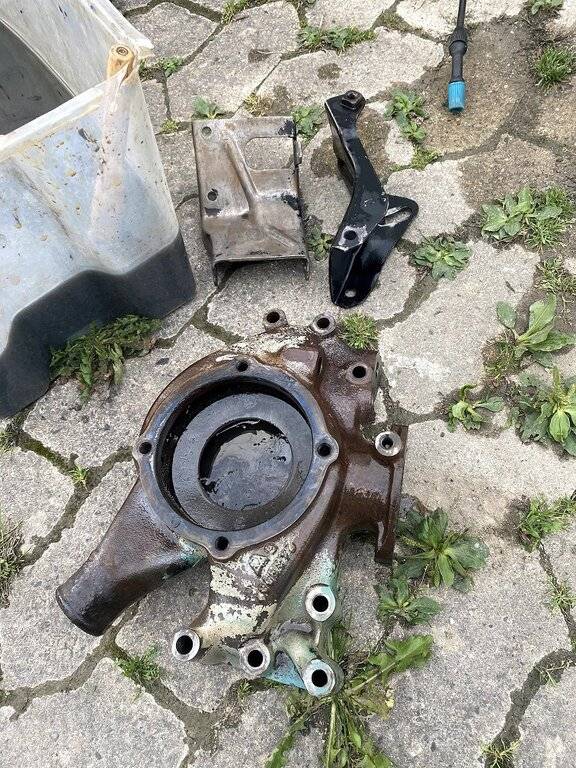

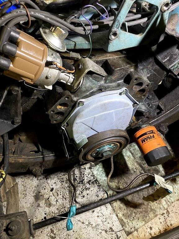

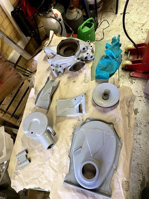

In the mean time, I thought I would post some pics from the process. They are probably self explanatory for the most part.
Great pictures! As a point of reference, note the position of the crankshaft keyway in relation to the position of #1 cyl connecting rod when at TDC.
Enjoy!

I made a version of the tool to hold the crank while tightening the balancer bolt after I saw a link to the correct tool on one of the forXbodies.com forums. It worked well enough to post a picture. (It took the 135 Ft lb).
