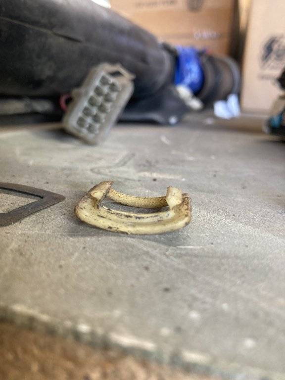

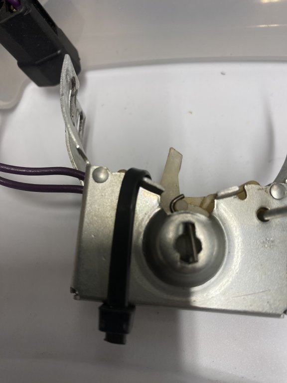

Ok so here is the opening in the tube that rotates with the gear selector that engages the lever on the switch. It’s not a pin at all that is missing here but a piece of plastic with sheet metal spring that I think aids in holding the plastic piece in place. It’s the plastic and sheet metal spring that becomes loose and falls out of the way inside the column thereby no longer moving the lever that both disengages the parking brake and activating the reverse lights. In the third and fourth pictures, you can see the plastic piece and sheet metal spring and on the 3rd pic you can actually see the clean spot where the spring loaded lever makes contact with it. In the 5th pic the plastic piece and sheet metal spring is in place.
Wow, completely makes sense. My setup is pic #1 and 2. The plastic piece has long fallen by the wayside
The purpose of the plastic insert is to provide a friendly surface/contact point for the moving plastic tab/finger/lever on the switch. As proof of the latter please see my pic below. You will notice the right side of the lever is flat, yours had a bump. Mine is flat from years of contacting the metal sleeve moving back and forth with the gear selected. The sharp metal sleeve wore down the plastic.
We were wondering why Chrysler would have such a ridiculous design. The plastic insert makes sense, too bad the insert itself did not hold up.

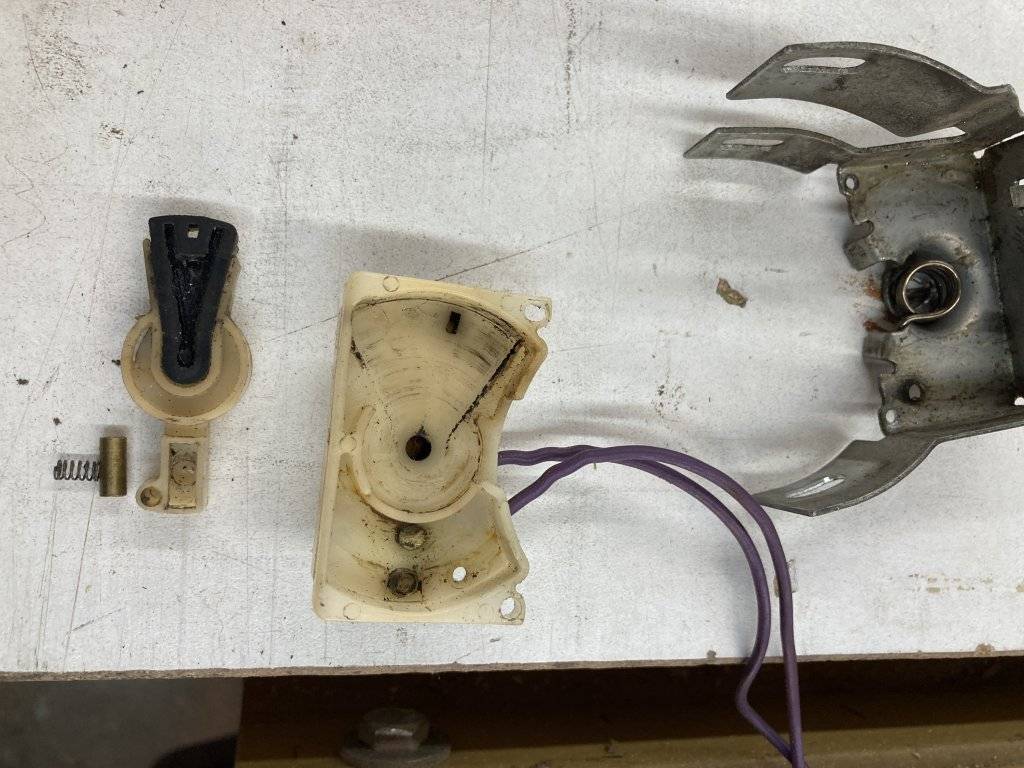

After spending some time with some switches I have here I still can’t explain why having the vacuum attached for the brake release would have anything to do with the operation of the reverse lights. It’s a relatively simple two in one switch that relies on one action of the gear selector mechanism to trigger them both. So as long as the lever is in tact, along with the parts inside the column that engage it and your switch is good your parking brake release should work without the connector for the reverse lights plugged in and conversely your reverse lights should work even if you don’t have the vacuum connected to the brake release. They are independent of each other.
The disassembled switch in the picture shows the simple internals and yes, the lever is broken off and missing on this one. It is too far gone to save as one of the electrical contacts is burnt also.
