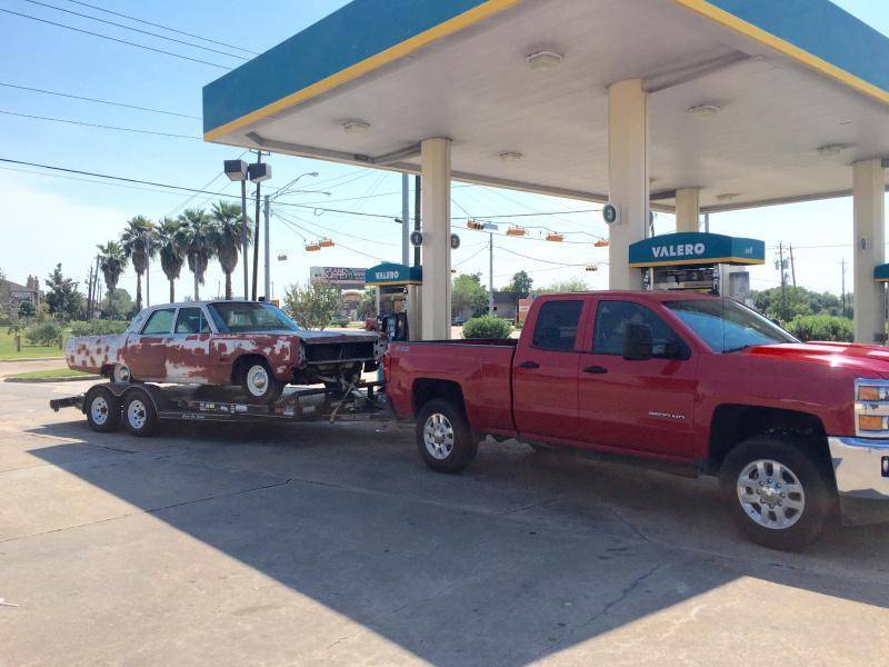

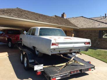

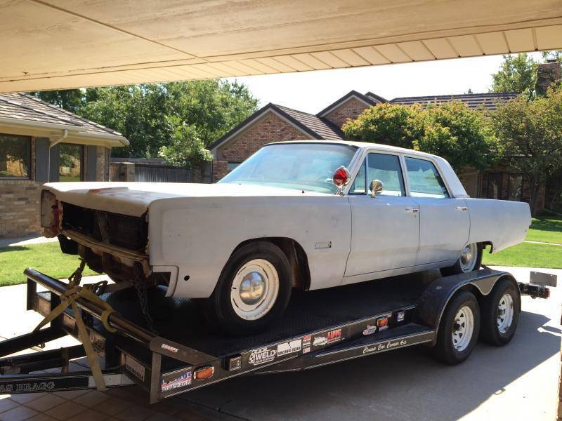

Started right up and drove onto the trailer - now the 8 hour drive home!

Made it...Unit P8-516 is home. Amazing what a coat of primer will do for appearance. Now for a change of fluids and filters, when I get it off of the trailer.
Congratulations! Ive done the long haul home and it is actually fun. A moment in time of getting your new friend home safe and sound, hopefully uneventful yet, the whole ride is a story

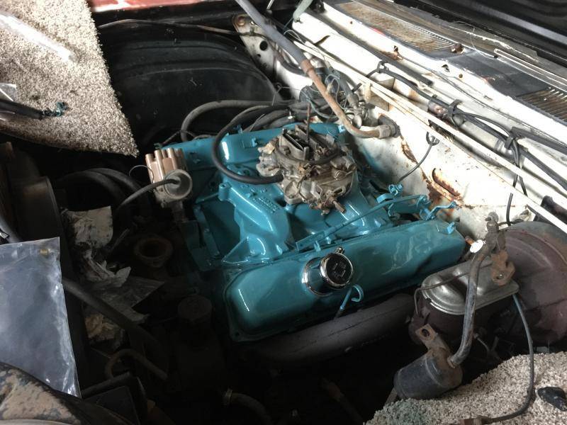

While waiting on parts to arrive (booster, master cylinder, water pump, alternator), I disassembled, cleaned and painted the top end today. Looks a little blue in the picture, but I assure you it IS turquoise.
