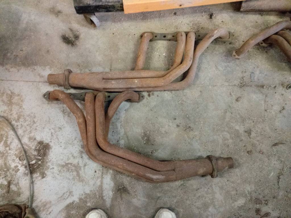

I bought some used headers that look identical to the TTI headers I see in examples I have seen in and out of 65 Sport Fury's. I'll try to post a pic of them
Here's the headers

Bare in mind that TTI makes RB headers and B headers. Your 383 headers will take some tweaking as Davea mentioned above.

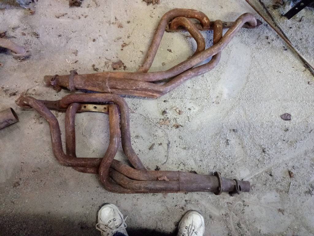

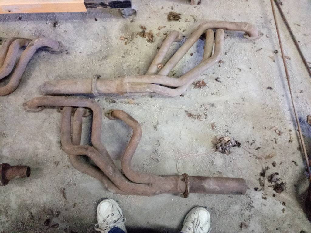

Unfortunately I have no idea nor did the seller of the 3 sets of headers I bought at the same time for $150 what they fit. Really would love to know what the other headers fit!
