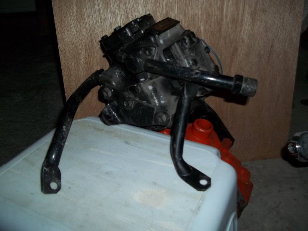

The two tubular braces with flattened ends and the central brace on the rear of the pump are specific to low deck or high deck. this is a "Raised deck" in the photo.

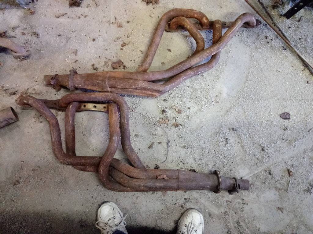

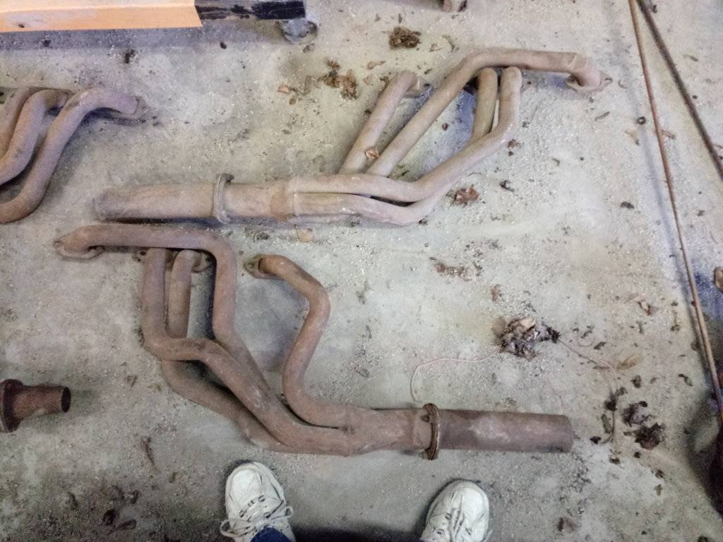

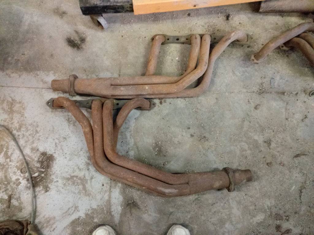

Conveniently TTI doesn't show any pictures of their headers for the c body on their site. Has anyone looked at the pics of the headers I believe will fit my 65 SF and the other 2 sets and have any input about them?
I have some.on my computer, I'll see if I can get them up for you tonight.
Cool Thanks. I really would love some help with identifying the headers I bought. Heck for all I know they could be small block or even from other body Mopars. Sorry to post pics again.

Unfortunately I have no idea nor did the seller of the 3 sets of headers I bought at the same time for $150 what they fit. Really would love to know what the other headers fit!
Top set is for a truck
Bottom set is for a early B Body 65 down.
Those are my best guesses.

According to the previous post the bottoms might actually fit my car according to his experience so I won't know until I install the motor. I am guessing that the middle set is going to fit the best since they most resemble the TTI headers. PM me what you feel if a fair offer.

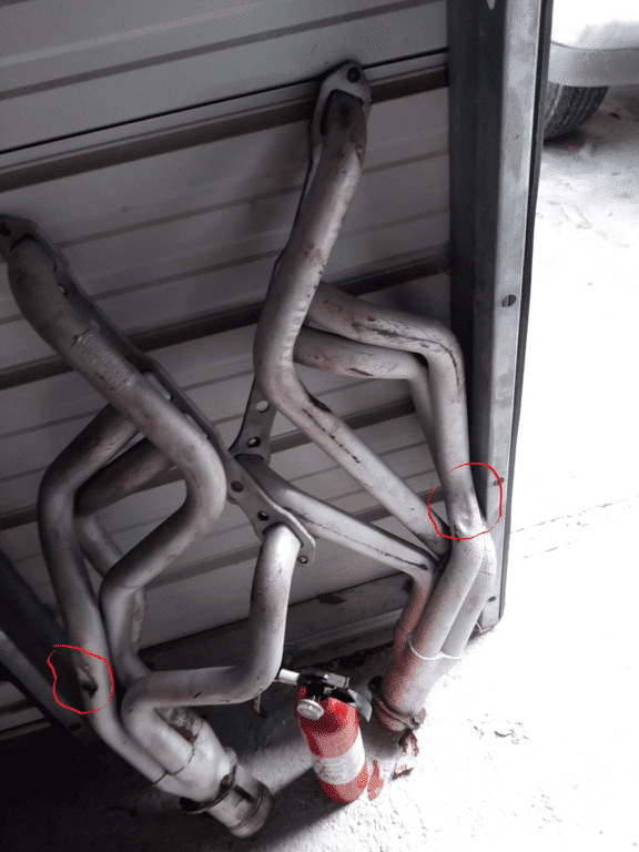

I had a minute, went out in the garage and took a picture of the headers that came off my car. Red circles show dents for TB clearance. These are Hedman.

I'm pretty sure the middle picture is the one you will need. The engine sits really far forward on a early B body. See how the passenger side forward tube stretches so far forward on the bottom picture.
