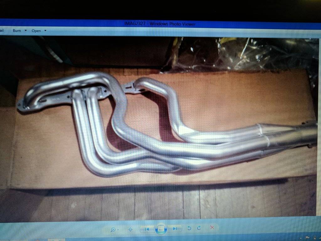

65 SF will header fit if I go to a 440

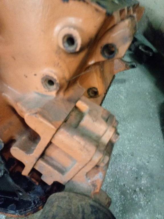

dizzy = distributor and andy you have not said if that 440 block as those two driver side mounting bosses tapped above the oil pump on the front face of the block , well ?
Yes, both holes above oil pump on the front of the block are drilled and tapped.

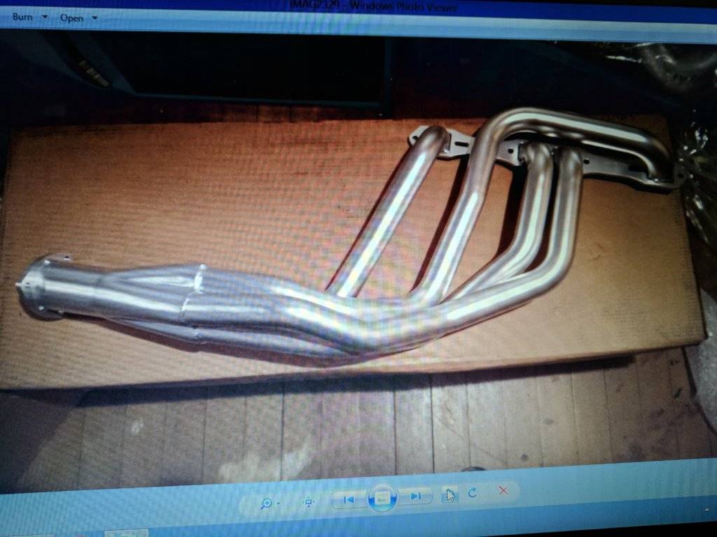

Day late, but here's a pic of a pic of the headers. For a 440, but I'd imagine they should be very similar compared to the 383.
