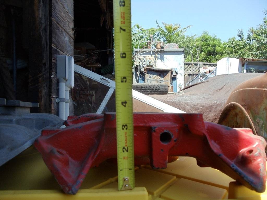

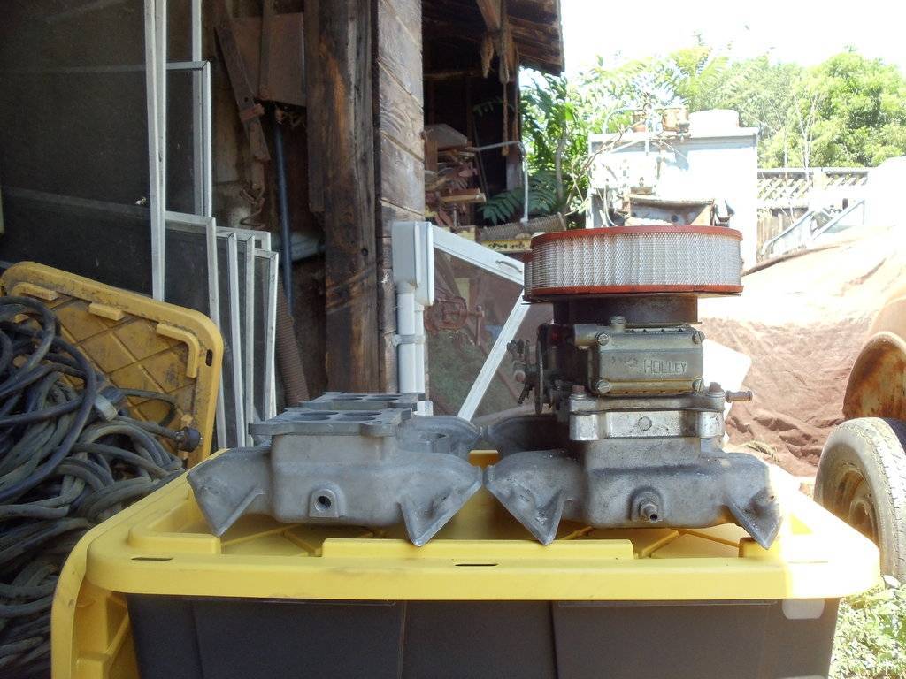

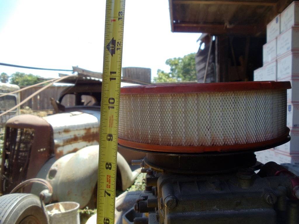

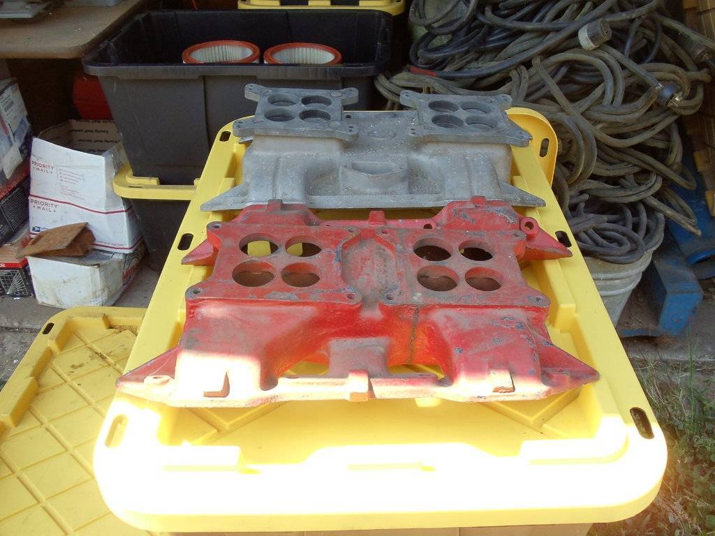

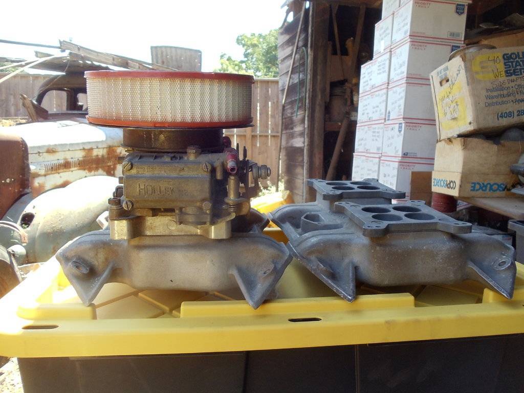

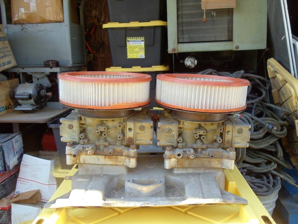

well opps , heres more twin fours , and holley on twin fours with mine tall spacers to replace the the offy ones for throttle linkage clearance . this set up put the tops of the air cleaners on the hood pad and left impressions with a flat lid on them . early /6 elements with my home home parts . ran this on my 65 880 rag it would do 120 in second gear , then drive would lift the nose as it rocketed down the road going for more , lol . with a tired old 383 lower end added adjustible rockers pushrods cammed it with a mild solid put headers presolite duel point , used some 74-77 rb heads . ran 27''plus tall tires on her on 15x8.5 redone old school torq thrusts . same rims n tires as my 67n 300 rag .

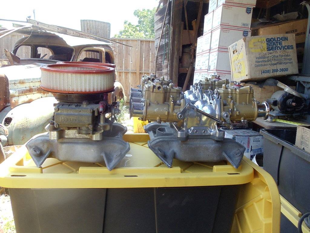

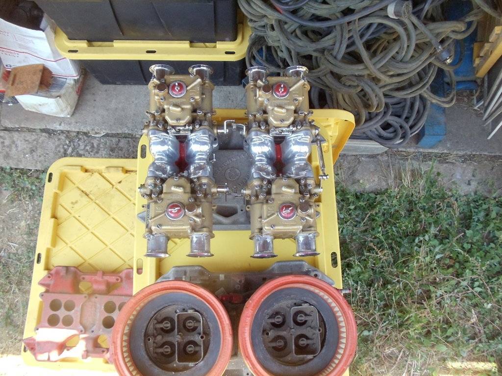

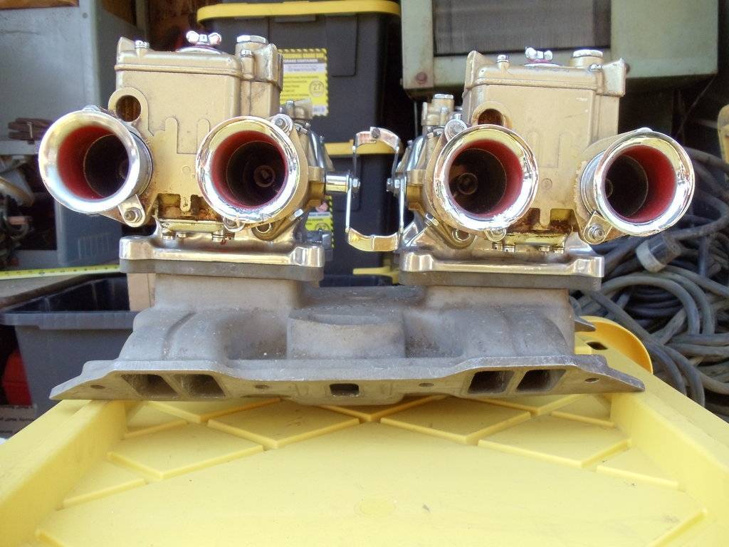

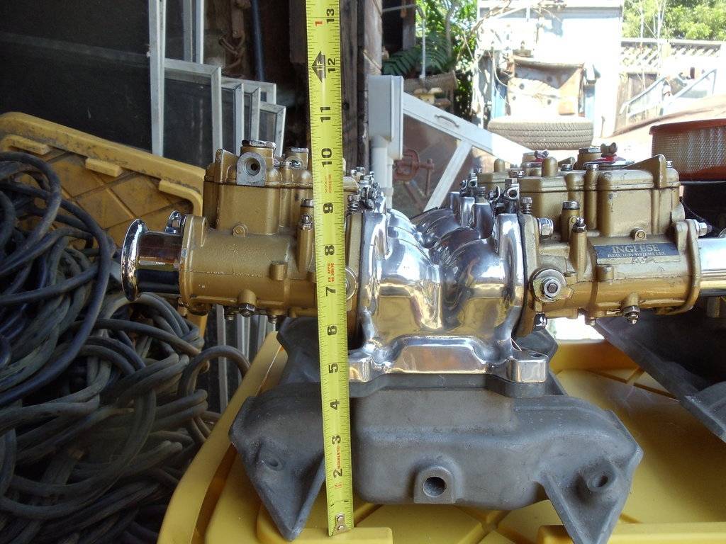

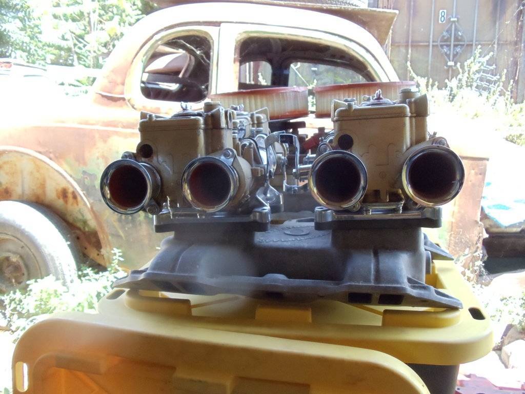

but i saved the best for last boys , and i do mean boys because it pretty close to everyones dream carbs set up . four side draft italian made webers on a twin inline fours intake . its too cool to hind . but what eye candy appeal , when you pop the hood . lol .
lol .
Amazing Weber setup. Never seen anything like that before. Wow.
i'm hoping my buying stuff could be though , and using is the has been being implemented . or i guess i could sell stuff , and have every low baller in town after me to sell at their level . so be nice and you might make it in the will , lol . i havn't gotten to the race stuff yet , blowers from 4 71's 6 71's 8 71's , vertex magneto's , injections two n four port , american magnesiums rims , even an mw injection set up, champ quick change r/e's , moon fuel tanks , a833 4spd rack . just digging through my autometer gauges storage bins for a tach , water
temp , oil pres , vac for this crew cab i'm working on . its got a great running c body eng/trans in it now , with some speed goodies n chrome . there is just a lot of custom type projects i've got stuck in my head , and gathering parts for them , has surplus parts that are so cool . that weber set up was on a weiand blower twin carb top i needed for another hotrod project . and when i pulled those weber adapters of the blower top . i set them on that offy intake , and went , wow thats cool enough to be the start of a cool hotrod look for a plan old b motor . so in the hoard it went , lol .

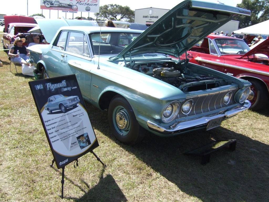

In 1962, Chrysler offered both a Dodge and a Plymouth with a 383 engine and two four-barrel carburetors. The engine also sported a Clay Smith solid lifter cam. The carbs were AFBs and the air cleaners were oval shaped. I think one of those cars took the Stock Eliminator title in either '62 or '63. Very cool setup. I don't think this package was ever offered again after 1962.
Here is picture of a Plymouth equipped with that 383 / 343 HP engine:
