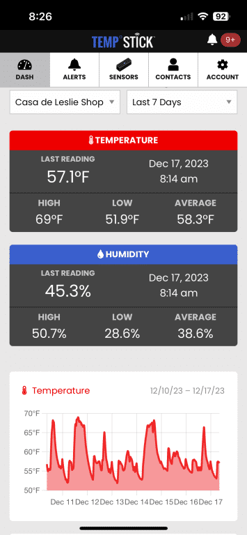

Put a WiFi temperature/humidity sensor in the car.
I have 4 Temp Sticks and like them.
Here’s a couple of screenshots from the app:
Temp Stick

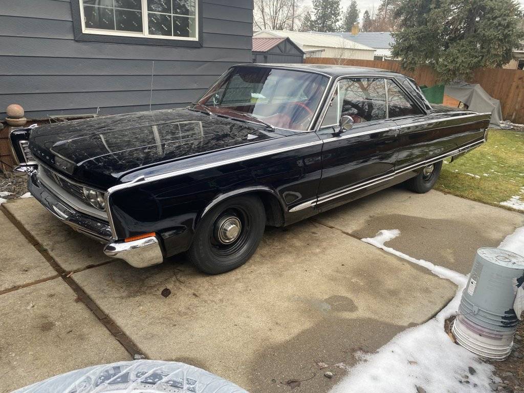

Morning update:
Checked on the car today and it was completely dry on the inside save for the very bottom of the rear glass where I wasn't able to wipe it down as well (towel was too big to fit in there). Under the hood was dry and inside the trunk was dry as well.
I think the car cover was the biggest offender at retaining moisture. Leaving the wing windows fully open and the cowl vents open seems to promote enough airflow through the cabin to keep things dry.
It's supposed to rain a bit on Tuesday, so I'll check back with it then.

Like I mentioned in this mornings update, pulling the car cover off, drying EVERYTHING off, and cracking the windows has put a stop to the problem for now.
So, I now realize this concrete pad is problematic, as well the fact that the trunk is above the lawn. I’m gonna move the car, put down a tarp, and then move the car onto the tarp.
