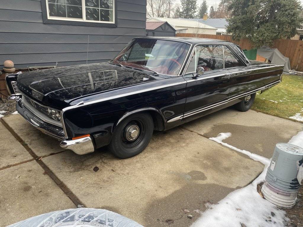

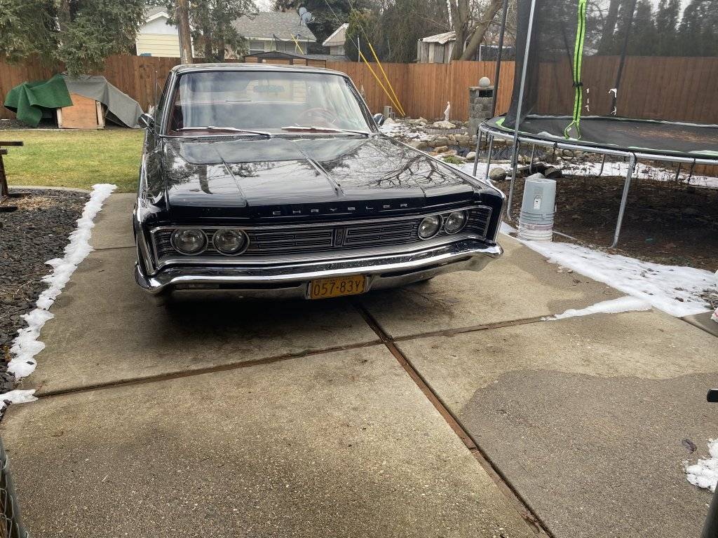

So, I now realize this concrete pad is problematic, as well the fact that the trunk is above the lawn. I’m gonna move the car, put down a tarp, and then move the car onto the tarp.
I really think that will help. It's a good start. May I recommend the Silver 11x19 tarp and a package or two of tent stakes from Harbor Freight. Yeah, if it's been on-going, then no one except you has agonized over it. Well, sounds like the buck stops here, with you!
Hopefully this will stop moisture from sweating up through the concrete and into the car.

I could probably do that, although the inside of the car cover is pretty wet and dirty right now, and putting it back on the car risks scratching the paint . . .
obviously the culprit is the cover itself keeping moisture in the car. this can't be that complicated. keep us up to speed on your findings.

There must be a large amount of water trapped in your car. Can you get a reading on the air humidity level? In my shop right now my meter is showing 29%, dry. Even at that dry level if I parked a car with wet carpet and closed it up, it would be like a green house with moisture condensing on cold surface, recycling round and round until the moisture is removed. Can you get your car into a dry garage for a few day and run a dehumidifier with all doors and windows open? When I have had to park on dirt floor, I will lay down vapour barrier larger than the foot print of car. I have also covered vapour barrier with gravel if its a long term parking spot.

I'm wondering if all the moisture is being trapped by a car cover that is all the way to the ground and the black car is somehow wicking up the moisture from the concrete.
I personally would buy 3 or 4 sheets of 3/4 chip board to cover the concrete with a piece of vapor barrier on top and make sure the top is not sagging to the ground, you want the air to circulate around the car. What color is the car cover?
