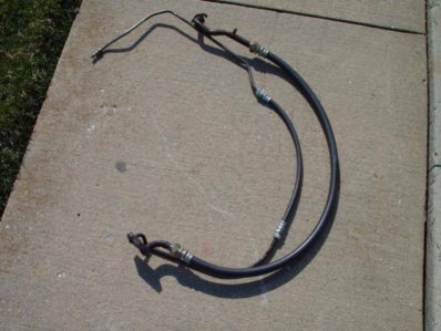

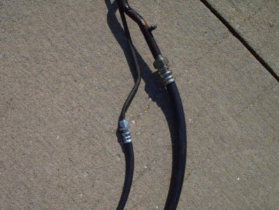

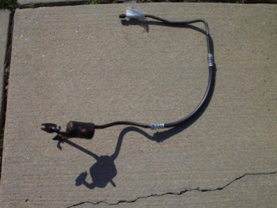

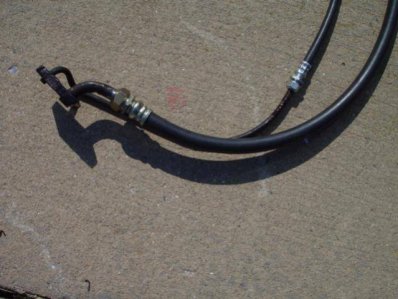

I'm keeping this stock AC unit. It has not spun since 1984, the last time I ran the AC in this car. I broke into the system in 1997 when I started taking this car apart. I scored the donor 300, and, sourced spare hoses from it, but, I still went and looked for new OEM or aftermarket hoses, they are not available at all. So, I may just take them to the hydraulic hose shop, and have them manufactured using the existing canisters that are in the lines.
Of note, I confirmed the PS gearbox is needing to be changed, it dumps PS fluid out the input steering shaft, must be totally dry-rotted. Good thing O'Reilly has them, just over $120 bucks for a rebuilt, $30.00 core. One thing about the R12 systems, they blew COLD, far colder than the R134, I'd so Love to score some old R12! Also, going to get an Air Filter for the stock dual snorkel intake requires it being ordered! Amazing!

Ok, I called around and got some information where to get my A/C hoses rebuilt. They said if the connecting ends, and metal pieces are good, each rubber section will be about $50.00 bucks to fabricate and create. The Flaming River Ujoint system I'm back on board with, they sent me the wrong item, and they're sending me the right one, as soon as it gets here, installing it after I install a new P/S gear box which is spitting oil out the front of it when under pressure, so, might as well just replace vs. rebuilding it.

If you need a place to get your hoses redone...you can probably UPS to the place I got mine done in Delaware. They had them done in less than 24 hours. I think the whole job was $220.
