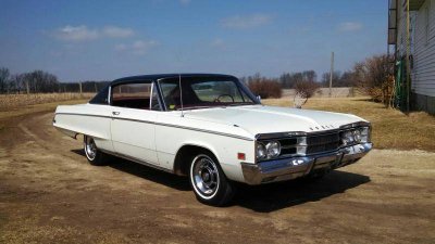

Hello everyone. I haven't been on here in a while after selling my 66 newport. But recently I have purchased
another C body that I fell in love with. It's a 67 Dodge Polara 2dr hardtop with a 318. Upon looking at the car
it had carb issues. So after many hours of negotiating price I put her on a trailer and brought her home. I bought
a new 2bbl carb and installed along with all new tune up parts. She is hard to start cold but after the initial start
she starts quickly the rest of the day and runs like a top. I changed the oil and filter this weekend and took her
on a 170 mile trip yesterday. She performed beautifully. After arriving home last night and letting her sit for about
half an hour I checked the oil. It is almost a quart over full and smells of gas and also has a couple small spots on
the dipstick that were a little milky in color. Could this be a bad fuel pump or am I looking at a more serious problem?

Welcome back! ! That looks like a nice driver.
Thank you! Glad to be back here and in the drivers seat of a mopar again! She is a one family owned car. The guy I bought her
from grandfather bought it new. I have the window sticker and bill of sale where he traded in a 65 chevy truck. Interior is like new with the
exception of a split in front seat and passenger side door handle. The am radio still works with a fader for front to rear speakers. And she only has
94,000 miles!

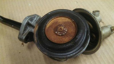

Well when I got home from work tonight I swapped out the fuel pump and changed oil/filter. Hopefully this does the trick.
I cut open the old pump and the diaphram is dry rotted. I guess from sitting for a long time?
