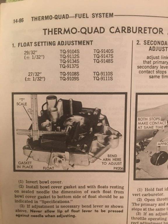

Since last rebuild (last of three) about three months ago, I’ve been tweaking and micro adjusting it to where it is. But a pattern is developing that is pointing me to a possible sinking bowl float.
Just ordered a rebuild kit and new set of Carter floats that should be here Tuesday.
Carb no on it is 9180s which corresponds with the recall notice. However, no rebuild kit or information source I’ve found lists a float measurement. They all say NIA, no information available. I set it to 29/32 as the next available measurement for a 440AT.

Carb book shows that carb with a 13/16" float level. The complete carb manual for carter is available online at www.oldcarmanualproject.com. The listing is in the technical section at the bottom of the page. It takes some digging to get to it.
Dave

Type carter carburetors in the site search box for the site, the '65-78 manual will come up.
I can e-mail the link if you PM me
Dave
