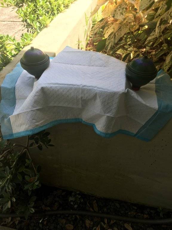

A Beautiful Mind...
And a funny idea of what a spring/shock absorber looks like...

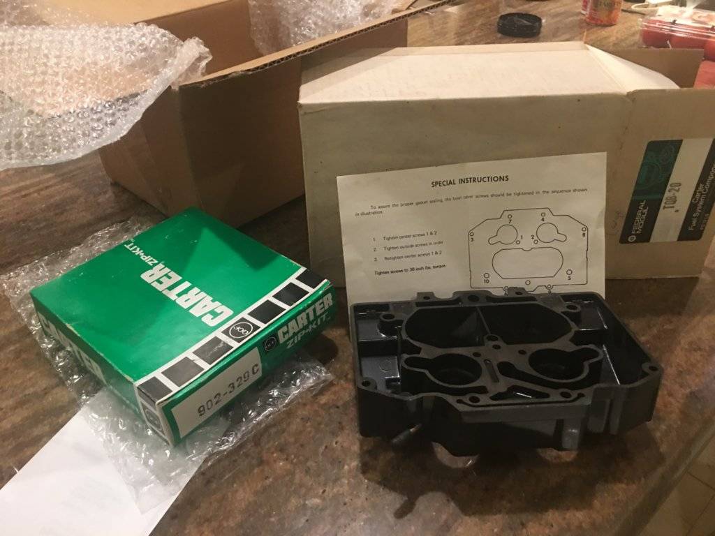

Just arrived today. NOS bowl for my ELB TQ. Mine is not leaking but it is weeping a bit. I suspect a hairline coming off the main jet insert on the right side.
Came with the correct original zip kit.
I’m chasing a low RPM vibration and need to make sure it’s not an imbalance in the carb.
Symptoms are:
Low RPM strumming vibration (not a miss) when engine in gear and A/C compressor engaged.
A little throttle and vibration almost disappears.
Disengage A/C compressor and vibration persists at a lower amplitude.
Release throttle to idle at speed and vibration returns. Requires acceleration level of throttle to quell.
As I said, I don’t think the issue is in either the carb or ignition but.... I’m almost there (high level of tune and operation ) and want to remove any collateral possibilities before I dig into the engine.

That could be a tight exhaust pipe or several other things transmitting the vibration. Sometimes we'd get one where we would put the car on a drive on lift, loosen the engine mounts, exhaust connections, and anything else that may give a firm pressure to the engine (hard lines) and then after it all got to settle, retorque.
Before chasing inside the engine try this... http://ctoprework.lms.nnanet.com/Tech/NoiseVibrationHarshnessTextSection_Sept2011.pdf Pay attention to the use of the sirometer and the frequency math formulas...
A fella like you could be amused for some time, creating a frequency chart to track the offending vibration to the causal component. :lol:
If it does turn out to be a "normal" vibration... remember the manufacturers sometimes hang weight to change the frequencies into a range where they won't offend the occupants of the car during expected operating conditions. Ford seems to do that more than most, there would be dumbbells hanging from the exhaust and weights all over the vehicle to counter act vibrations... these kind of parts are often not reinstalled by whomever is working on the vehicle, because they appear to serve no function.

Interesting read Cantflip. Not my first vibration issue which is why I like your parallel theory that it might be the mounts, exhaust or other hard point connection to the engine.
Was looking at the 440 in the ‘73 wagon and it moves around pretty good with little or no perceptible vibration in the car. As you know, that car’s motor mounts are pads and not the more modern spool type in the NYB.
If I were to guess right now, I would say it’s an exhaust valve that’s burned or not fully opening. The change in throttle changing the amplitude points to it. So... after looosening the mounts and making sure they’re not binding....
I’ll start with a load diagnostic first (also a previous suggestion from you.... and a good one) then a leak down of the suspected cylinder(s)....While also checking harmonic balancer is not slipped, valve/rocker travel for cam and lifter and that pushrod(s) are not bent.
I can do all this with just taking off the rocker covers.
But carb comes first just to make sure that’s not it.
This is, after all, the carb thread. So I’ll follow up with the non carb issues on the main thread for this car.
As I said..... wish me luck!
