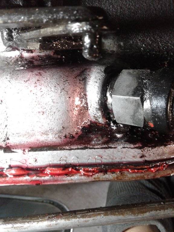

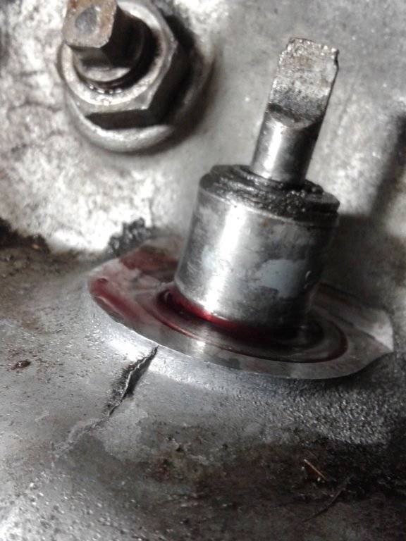

Step 1 remove the levers and clean
Used 7/16 socket to remove the 2 bolts that lock in the 2 levers. They use square nuts and the top one was a bit stubborn and I had to hold the nut in. The top lever was stubborn to lift off but I pried it with the screwdriver. Kind of scary because I was afraid to damage the rod but it went ok. Later on re-assembly I use the screwdriver to pry open the lever for an easier fit.. used paper towels and brake cleaner to get the area clean.
None of this is visible from below so I used photos a lot. Better to take longer and be patient. In the lower photo, I see clearly the leak and the cleaned surfaces.

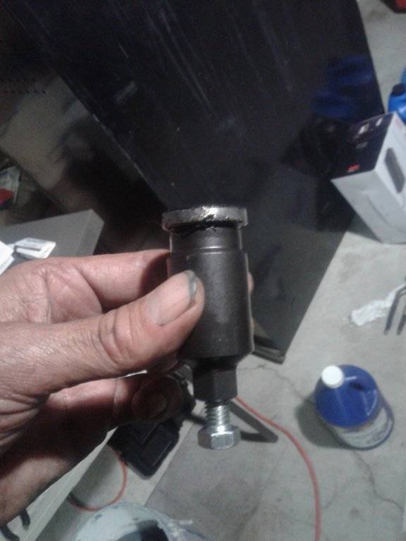

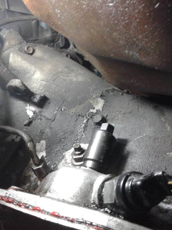

Step 2. Use the extractor tool.
Some cars have clearance issue with the tool. I did not. Pic below shows clearance of extractor tool in my 72 Fury III (360 v8). I had no need to lower the trans mount for clearance although some have mentioned needing to do that.

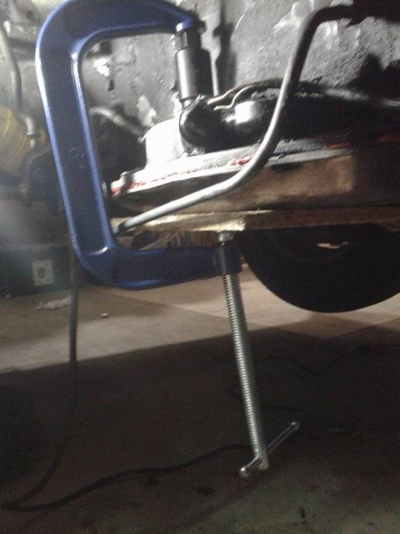

The black tool is supposed to screw down into the seal for grip and then the bolt on top will apply the lift. Remove the bolt from the top because you don't need it until you bite the seal enough. First I tried to just press down as hard as possible while turning with a ratchet. No way!
Thankfully, SAForwardLook provided the c-clamp tip:
... cut a piece of plywood to distribute the load on the pan and use the c-clamp to apply downward pressure on the tool. O.k. this got a bit scary as I had to really clamp HARD while I turned the top of the tool with 5/8th wrench. It took me a couple of tries because I didn't want to overdo it. You know it worked if you remove the clamp and the tool stays solid in the seal.
Once you remove the clamp, insert and turn the top bolt of the tool with 9/16 wrench and ... Eureka!!!

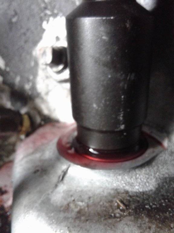

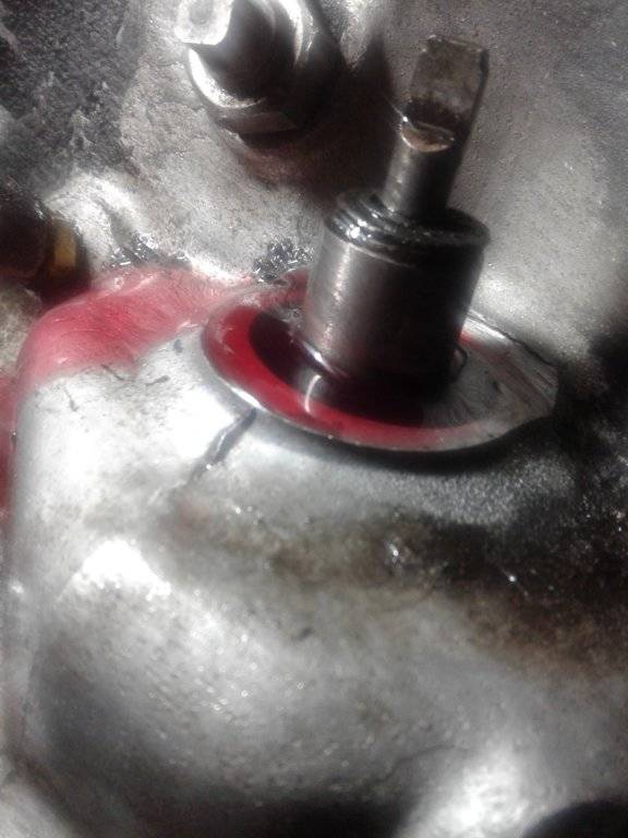

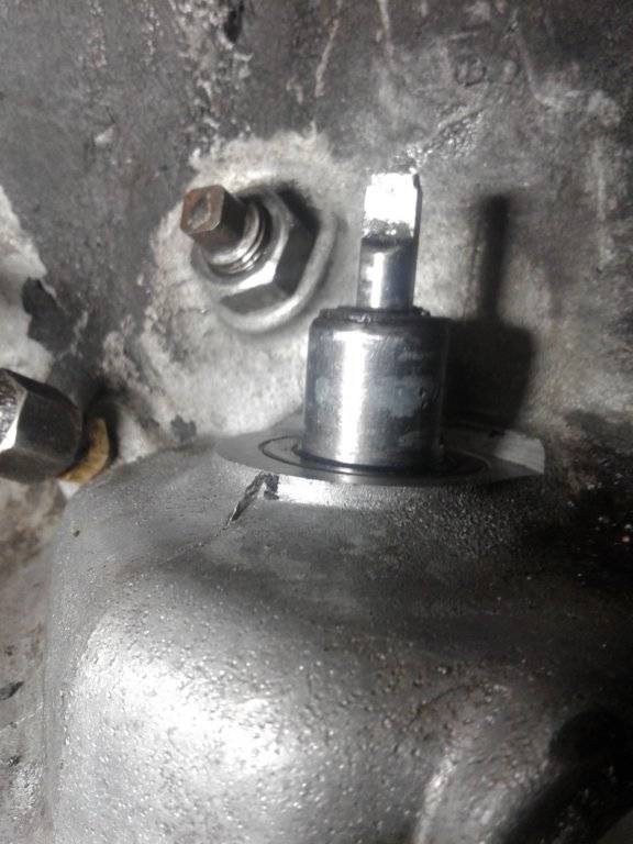

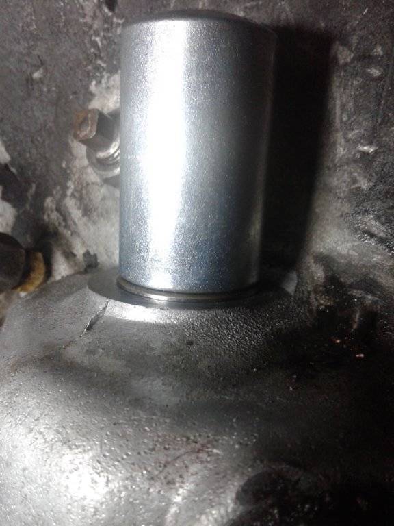

Step 3. Install new seal
One of the pics shows the area with the seal removed and fluid seeping..
The installer tool fits over the rod and it is pretty exact. I was concerned that it would bind on the rod after use and that I would have a hard time taking it off... I tried some emory cloth and even lube and it seemed too tight.. oh well...
Used the c-clamp again to press the seal down with the tool after positioning the seal with my fingers as straight as possible. Worked well and I watched it slowly lower. When it seemed to bottom-out, I removed the tool (using the channel locks) and found that the seal was "almost in" flush. I debated going further because i was afraid of going too far but decided to redo and was able to get it seated flush. Took some bravery so just be careful and patient but you do want the seal flush. One of the pics below shows the tool almost flush and the other shows the completed install.

Really pleased the method worked well for you Mbar. It took me about three fails the first time I tried to use that special tool before honing in on using this method. I have never seen any suggestion such as the one I described. Thank you for the step by step instructions with photos. By the third time you have used that tool, the job goes very quickly, with the most time taken to get things clean and get the proper tools in place to use and the car jacked up with jackstands in place.

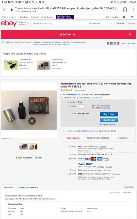

I am very happy that you saw this, as I wanted to give you proper credit for the C-clamp tip. Without the C-clamp it would have been a crying session..I did read the reviews on the ebay post and more than one person indicated they couldn't get the tool to bite the seal...maybe if I get time I will write to the seller and suggest he provide this tip...
