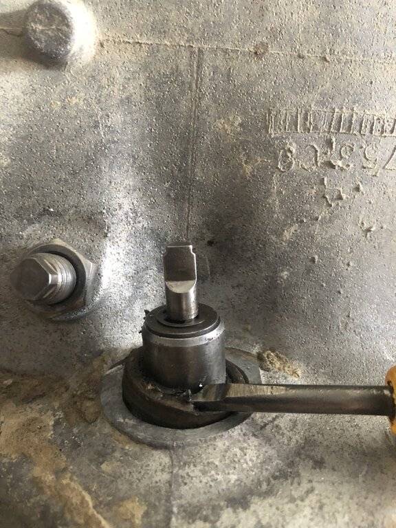

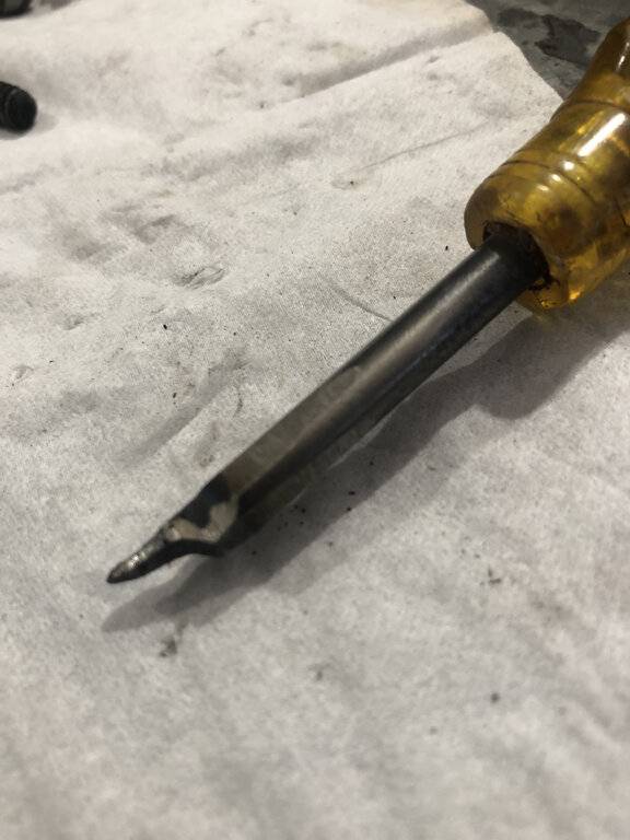

Hello thought I would add another simple way for doing this, just did it on mine after reading about needing a special tool. I did not want to remove the pan AGAIN either (after thinking that was the cause of the red wet spot-)
I took this angle drill attachment I have and with the help of a small mirror drilled a hole in the seal and pried it out with a small screwdriver. Pressed the new one back in with a socket and a C-clamp. Went pretty easy. No more leak.
