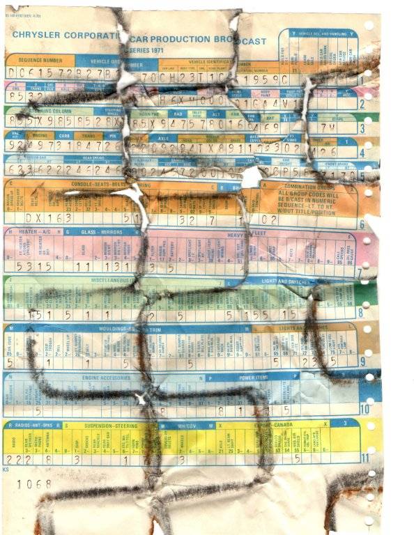

Assistance, please:
Hmm? Middle of line 5 there is a section for Labels, in 69 it was IDLE and TIRE, looks like the 71 is VEC and TIRE. No idea what VEC is, on the 69 the code is the last two digits of the part number on the label.
Edit: That looks like it might be 45? that might be it.
Alan
I didn't realize that was on the broadcast sheet. VEC stands for vehicle emission control label I would assume as well. When enlarging John's image of his broadcast sheet for his New Yorker, it does show 49 as the last two digits of the number on the VEC, which are the last two digits on all of my 440 std engine labels for 71s not originally built for California. So it all comports and I believe that John should just go back to the same DMV and get it updated with the correct label in place (and maybe take his broadcast sheet just in case any further pushback comes up for some reason).
