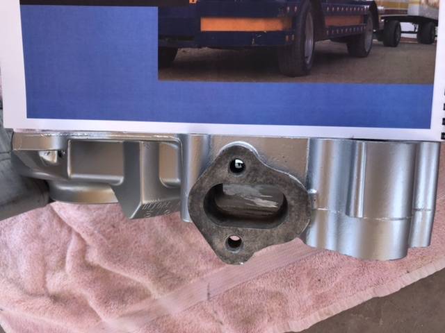

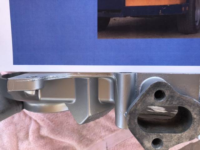

And this is my attempt to show the bend- finding something perfectly straight in Mexico is not easy (huhu) so that magazine page was the best I could do
We did, btw, verify the bend at the machine shop with both a flat metal table and metal straightedge

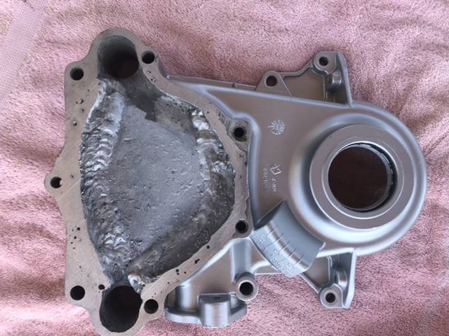

Looks like a 68-69 cover to me.

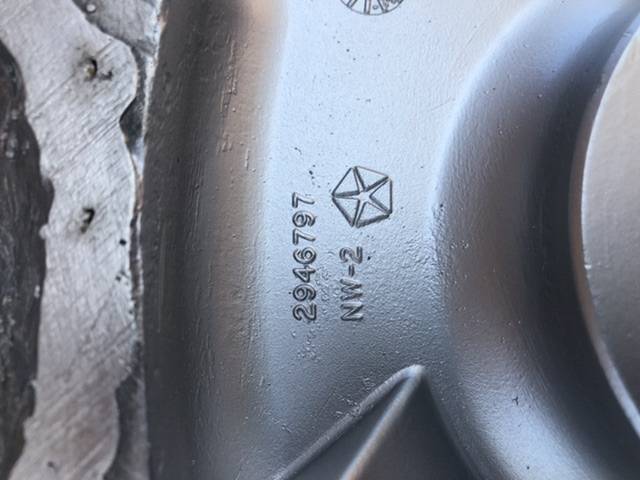

The number appears to just be a casting number, but that doesn't surprise me. Google it and you come up with all sorts of used ones.
Definitely a 68-69 cover. If those are welds I see then that's how it got warped.
They are indeed welds. The first guy I took it to was supposed to fill a small pin hole. He then took it upon himself to add a ton of material all over, some of which spilled onto the mating surface of the water pump. Then he took it upon himself to grind it “flat” with a hand grinder. And did a hack job.
At that point it went to the machine shop to hav the water pump face surfaced.
I was really convinced the machine shop had bent the part with the clamp as BigJohn had thought but now maybe he would agree the heat from all the welding is the culprit. I hadn’t considered that until you mentioned it.
If you can see at all with my Mexican straightedge the amount of curve do you think it is crazy to mount that thing?

It's not crazy to mount it to seal the front of the engine and protect those components from damage during storage, BUT it is (probably) crazy to mount a warped cover and expect to be able to seal it. Put a new one on next year when preparing the car for use.

In that case, just bolt it on for now. Find another and use that.
