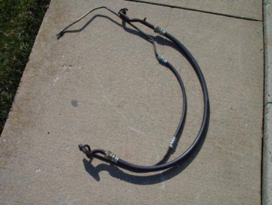

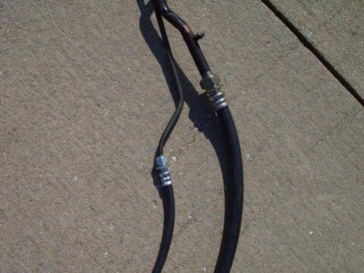

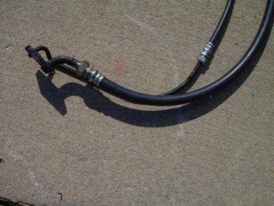

No, you keep everything like it is. You'll have to change the receiver drier for sure. I would replace all the O-rings (because they are 40 years old) and the metal gaskets on both sides of the hoses that bolt to the compressor. I also would replace the H-Block (which is pretty cheap - $15 IIRC). I had my hoses rebuilt in a hydraulic shop in Delaware ($200). I had to replace my condenser because it was cracked. I found a new repop in California. I flushed the system and used ester oil. I used 35 ounces of R134A which is 80% of the R12 capacity. And I get 40 degrees at the center vent.

OEM hoses are very hard to find. Having them redone at a hydraulic shop is the economical way to go. The receiver dryer will be near the condenser....it looks like a filter with a steel line going in and another going out.

I used Benz Hydraulics in Delaware. Expert work and they had my hoses done in less than 24 hours. I'm sure you can Fedex/UPS your hoses to them. They reused my old ends....I'm very satisfied with their work.
