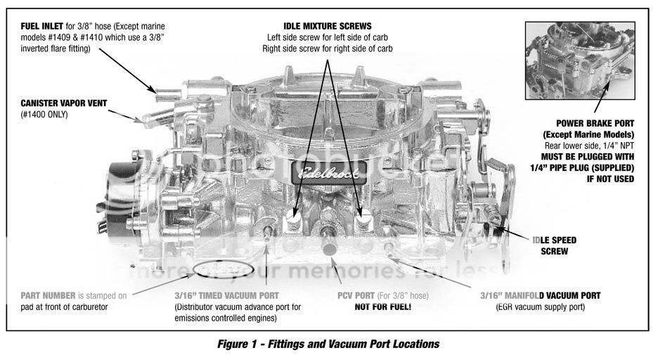

Looks like an Edelbrock 4bbl carb to me.
Here's where to find the part number.
