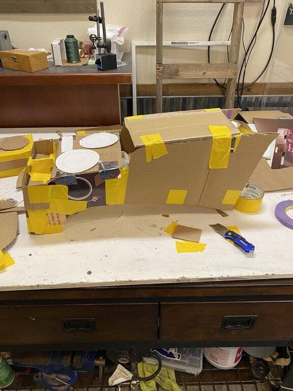

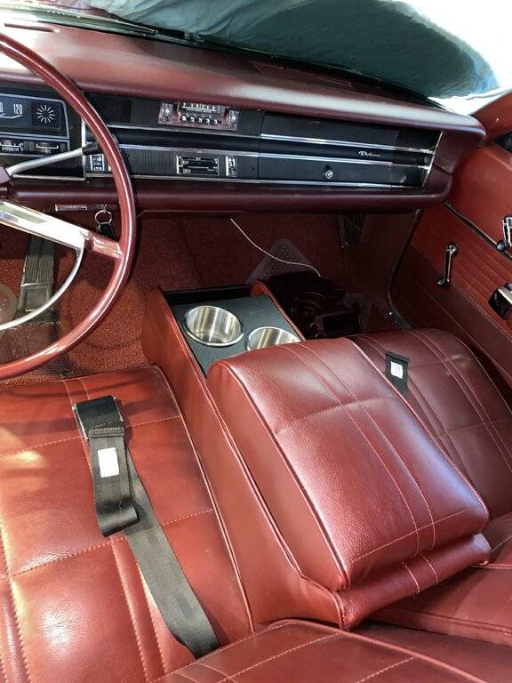

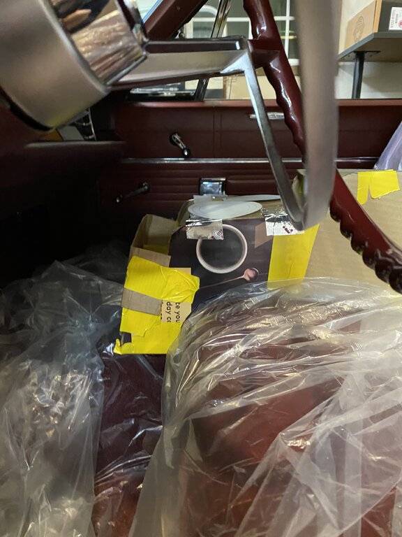

Last picture gave me some ideas. I don’t need 3 cup holders. Maybe I can shrink the lower leg even more.
This is becoming a Heinz 57 or WD-40. This is about BSC-15. Bench Seat Console iteration 15.

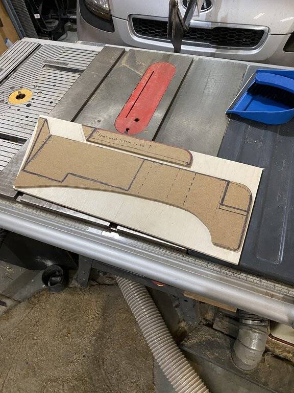

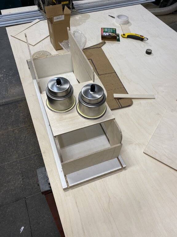

I need/ want to have my cup holders on the second level, and put a tray/cell phone holder closer to the dash. I can reduce the bulkiness even further. I think I am ready to start tracing the edge profile to a hardboard template. I think I will use 1/4” Baltic birch plywood. Very stable and consistent. Plus unlike hard board it retains staples and fasteners better than hardboard.

I may look in a couple of my vehicles and see what removable trays they have. If I find one that fits I can either order one or find something in a junk yard. I may have to experiment.

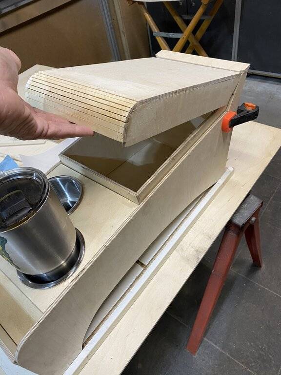

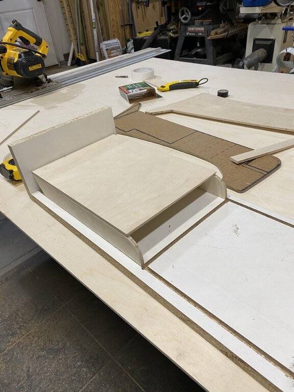

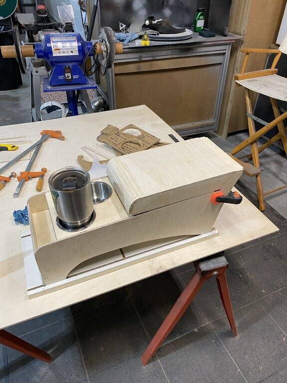

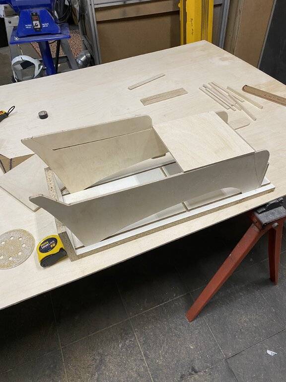

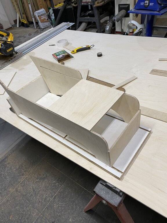

I got my main pieces cut and mad a jig. I haven’t used my router table for about 4-5 years likely.
The jig is slotted to help hold the sides in the right orientation for glueup. I almost have my radius figured out. I also need to figure out how to keep it closed (magnet?) and a slot to lift the lid.

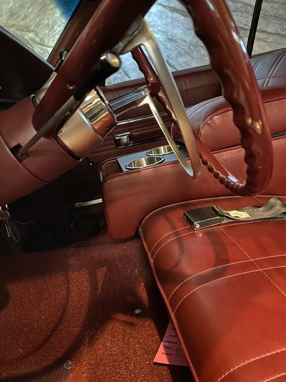

Yes the lower dash cell phone holder works great on these ‘68s. W wish modern vehicles had such a shelf. I use my phone for navigation all the time, some vehicles are more friendly for this than others. When I take on a project I do tend to get a little carried away with perfection. But when I am building stuff like this or detailing a part nobody sees, I like the creative exercise of figuring out how it may have been done originally or how it should have been done ti look professional. Best therapy in the world for me.
My challenge on the box will be how to hide the staples on the vinyl whether the box is installed or laying on it’s side in the trunk. I have some ideas to experiment with.

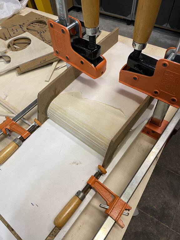

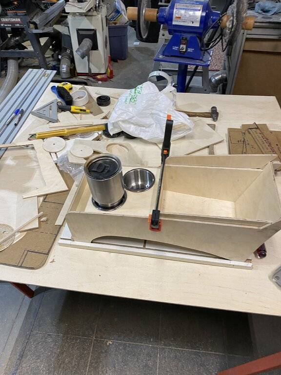

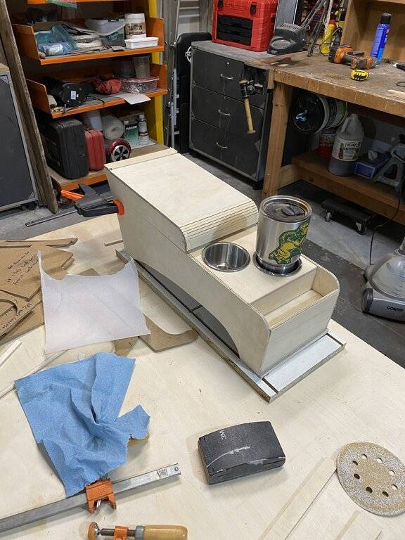

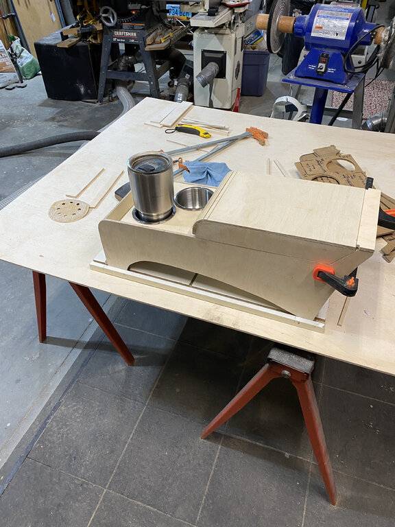

Making some progress. I also created templates in case a wanted to do another. I just have to double sided tape them to the wood and use my router table to cut out.

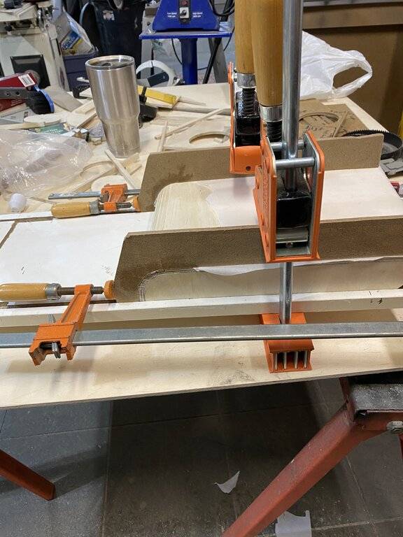

I figured out my top, I cut small strips to to follow the radius and then used my topside template to create a negative to use to clamp while gluing. Also drilled my cup holes. Now it is almost time to figure out the covering before final glue up.

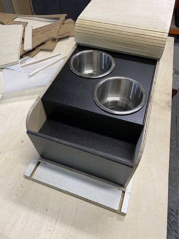

I think I am going to cover the top and sides with vinyl, but may do the cup holder top and front pocket with undercoating to give it a rubbery feeling. I may paint the undercoating the same Aztec maroon suede as my dash. I can work with black, argent, or burgundy to match the current dash.

Original internet is to cover the sides as well and the top face of the cup holder and pockets will be black. I am liking the look and texture of the undercoating, plus it should be easy to clean.

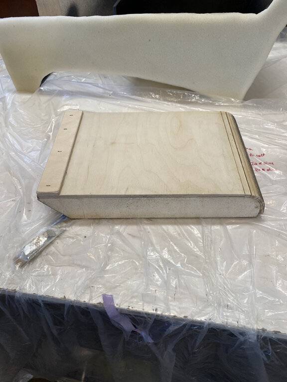

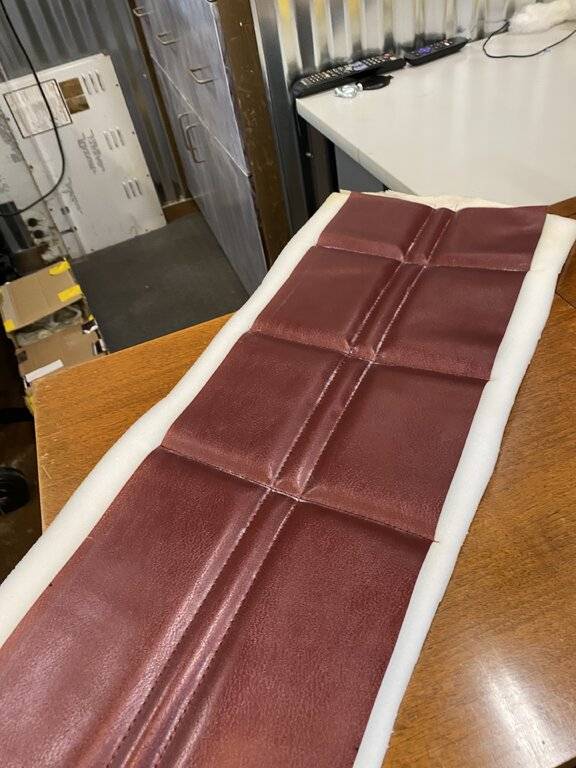

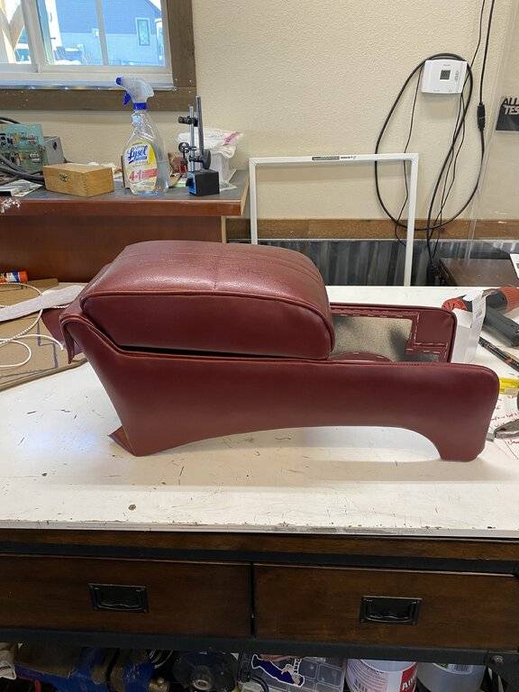

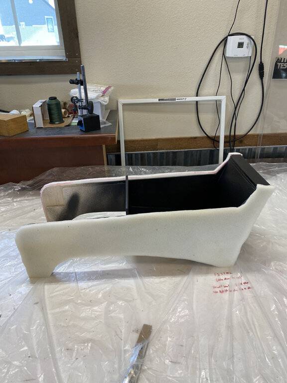

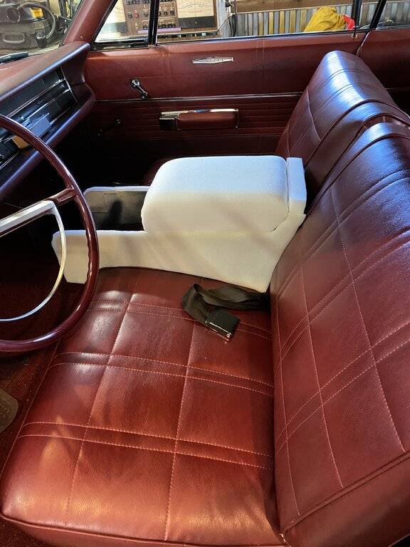

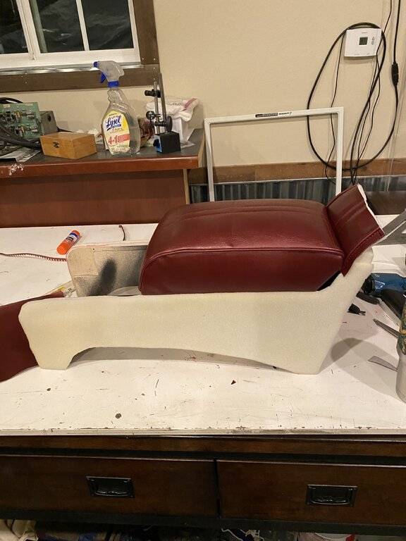

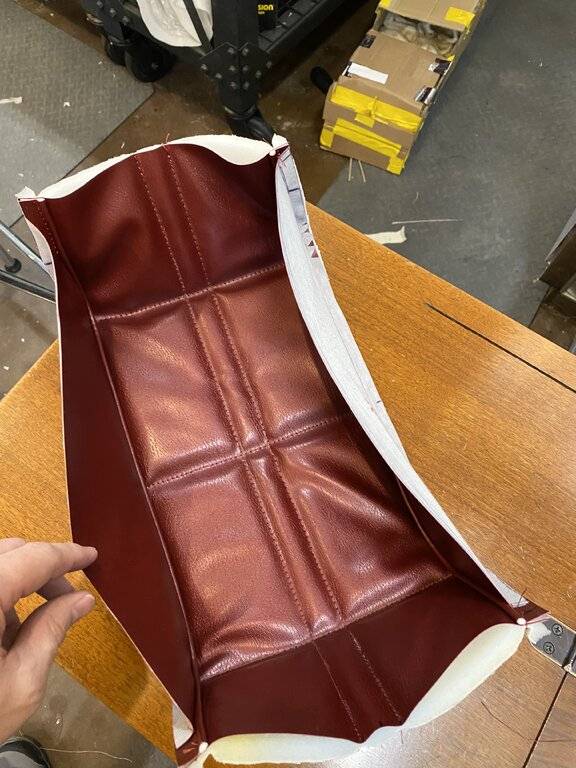

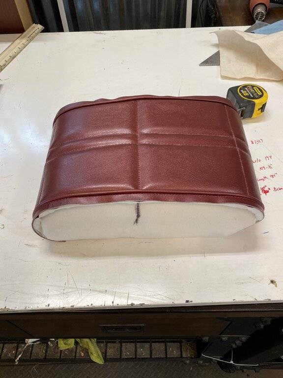

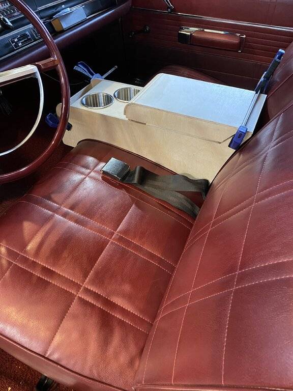

Glue up complete and padding installed. Now on to upholstery. With the rounded corners I don’t want to just pull it around and have tucks in the vinyl. I think a little sewing is in order to make it like a glove around the edges. Now my dilemma is to decide if I want to incorporate cording into the seams. On the seat all the seams are corded, so maybe I will follow.

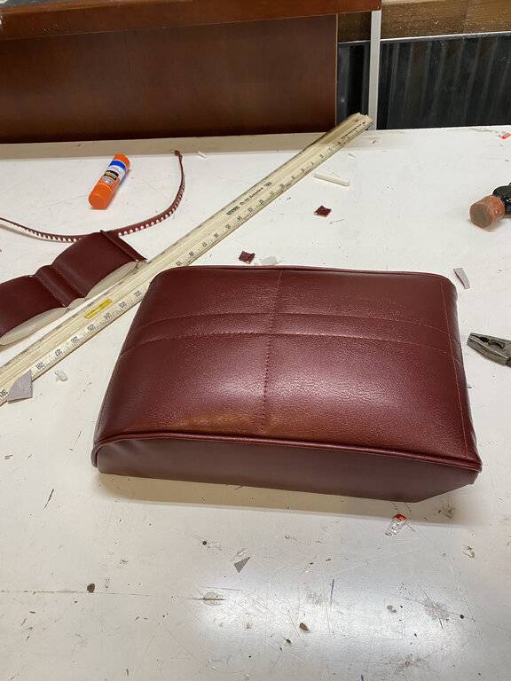

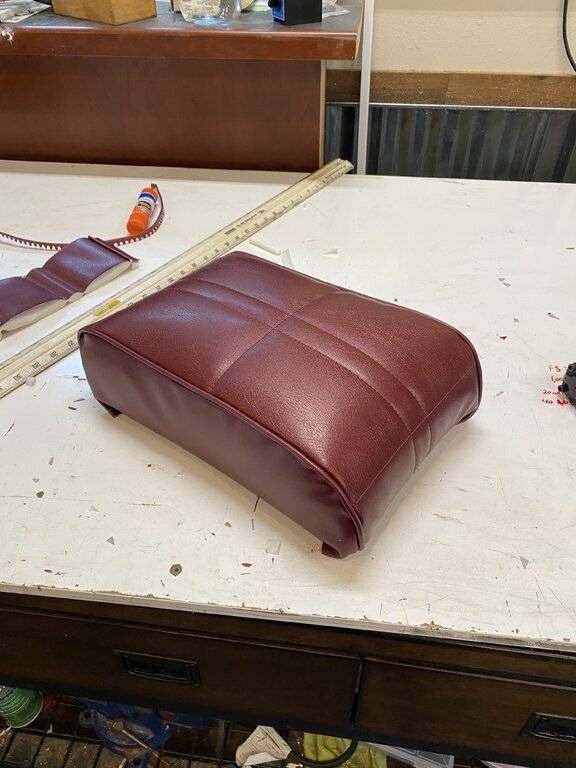

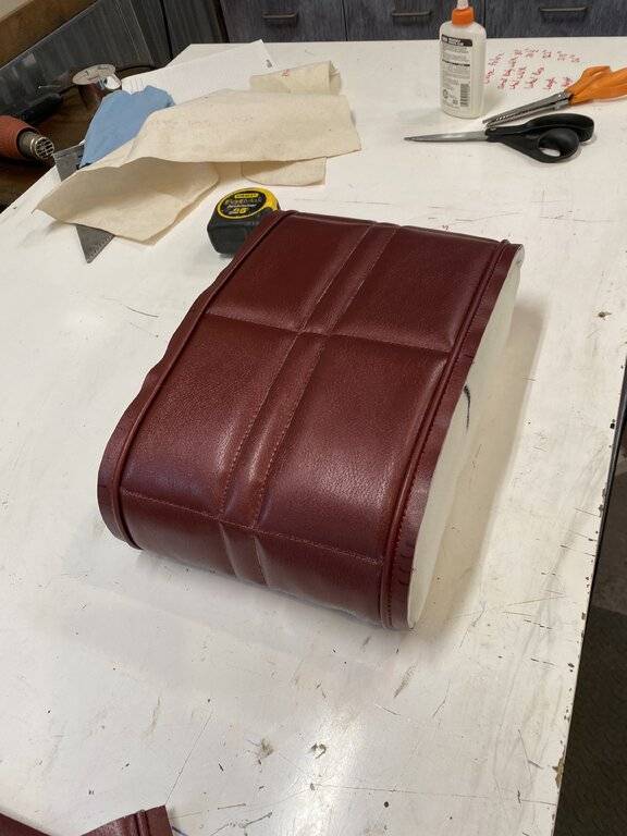

I decided to make the top armrest part match my seat pattern. A more complicated, but looks better. The sides should be easier.

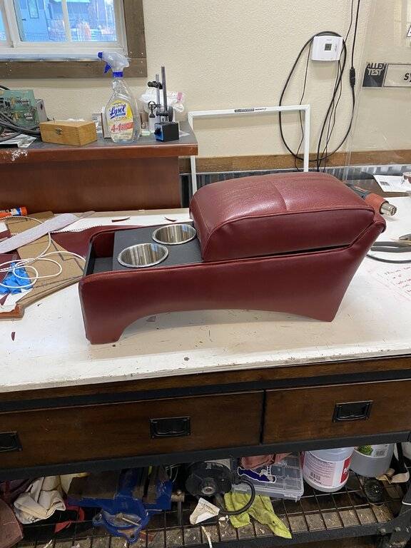

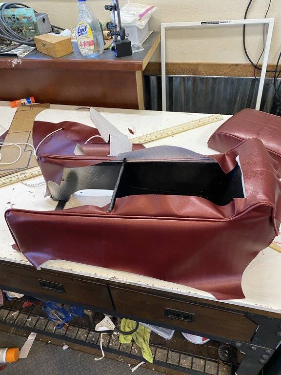

I have it all covered. I see why they charge around $130-$150 for the simple ones. There was a a lot of time involved.
Next I need to go to plan B for the box hinges. I had a small piano hinge, but needs a little more spacing with the padding.

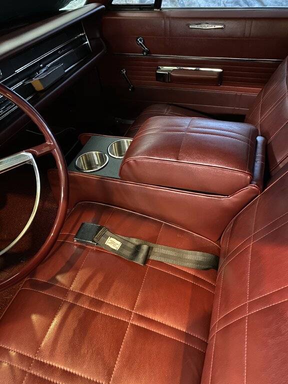

I am liking the way it turned out. Now for the final touches.
Nice work Marty! I like how you incorporated the seat pattern into the lid, big improvement on a very good design.
Are you going to start taking orders now? I bet a few other guy's would want one. It turned out great.:thumbsup:
