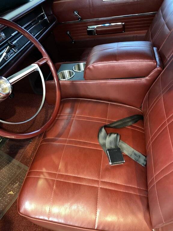

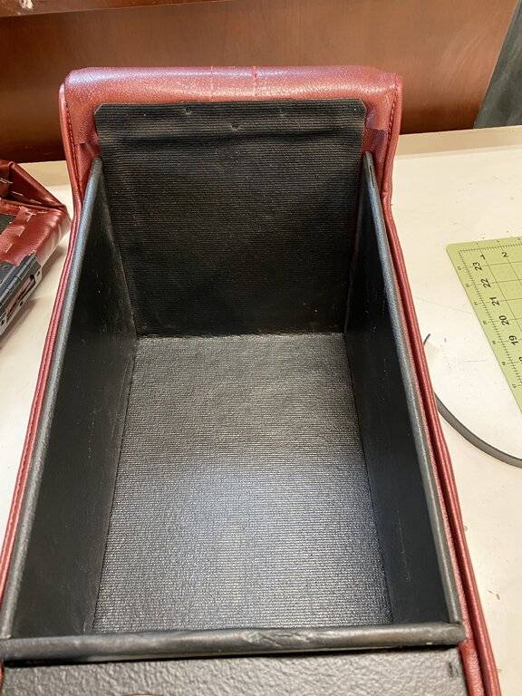

Putting some finishing touches on the console.
Hinge on. I had to offset it by about 3/8” to get the right clearance and closing. The lid actually has a good friction fit. Not sure if I will add a catch or not.
Also added some neoprene to the bottom so it won’t slide around and added to the bottom of the compartments. Now I need to find the right hooks for elastic cords so it doesn’t get launched forward if I slam my brakes.
Man, Hadn't check in in a while. Nice work. Cup holders AND it puts the arm rest/lid part up where it can be useful.... that's two major points over fact'ry, rite der.
Awesome work!

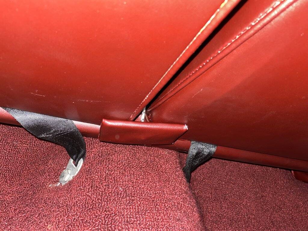

How does folding the seat forward to access the rear seat work with the console?
Great if it isn’t strapped down.

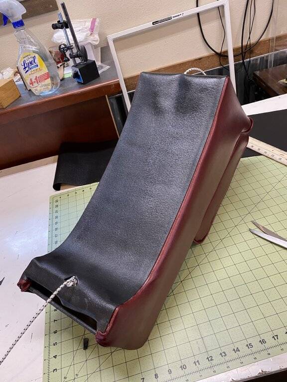

I still haven’t found the right hooks for my little bungee tie downs. I should have enough slack that I can slide it over 1/2 way to fold the seat back forward and still be tight enough that it doesn’t launch forward or roll around. With the rubber drawer lining on the bottom (and a little over spray from the adhesive) it really doesn’t move around much, but want to secure it for panic braking.
Actually that got me thinking.

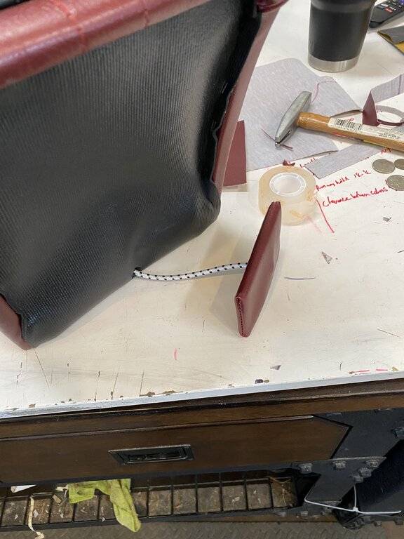

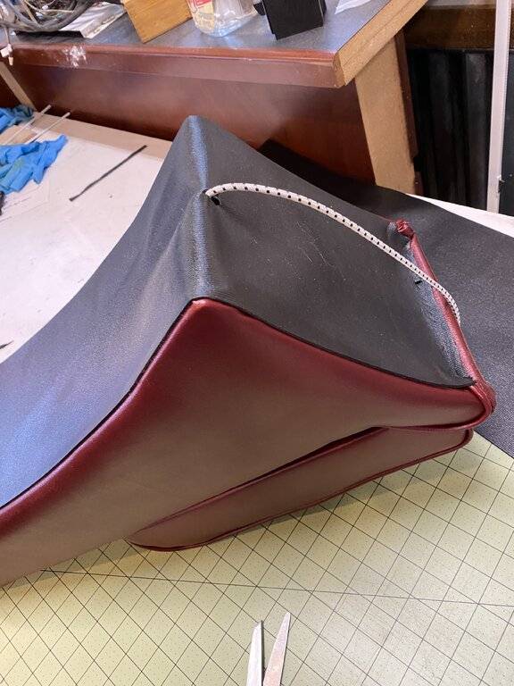

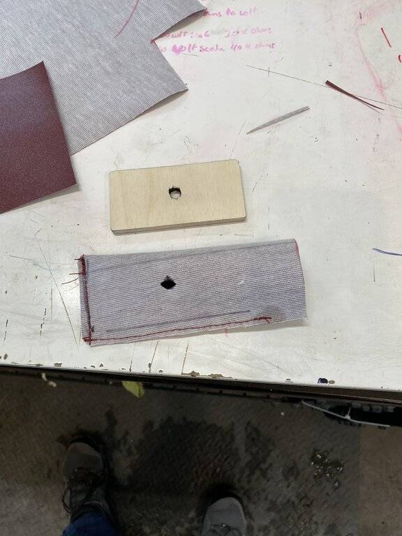

Maybe instead of a hook on the back where I have to reach over the seat to secure, I could do some sort of T-bar on the back tied to the bungee to secure. Turn it sideways to slide through the seat split and then rotate it 90 degrees across the split. Also easier to un hook. Hmmm. A weekend project.
Added a rear strap to keep it from launching forward. I used my T-bar idea, it seems to work out pretty good. I can either slide it down the split or turn it sideways to remove.
