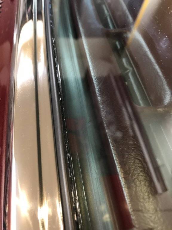

Thanks for posting the instruction. Doesn't look like something that can be done without removing the windshield again.
The after market instructions are for after the install. I envision a flat tip on a tube of 3M, that you would insert between the glass and seal (outside) in the channel and go all around. Press down the seal to the glass to squeeze out excess and wipe it down. I think they can do it with out even removing the trim. Although removing the outside trim would maybe allow the seal to open wider from the glass.
Now I have to look in the FSM to see what it says for my car! It's like they have everything in there.
Windshield sealed between the glass and rubber on the outside. Should keep water out as well. He also applied a little more sealer to my bottom rear window corner. Should be waterproof now.
I removed the bottom molding which allows it to open up a little. He took a small plastic putty knife to open the channel so the tube nozzle would fit in there and ran it around. He used tape on the seal and glass to keep the clear sealer from getting everywhere.
