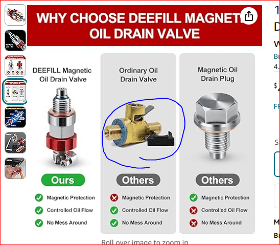

“Easy” oil change drain plug
Haven't seen one. As long as it stays tight and doesn't hang down far enough to get caught on road debris it might work well and be pretty handy.
IMHO, there's not much to gain. You still have to crawl under the car... and now you have more to go wrong and leak or come undone and dump your oil.
I can see the long-term benefit as many drain plugs have become "cast" rather than machined. Being softer, they will wear with time. Then consider that the bung (with the threads) is a thinner nut spot-welded to the inside of the oil pan. MAYBE THREE full threads in it. Not quite as substantial as suspected!

I have a Valvomax drain valve on my '67 300, and all of our other vehicles. Makes oil changes clean and easy, even when the oil is hot. Been using these valves for well over 5 years without a problem. Highly, highly recommend. As I recall it's a veteran-owned company, and they make the valve in the USA.
[/URL]
Excellent! Made in the good ol’ USA! And veteran owned to boot!
Amazon.com On Amazon too.
Dorman offers, or maybe still offers, something similar. I've sold tons of them, with no customer complaints. As far as the dumbest design ever offered by Ford, find something to replace it with. In this day and age to design a one time use plastic drain plug, that can't degrade over time and it's covered in oil! Make absolutely no sense. Not to mention when the design was brand new, you could only buy one from the dealer and they were near 20 bucks. Shitty all around.
$45? How hard is it to remove the drain plug? Been at it for 100++ years and still works.
