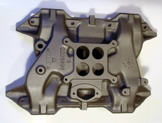

You will need the adapter if you took a Thermoquad or other such spreadbore carb off that intake. If it looks like this yes..
No if it looks like this....

Some of the big blocks had the spread bore intake and thremoquad. The big block Thremoquads had bigger primaries than the small block Thremoquad.
