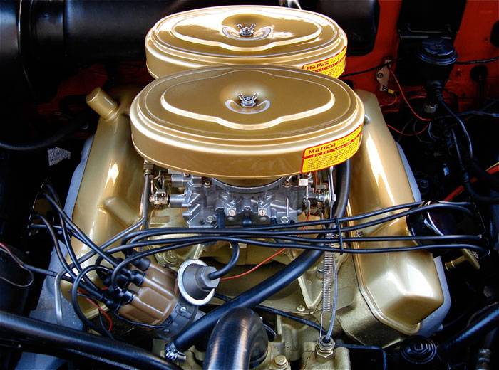

1957-58 Plymouth build
The early 383's were painted turquoise for the Mopars.
But Jensen painted them black with silver covers, for some strange reason?
Not my favourite colour but its original for Jensen CV8, Interceptor etc...

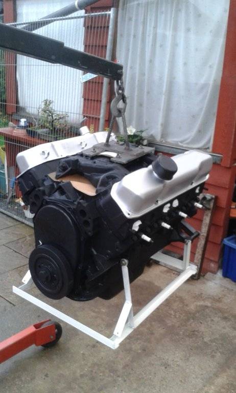

This is another 1964 Cv8 engine I did a few years back.
As you probably know the 350ci was a 4 1/8 bore bigblock.
Which grew to 361 the following year and then in 62 up to 383ci.
That was the same block just bored out!
I have one of these early 361 into 383 blocks with the correct heads which are 4 bolt covers.
These are different to the 64 on head castings which are 6 bolt covers.
Not sure how original you want to be?
Unfortunately I did have the 8 barrel manifold which was fitted to Facel Vega engine, but I sold it...:realcrazy::BangHead:
Anyways what I would like to offer you is 'a BIG BLOCK' engine from England.
I have a garage full of engines from Mild to Wild lol...
As a lifelong collector and builder of Mopar engines I have some spare!
Just finished a first year 383ci engine 62/63 for a Jensen Cv8 but the owner has fallen on hard times!
If you are interested I can send it to you for a nominal fee...:thumbsup:

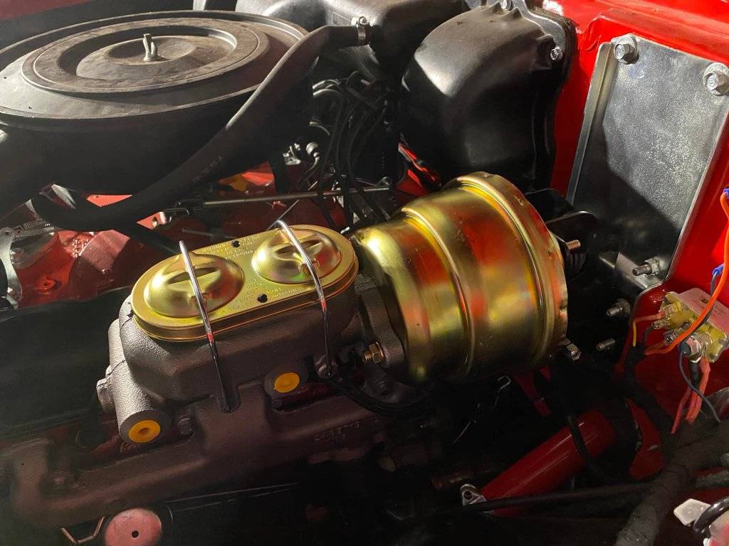

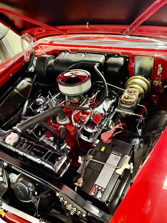

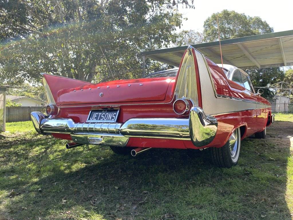

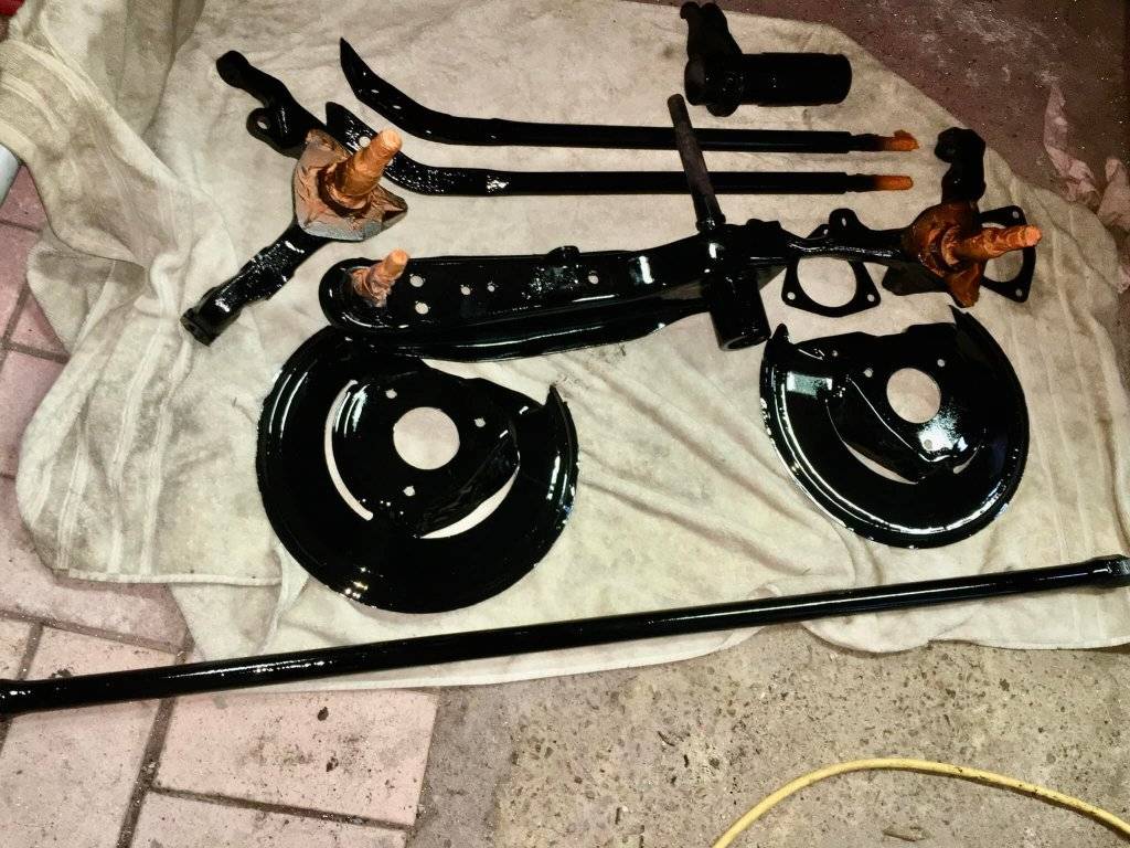

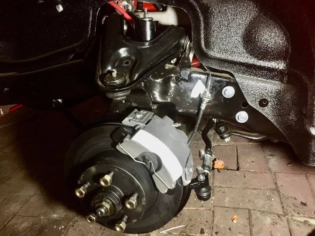

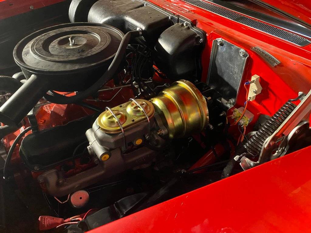

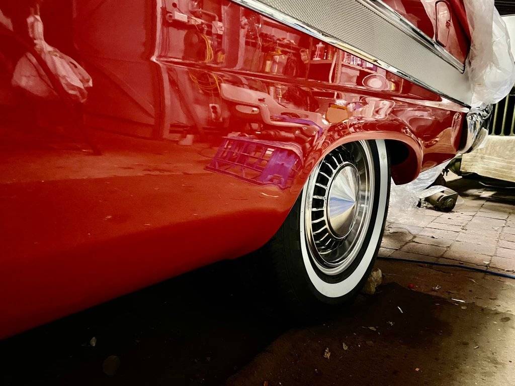

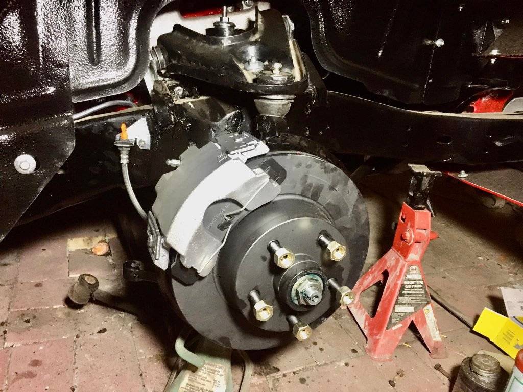

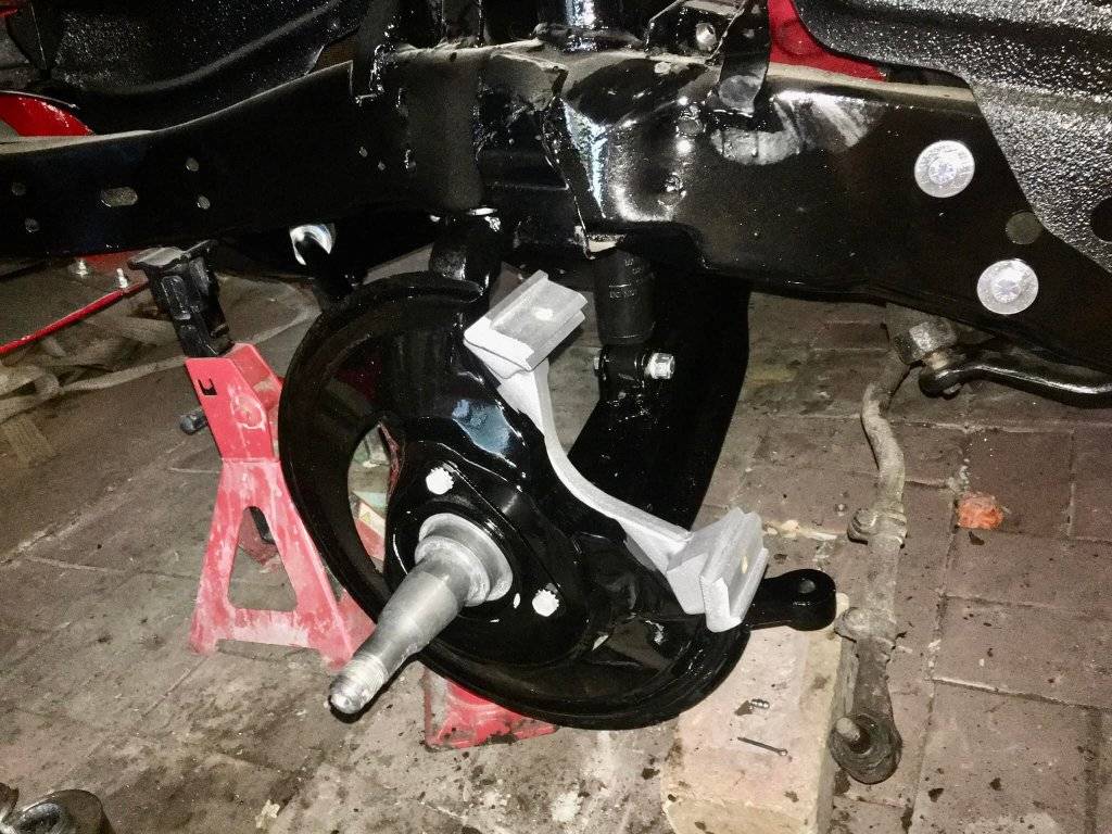

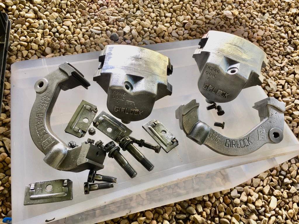

A little more progress on the Plymouth this month. I have been setting up some front disc brakes on it. I am using a local ford set up which only required a little modification. I also changed out the upper control arms for 1960 Dodge phoenix ones, again just with a little modification but gives me better upper control arm bushes. I am using a 65 fury rear end with standard 2 inch drums and a modern booster set up. All seems too work pretty nice so far. Also fitted a new set of tyres. I am running 15s on it with 70-71 fury caps. I have a set of 14's i am sorting and will eventually go with them and original caps when i can afford it. Large 3 inch white walls here run at around $700 a pop so i am content for now with the ones I have on it as I would like to get it going and enjoy it and change things as I go.
Thanks for the updates! Are the Ford Girlock brake items unique to Oz or are they also in other areas, too? Perhaps a more in-depth thread on that aspect of things and what you did to make them work? The whitewalls and wheel covers look neat, too!
Enjoy!
CBODY67
Enjoy!
CBODY67
I think these ones are a local set up from around 1972. I know they are an easy bolt on upgrade for a mustang so maybe a US early 70's unit would be close too?

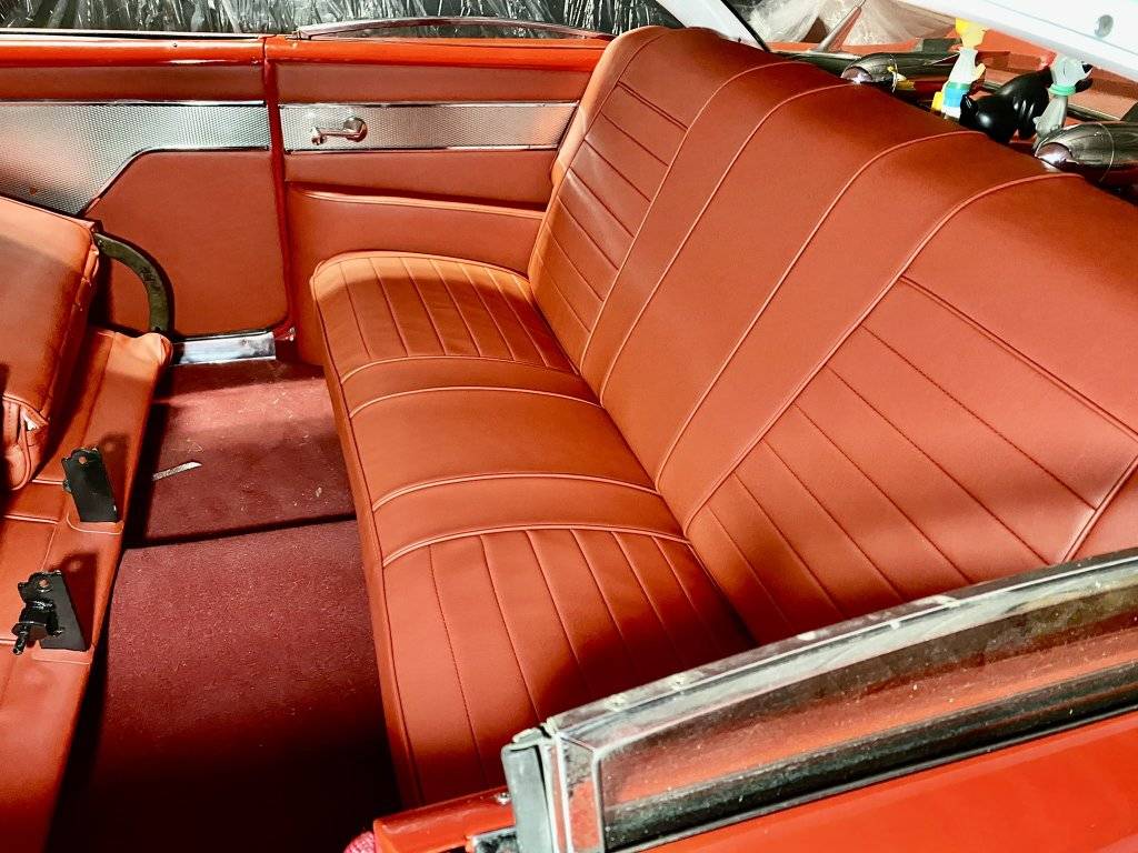

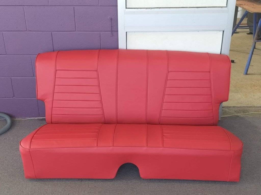

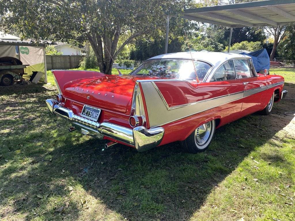

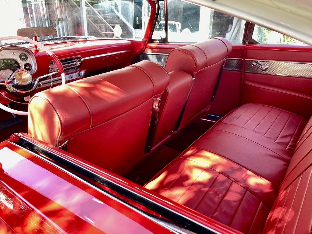

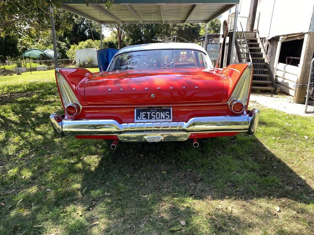

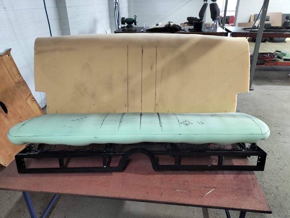

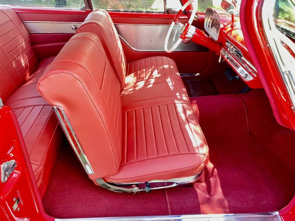

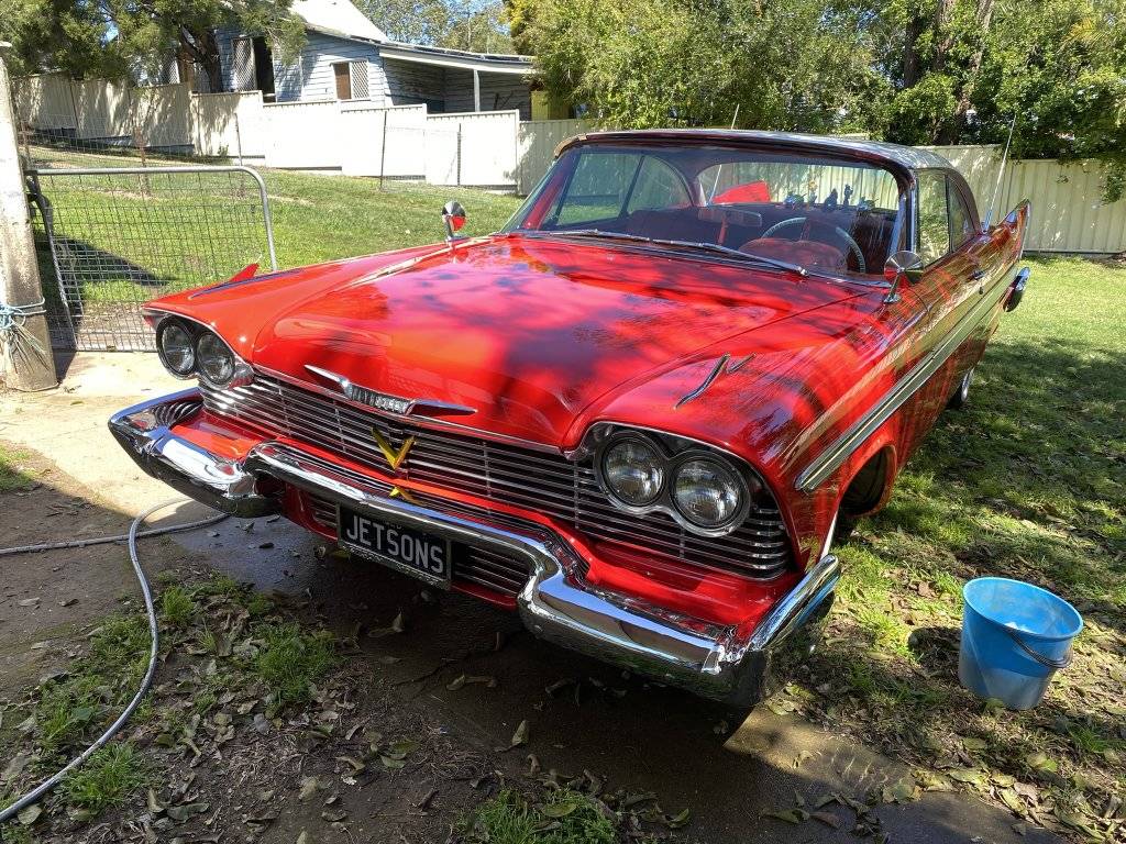

Just about finished the interior over the last couple of months. Just waiting on some chrome trims and some window seals before I get it registered.

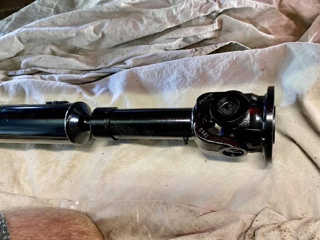

Turns out the ball and trunion had heaps of play so I had a local drive shaft shop do away with it for a slip joint set up. Works very well. Car is registered now but still have a bit to iron out. Fuel tank o-ring is leaking so waiting for a new one to arrive. Also some other teething issues. Need to find a set of the large ribbed gutter stainless for the roof yet and some 58 dog leg molds.

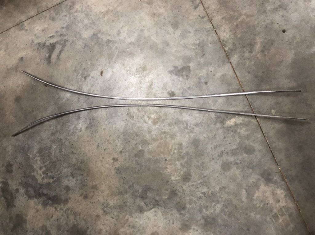

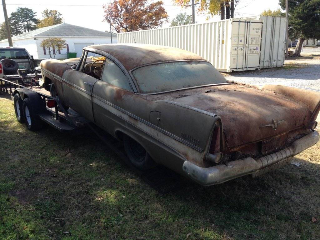

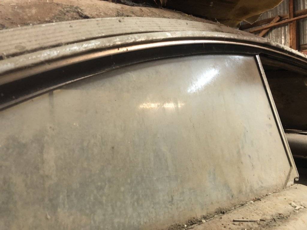

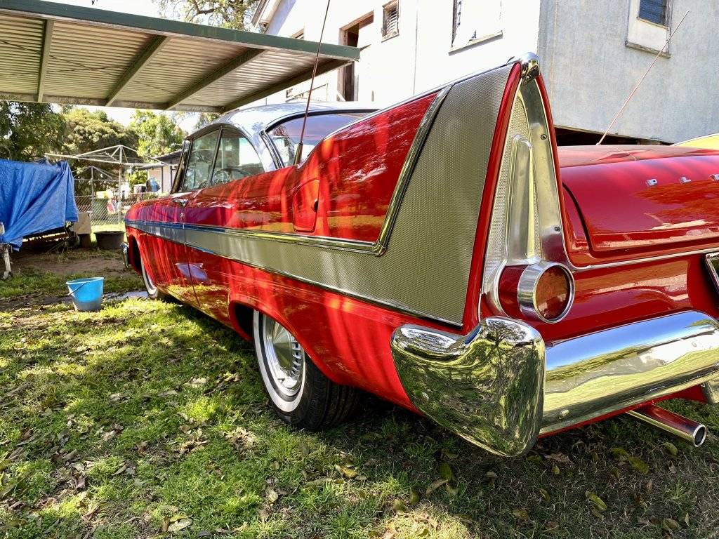

I have 2 pairs of the ribbed roof trim and I'll only need one. One pair is still on the parts car (pictured) and has years of filth on them, the other I bought years ago and stashed away, I think the only issue on those were rusted mount studs. Let me know if your interested and I'll take a better look at them.
Also, did you straighten the '57 lower quarter panel sportone trim ends, or did you replace it with '58 trim?
Hi mate, I would deffinelty be interested in them. The bottom ones I cut the last foot and a half of each trim and tig welded on some sedan strips. The tops were just cut to size. Kind Regards Terry

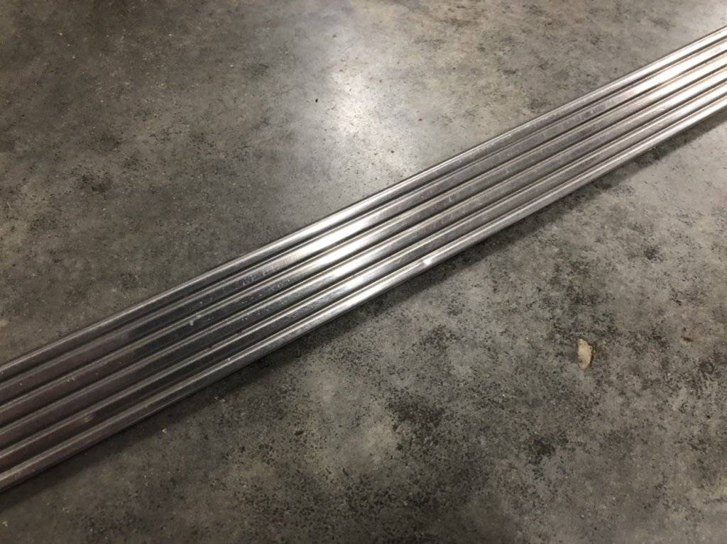

It doesn't look like I can send pics in a private message, so I'll post them here if that's alright. I got to looking at my parts car, and besides the ribbed trim and drip rail trim, it looks like there's some more stainless on the outside of the rubber window channel (see 1st pic).
Pic #1: Parts car showing 3 pieces of stainless
Pic #2: Nick on ribbed trim
Pic #3: Drip rail/rain gutter trim
Pic #4: Bend on drip rail trim
Pic #5: Ribbed trim
