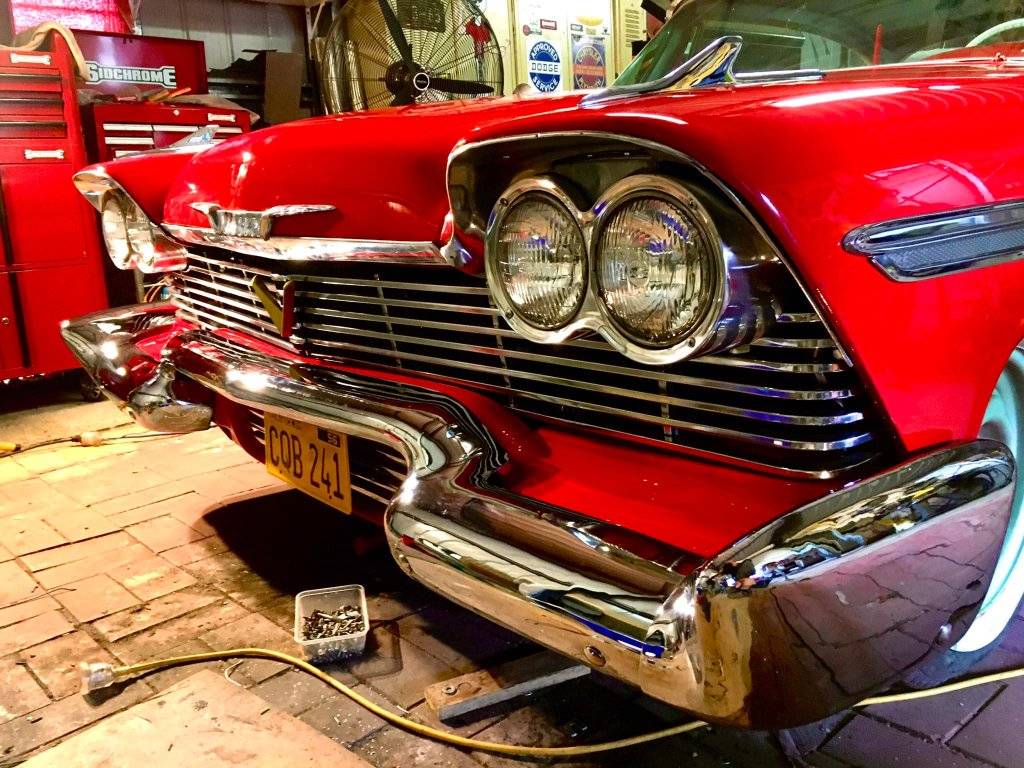

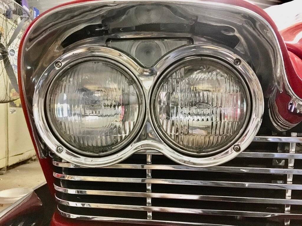

Nice!!! I'm doing the same thing, '57 Savoy to Christine. Did you have to modify the fins any to accept the '58 lights? I thought '58 had a deeper recess towards the bottom.

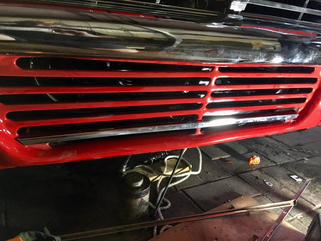

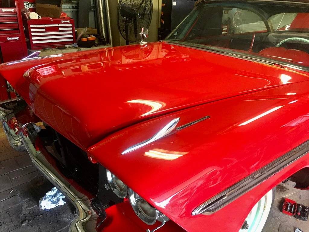

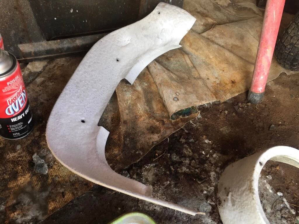

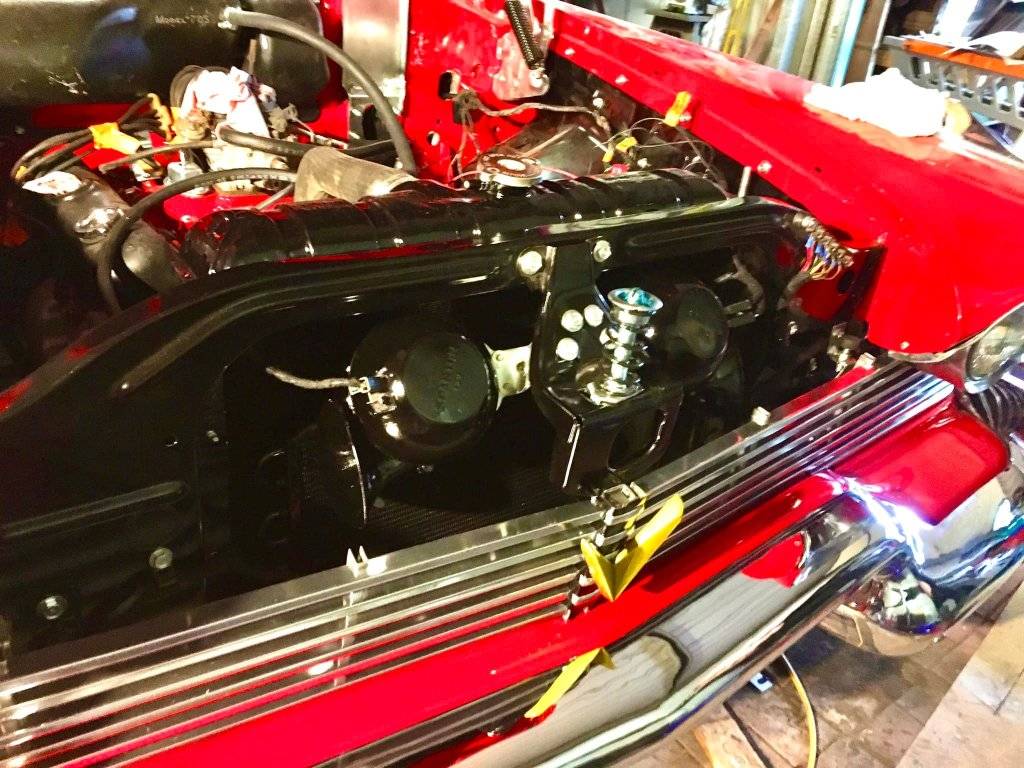

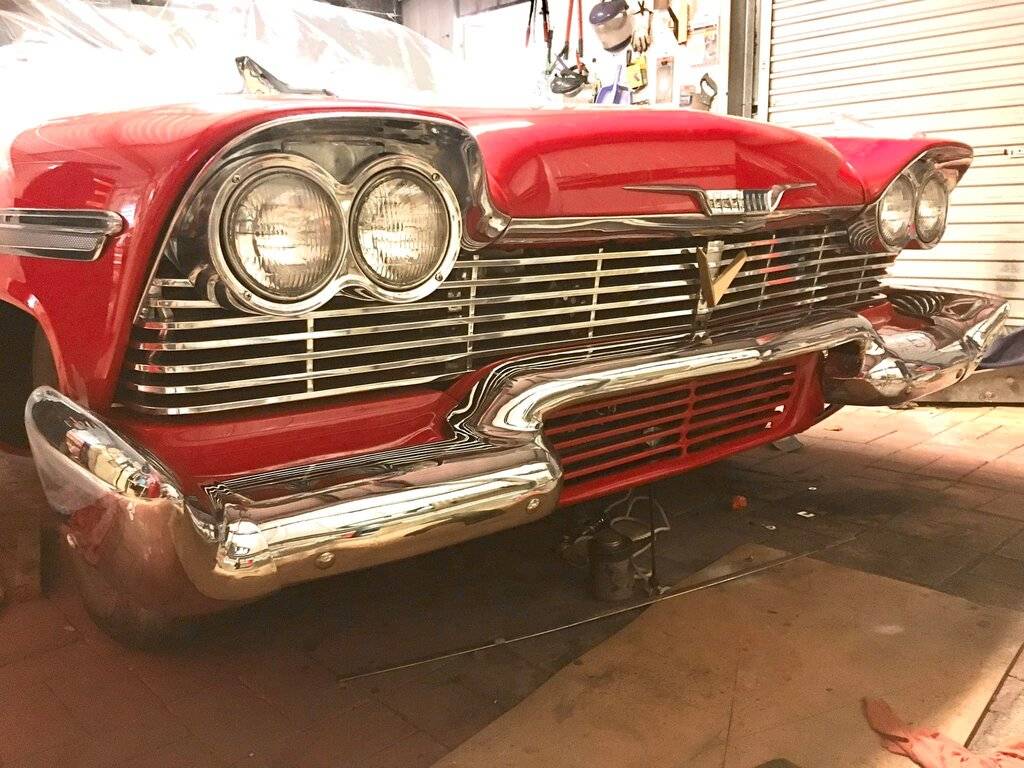

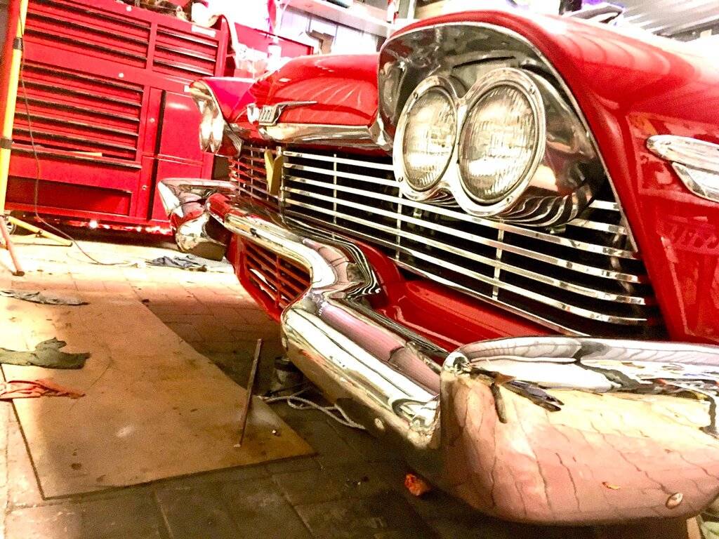

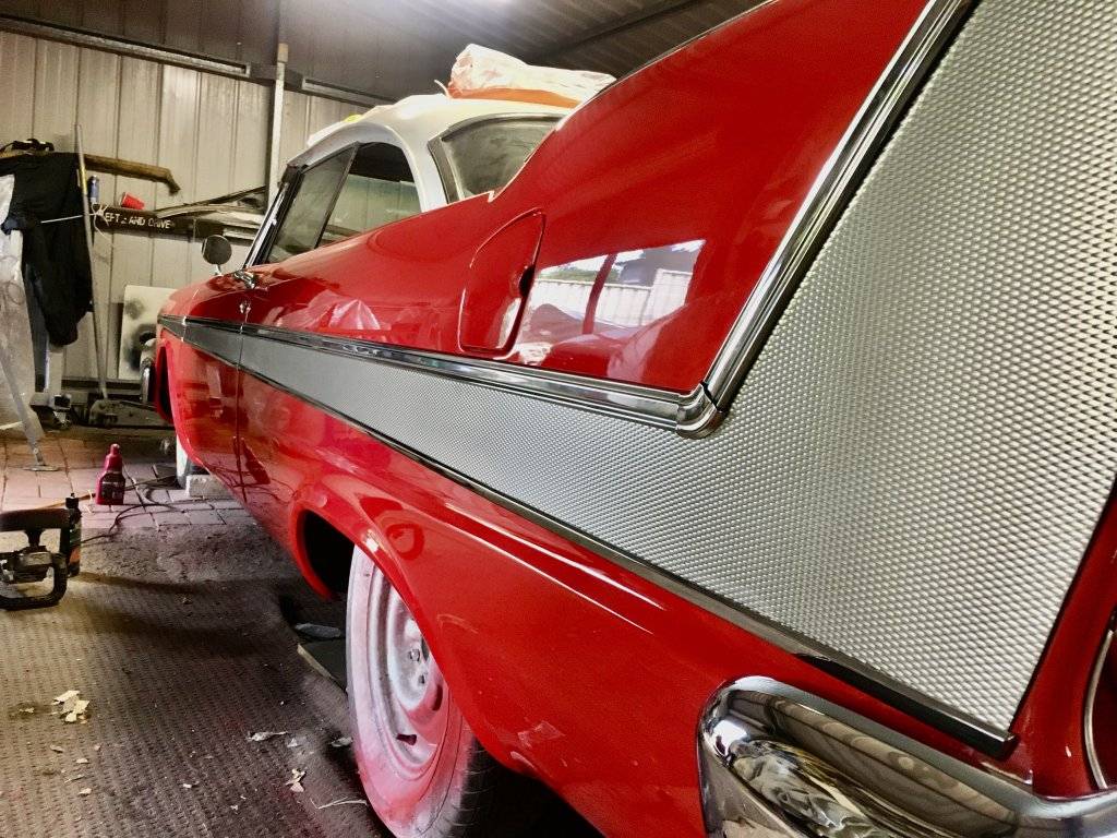

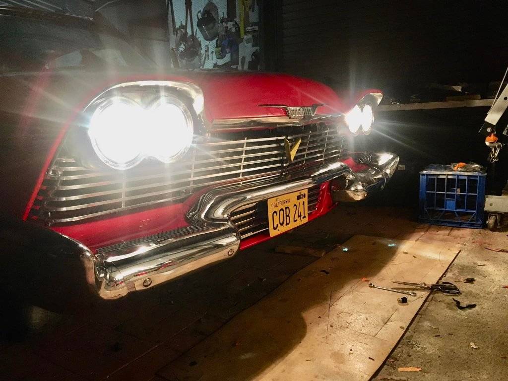

Bit of an update. Slowly sorting the aluminium trims and grille. Everything was quite knocked around so I have just made do with what I have got. Way too expensive for 58 bits these days to be trying to find better stuff. I have just tidied up a 318la engine with push button box for it for the time being till I can afford to build a big block down the track.

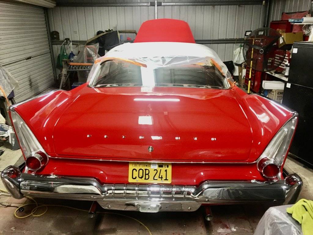

I have spent the last few weeks fully rewiring the car from front to back. Converting everything from 57 to 58 wiring was a slow task but everything works nice. I had to pull things like the wiper motor and switch apart to clean to get them to work. I also made up a set of the lower valance stainless out of some 1963 dodge side trims I had put away. They worked out the perfect width. I am now up to making a new rear seat as the car never came with one. I have a 67 fury sedan rear seat base which i am modifying and seems to be working out good. The back part is a rear seat out of a mates 1960 chrysler coupe. He wanted a seat with an armrest and the 67 fury seat fits in perfectly with no modifications. I have also got the engine up and running but still need to build an exhaust system for it. I still have a heap of stainless bends and tube left over from my pace car build so will utilize those.

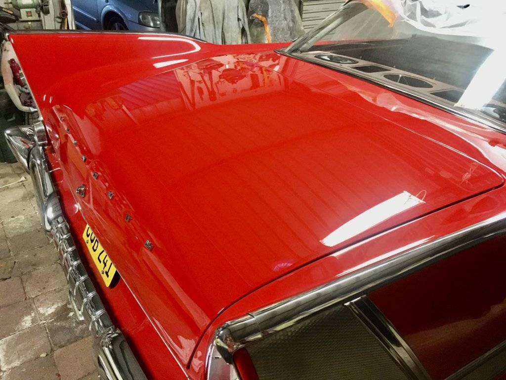

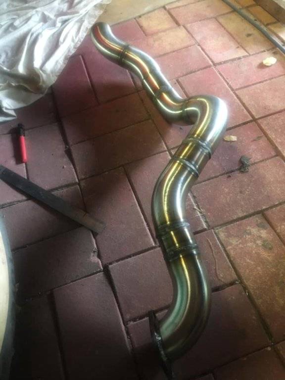

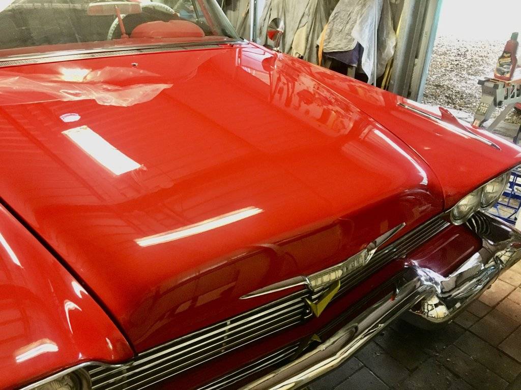

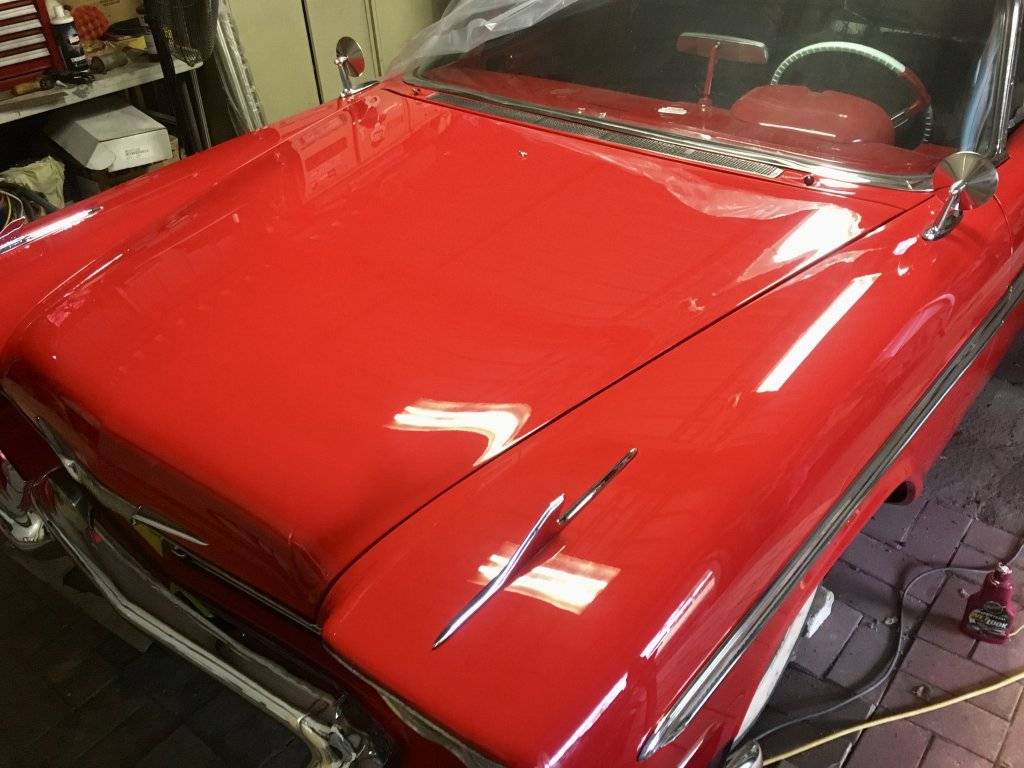

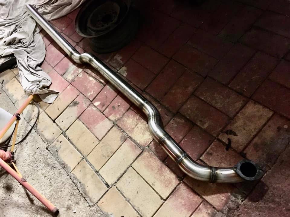

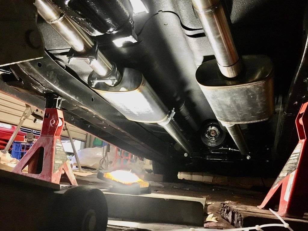

Little bit of progress over the last few months. I built a 2 1/2 inch twin stainless exhaust and got the motor running. Last few days I have been doing a little paint correction now its had 6 months to settle. I have also built a rear seat from scratch which was not a lot of fun but it turned out good. Hopefully onto the brakes and suspension soon when funds permit.
