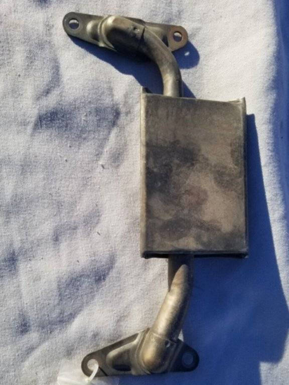

You have a cast iron torqurflight, A866? It has a pickup that bolts to the valve body and it has a screen at the bottom. There is no cloth filter to replace, just take it off and gently clean this screen. They don't make new ones.
1957 1958 1959 1960 61 CHRYSLER CAST IRON TORQUEFLITE FILTER TRANSMISSION MOPAR | eBay
