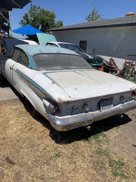

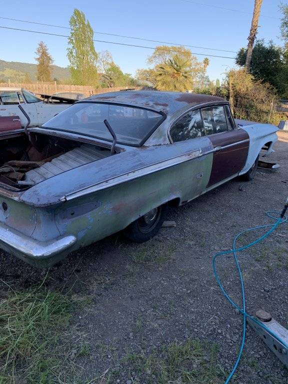

Here’s the 2 61s I want to do the coupe to coupe roof structure to.
Splices on Pilar’s is the plan.

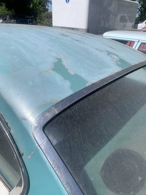

If you have good doors from the hardtop it shouldn't be that difficult. I swapped a roof on my son's 74 Barracuda. We were not changing the style like you are, but it enabled us to get rid of a rusty roof and put on a nice solid one. The biggest thing is making sure the measurements are all correct. I'm sure yours will be nice when it's done.
Could you patch that roof? with the good sections? That seems easier than doing the whole roof, unless every edge needs swapped.

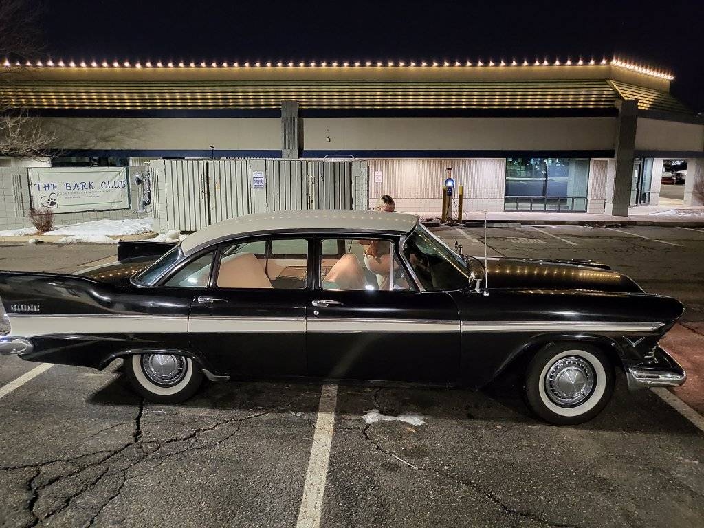

I'm new here. So Hi! I would say, determine how much it is worth to YOU and your intended useage, and then take it from there. A few years ago, I paid $18k for a near original '57, 4 door Belvedere. The only custom additions were new seats, front disc brake conversion, and new exhaust. I recognize that this is a bit much, but the seller was literally in my neighborhood, so paying a convenience price was worth it to me...also this was the height of all used car values being a bit inflated...so there's that. I didnt want a project (I already have too many), I wanted a daily driver. It had zero rust, full undercoat intact, original paint, all door gaps still perfect, all the doors closed like vaults, etc. It is now, in fact my daily driver, kid carpooler, grocery getter, and road trip vehicle. Everything I have done to it has really been to make it more usable as a daily as I encountered wants/needs: I added power steering, power brakes, duel brake master cylinder, fully gone through the suspension and replaced every bushing, four 3-point seatbelts, two 2 point seatbelts, updated headlights and taillights, electric window washer pump, etc.
Even with the premium I paid, after digging in and making the mods I have, I dont regret the initial spend for a minute due to how mind-blowingly unmolested and original this car has been over the decades. I have been extremely happy with how unbelievably usable it is as a family daily driver....even by today's standards, I feel like it offers more convenience than most modern cars....Plus life is too short to drive something boring right?
