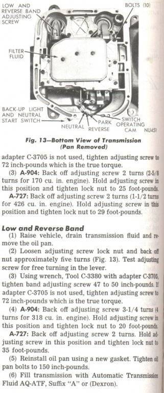

Have a 1962 cry newport. Tranny started sliding some after sitting all winter. I put it on the rack pulled pan and noticed rear band locking nut had backed off. Tranny # 1942275 007653 on left by drain pan. Looking at u tube get different opinions on adjusting front and rear band. After turning adjustment to tighten it to 72 inches back off 2 turns, 2 and 1/2 turns for rear and front. One guy said 3 turns ? Any body know ?
Here you go.
Kevin
TwoStick, thanks for the info , it was the exact info I needed. Shifts great after adjustment.
Pony1
Ah the factory service manual, can't say enough about it.
