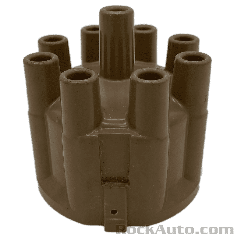

I know you're the distributor guy, but aren't the cast-iron distributors different?
My 65 413's dual-point takes a different cap like this one. I presumed it to be the correct/original item.
I tried a later 'standard' cap and it does not fit, the clocking tab on the dizzy does not fit the notch on the later cap.
Thats the prestolite style. The others have a notch in them for a tab on the vac advance to fit into.
But that's what I'm saying, there's overlap of the Prestolite and Chrysler caps in the 62-78 period.
It is unlikely a store would hand you the wrong cap for most folks, but when they inevitably ask the OP for the year of car, 1961 might cause that to happen.
Yes it is a crap shoot at te parts store looking it up. Early 6 cyln caps there are two. No idea why.
all 62-78 points/electronic cap and rotor fits. Make sure when you get the rotor it slides on the shaft if it is tight, you got a newer one. Lot of that going on. That is a Mopar electronic dist 72 and up uses a ECU also.

The caps are all the same till 62-78 except dual points. and some canadian ones

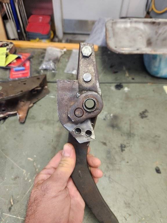

The brake pedal assembly, as removed- pedal had been twisted for more floor clearance, and it had a ratio of about 7.3 to 1…… Not good with my setup… I don’t have a pic yet of the pedal after I modified it, but will get one. Ratio is around 5 to 1 now and I straightened the pedal pad out- the brake system is working fabulously- plenty of travel available and brake effort feels just right. I’ll get a pic of the new pedal for next post.

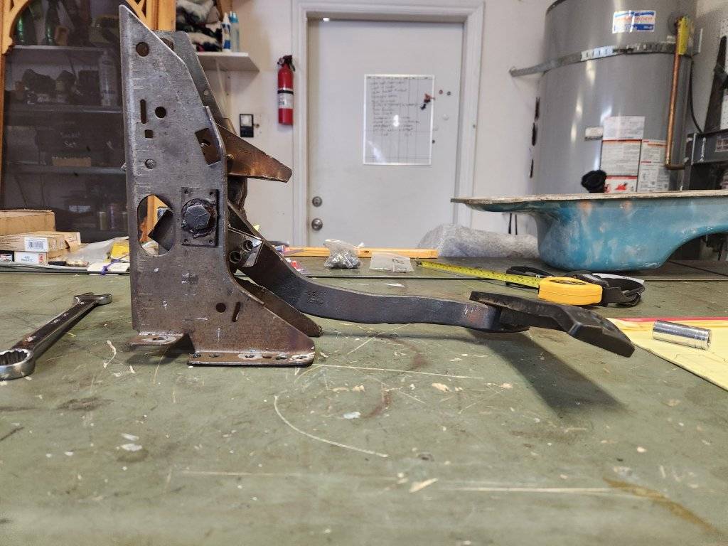

Ugh- this what I pulled out of the car- this pedal was a real mess and it went all the way to the floor before the brakes were engaging fully…I wonder how long it was driven like this?

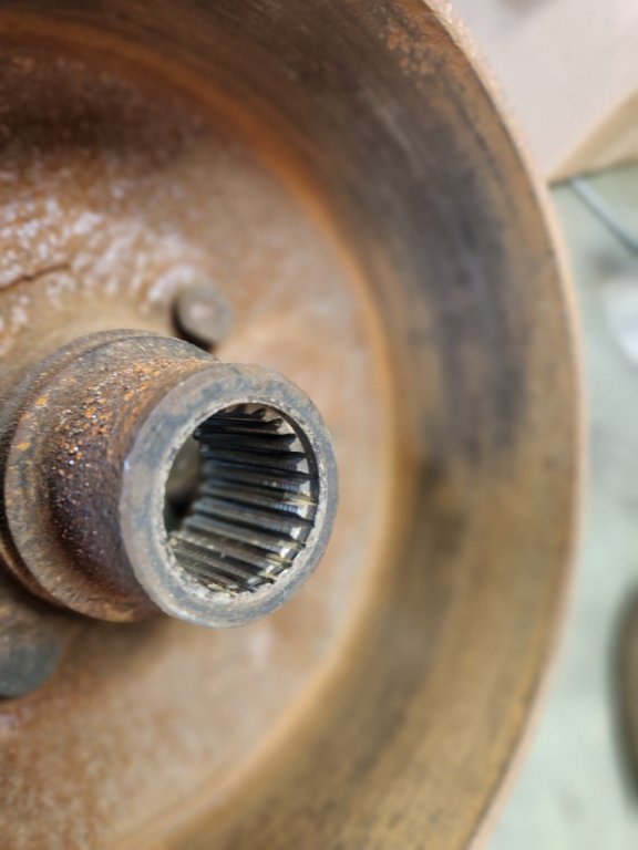

Lastly, I’ll post later about my parking brake battles- had one parking drum turned and they ruined it. Found another, but am not going to let it out of my hands until I find someone who knows what they are doing and has done one of these before…
Has anyone found a machine shop who could true one of these with their equipment?
No reason to turn or true up a parking brake drum.
Hit the rust with some emery cloth and call it good.
Surface rust will occur on it as you know it does not act as a brake drum.
Thanks…I was guessing that a little roughness might work in my favor as far as getting more friction.

A little roughness won't hurt the parking brake function.
I mistakenly thought the reason you wanted the drum turned was to clean up the rust.
