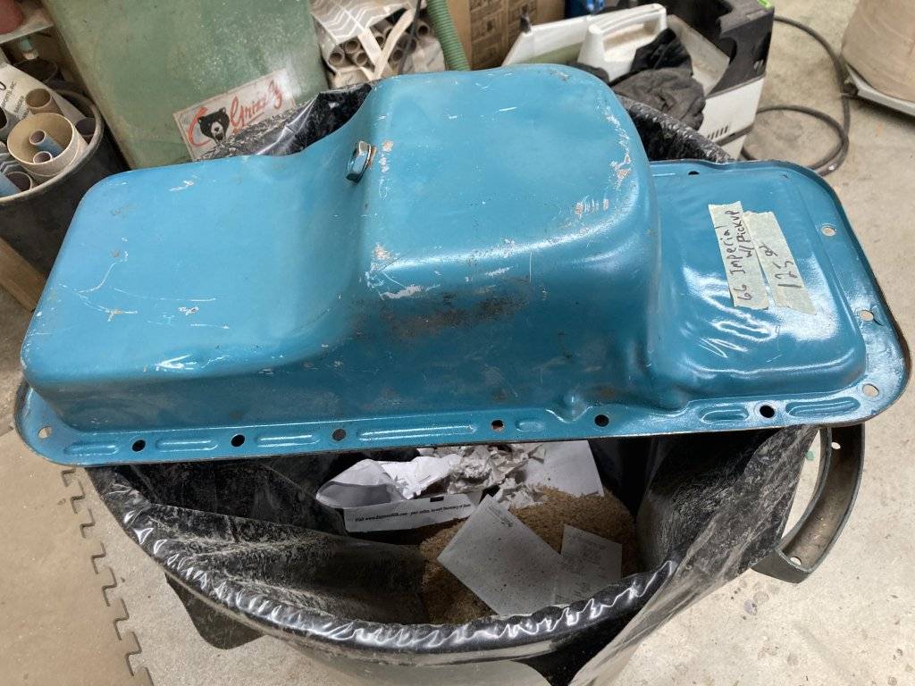

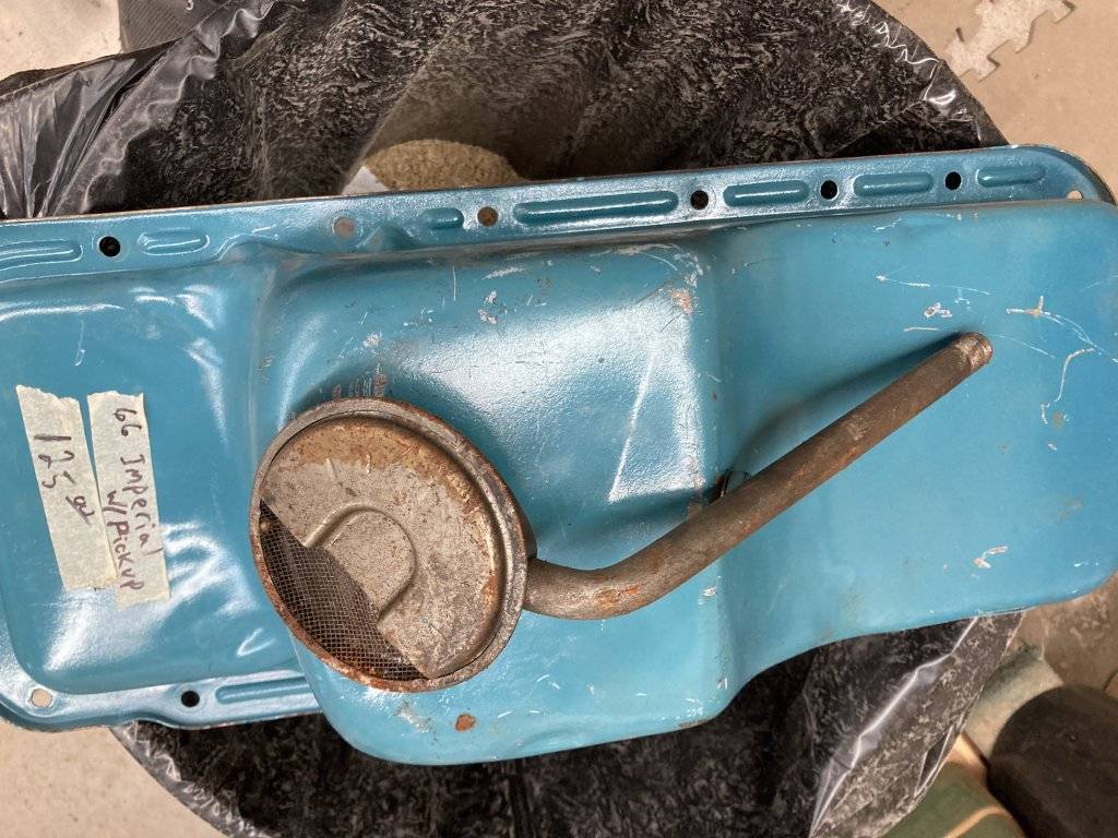

Not all oil pans have numbers stamped into them.

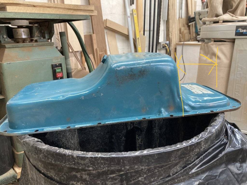

I think this is the same as yours. It measures about 5.5” deep at the deepest point by the drain plug.
I can get more measurements off of it if needed and it is available for sale.
I think the pick up goes with it. Both came with a ‘66 Imperial parts car that did not have an engine or trans when I got it.

Hi detmatt,
Here’s the pic of the dimension I need. Thank you!

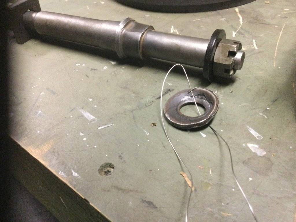

Please pull those spindle bearing adapters off and inspect their ID, and the OD of the mating area on the spindle journal, to see if any wear.
IMO those bearing adapters are a poor method to make a disc brake retrofit, as they create an additional interface surface that is never used in an OEM design.
They would need to be super-precisely machined on hte ID and OD (on the order .005 or less?). Not easy to do on such a thin-wall, multi-diameter item.
If those adapters have any movement vs the spindles (like ratcheting slightly with every brake application) they could be wearing.
If they are press-fit or Lock-Tited, perhaps it's OK.
But if it's metal on metal with a slipfit (like the ID of a bearing race) and the components don't have the right hardnesses, it could be ugly.
I've mentioned this in various forums over the last 20 years, and have never gotten a response from anyone that defended (or could explain) the engineering and/or installation of these adapters.
As you've gotten a car that had the kit installed, you can provide some valuable info.

Regarding the spindle adapters, I agree that there is cause for concern- I have used this design before in other kits- sometimes they performed flawlessly and sometimes they didnt…..the last time I installed a set from CPP on a ‘50 Chevy, they were not a very close tolerance fit and I was left using the Loctite bearing retainer product to fill the margin. It is still in service, but I pull the wheels every 10k miles or so to check them. So far, so good. I have also seen other cars with adapters that have rotated- not good.
The adapters on my spindles have apparently been on there for about ten years- they have not moved/rotated/cracked/scored/shown any signs of any kind of wear, and they still look brand new. Based upon my inspection, I am going to leave them alone. I presume the reason that these are performing as intended is because this particular kit had good tolerances and good quality control. So, I will keep these.

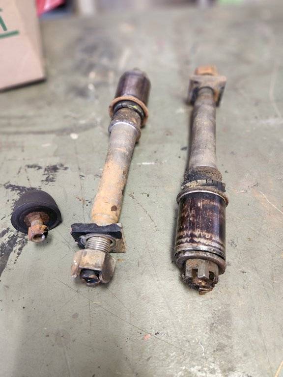

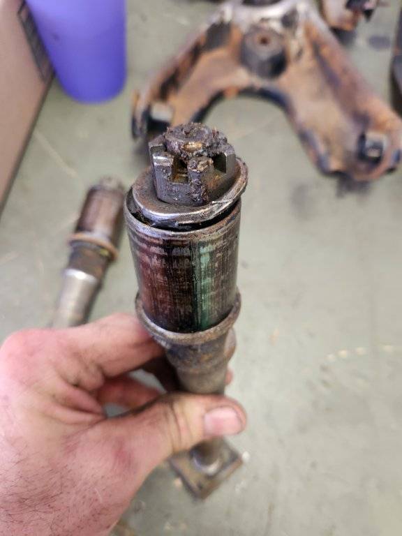

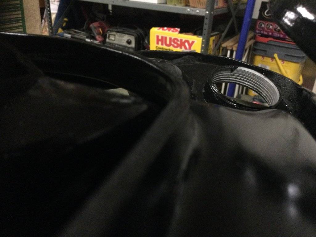

This is my first time installing screw-in ball joints. Removal was impossible without the special socket, cleaning the exposed threads, soaking in penetrant and then using an impact driver.
Question:
Anyone have any advice/tips for installing the new ones? I was wondering whether it would be a good idea to coat the threads with Loctite bearing retainer before installation- the threads in the arms appear a little bit “flattened”, and I assume that this is somewhat normal?
The used torsion bar bolts & pivots cleaned up very nicely, so that is ready to go. Had to find some new heavy duty washers (McMaster Carr) for the lower arm shaft bushing nuts as mine were pretty messed up (curled). High strength washers I ordered fit perfectly.
The "somewhat flattened" threads are probably intentional, making them "prevailing torque" rather than not. Chevrolet did that on some years of exhaust manifold to exhaust pipe studs/nuts. For some reason, it seemed they varied from normal thread depths using prevailing torque lock nuts to studs with flattened threads and normal nuts. Seemed that every time one of our techs removed an exhaust manifold, we always sold them 2 studs/nuts per manifold in the 1990s.

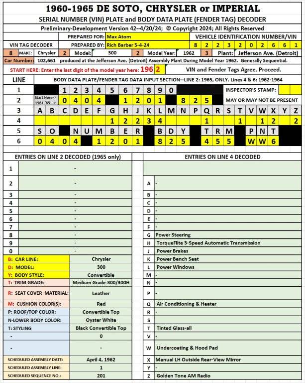

In your "spare" time, I would appreciate pix of Fender and VIN tags for your '61 NP. I'm expanding my decoder to '60 & '61 Chryslers and need more examples. Newport data is helpful as all options are shown. The same request is made to other owners of '60-'61 Chryslers, DeSoto's or Imperials.

Those BJ threads look fairly normal to me. Some guys put a few tackwelds between BJ and control arm, but I've never seen the need for it on any of my stuff.
I’ll get this for you this weekend

Interesting about some guys tacking the ball joints in- I was standing there looking at them wondering what I would do if they didn’t install securely, and tack welds looked like a viable option, although no fun for the next guy to deal with!

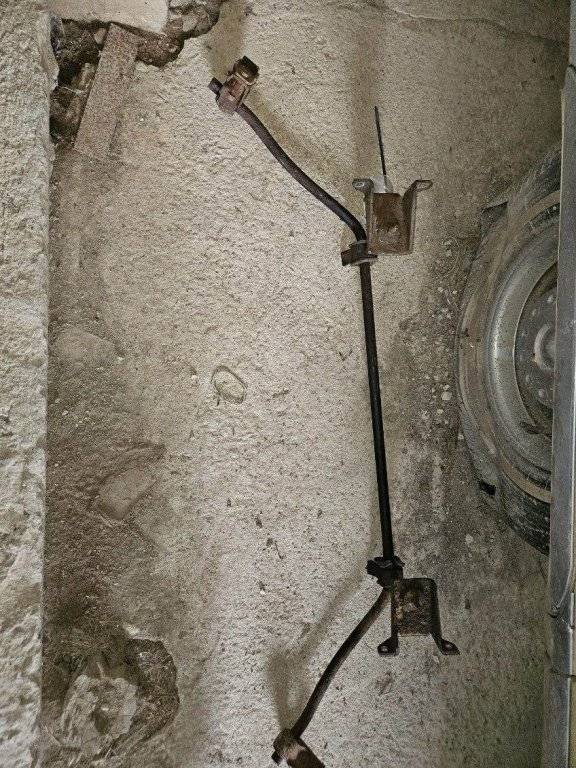

Here’s two pics of a ‘61 Newport sway bar I was/am considering that comes with all brackets and linkages…
That is roughly the shape of a C-body swaybar, IMO you should grab that while it's available.
Then later you could see how it measures up to a C-body bar, for spread-and-reach of the ends
C-bodies front bars came in 7/8" and 15/16" diameters.

The one pictured is supposedly 3/4" dia... but that might be incorrect. Thanks for the info.

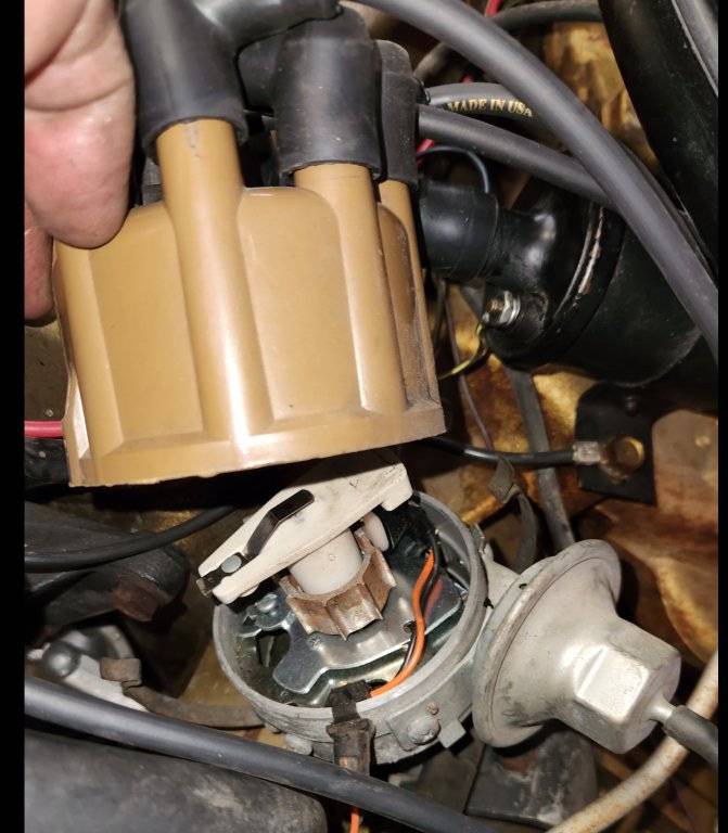

I’m trying to identify the distributor- it looks to have a magnetic trigger, so not from 1961. I’d like to buy a new cap, but haven’t a clue which Chrysler model and year to use for distributor replacement parts…
PM sent with vin

Distributor cap and rotor can be from any V8 from perhaps 1966-1989 that have a Chrysler distributor, which is aluminum and has square pockets in the neck.
65-older tend to have a cast-iron Prestolite, which takes a different cap/rotor.
To bypass the possible exceptions, just order for a 1975 V8 car of your choice. (they'll ask you if it has air conditioning, I'm sure :rolleyes:)
